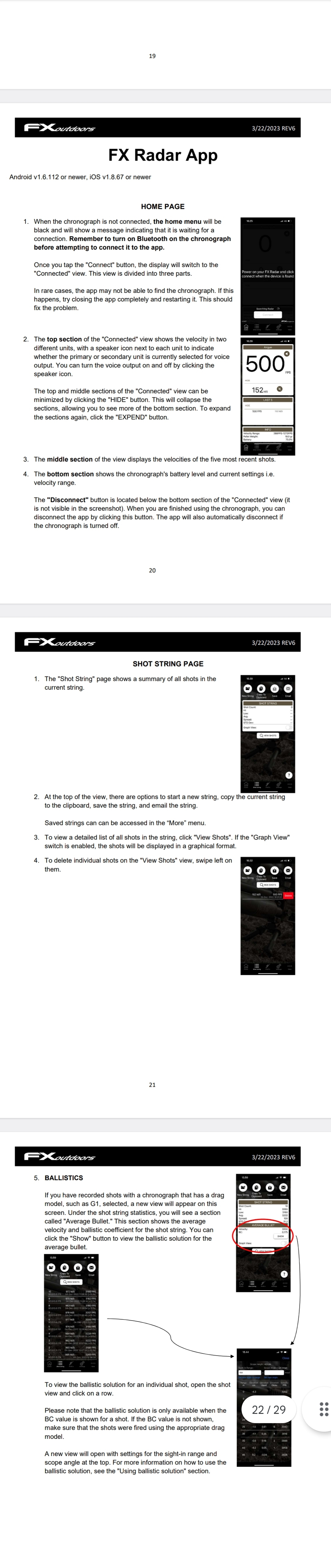

  • Access the latest manual at this link. It includes instructions for the FX Radar app, a feature not found in the printed manual.
  • The latest Android and iOS apps support FXTBC.
  • The release of the ballistic data export feature is planned for August.
  • As observed by some users, the reported BC values appear high. This is a result of the chronograph calculating "Simple BC". Further explanation can be found in the manual. A conversion tool for the app to calculate BC using weather information is currently under development.
