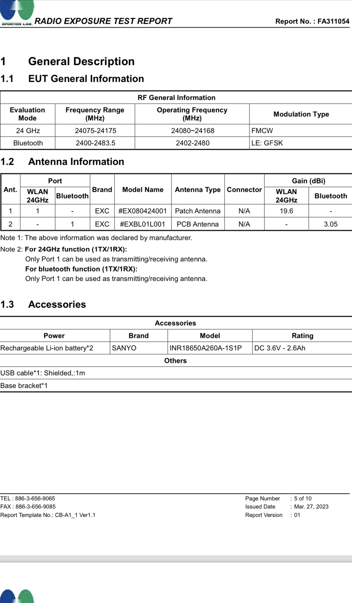

The question remains, is it accurate in its readings? The readout is no more than ± one digit with the Labradar. They don't play well together, but ten shot averages fit the ± one digit. Comparing the TBC to the small one offered by FX, is an act of futility due to the acoustic triggering method. Incidentally, the Labradar uses an acoustic trigger, so unless you activate the radar before taking the shot, there will be a larger variation in velocities measured between the two units.
