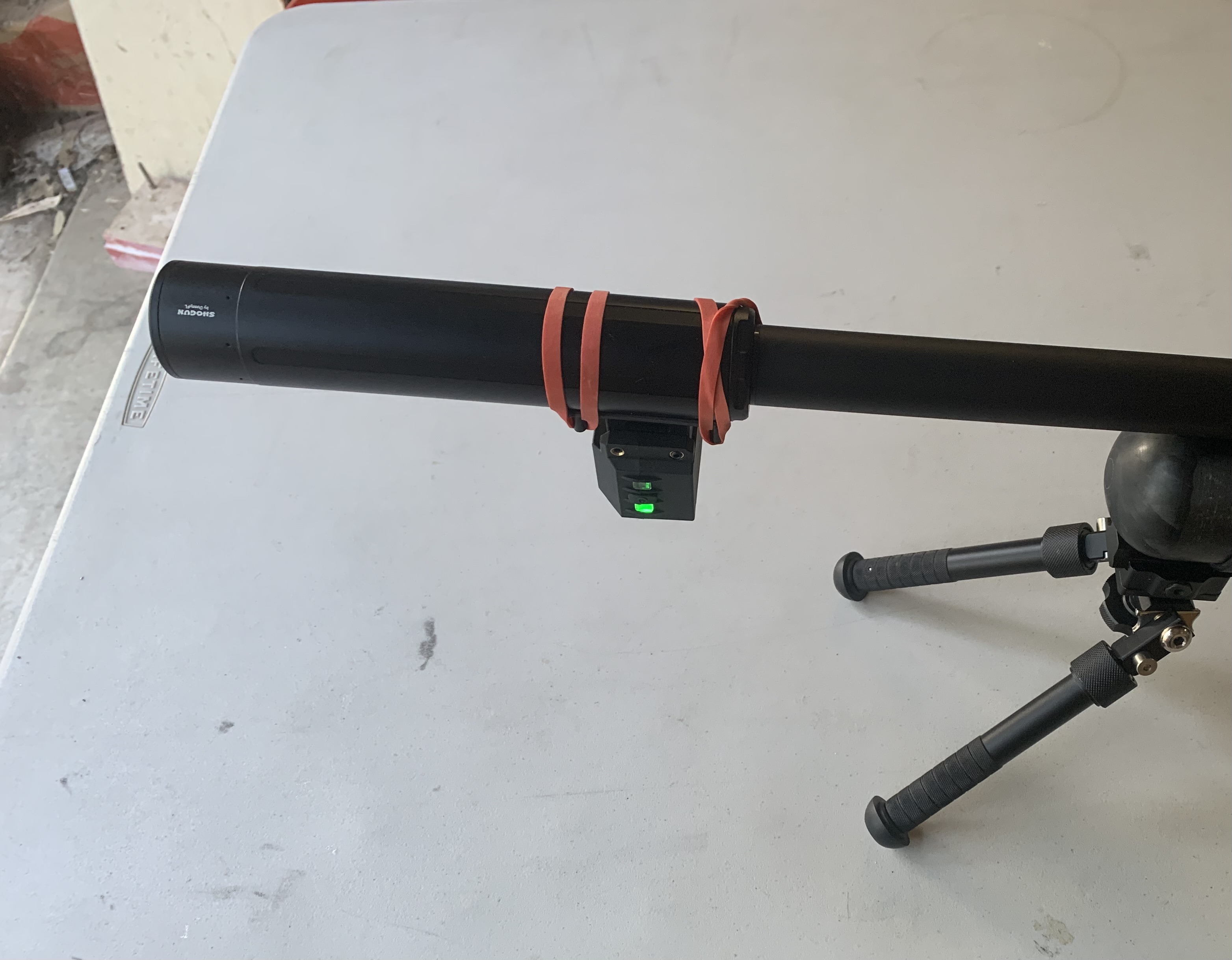

I recently bought one of the V2’s and initially thought I had one of the “turds”. I was lucky to get a reading once every 20 shots. Tried it in a number of different locations on the gun, and same bad results. Went back to my trusty old Caldwell unit and figured the excitement of “New and Improved” had cost me $250.
Gave it a revisit this morning and after remembering an old comment about the V1 liking to be hung upside down, I figured I’d give that a try. Bingo! Using the rubber-band mount, I hung it from the inner end of my DonnyFL Shogun. It didn’t just improve a little bit … it gave a reading for EVERY damn shot!
Long story short, don’t give up until you’ve tried all the possibilities … I eventually found the sweet spot for my Impact.
Attached is a photo of the final location that worked for me.
