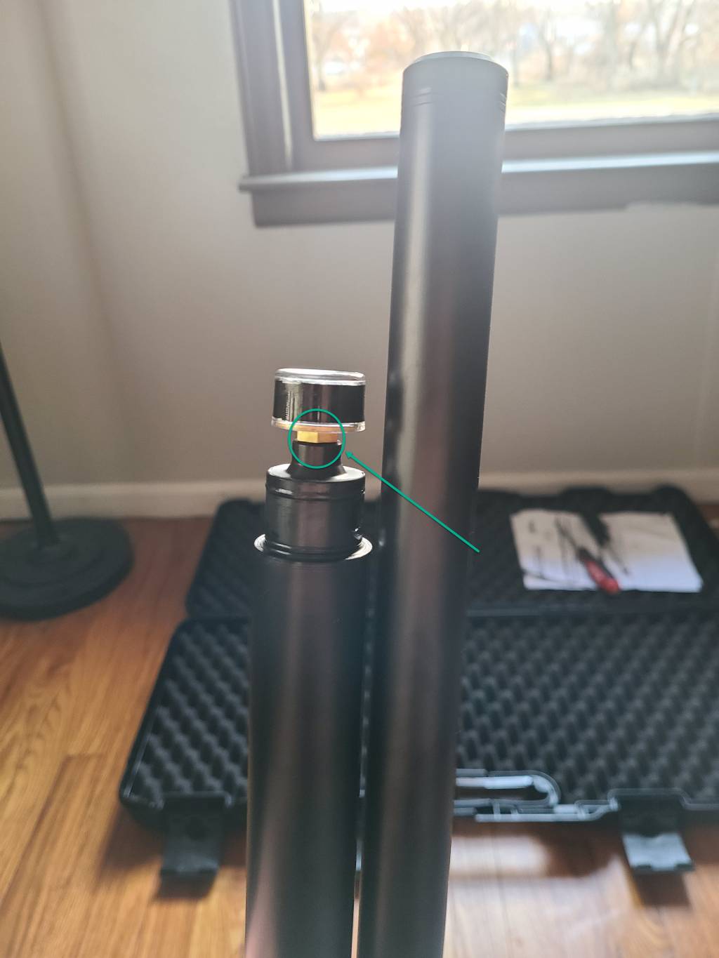

can you degas the tube , hence check if indeed air is in the cylinder ? ( You can use a slim wrench on front of the gastube when you remove the cap you see the bolt you can turn loose slowly and gas will start escaping )
also can you decock the gun when you have cocked it by puuling the cocking lever backwards again and whilst holding the cocking lever backwards pull the trigger and simoultaniuosly release the cock lever slowly ?
@ladwict - Are you referring to the brass bolt underneath the air cylinder manometer (see pic below)? If so, loosening or unscrewing it slightly is how you degas the cylinder then? I was wondering how to do that...for when its in storage and not being used. And there is no danger to doing this slowly? Just don't wanna explode my face haha.
and yes...I can uncock the gun by doing as you described.
