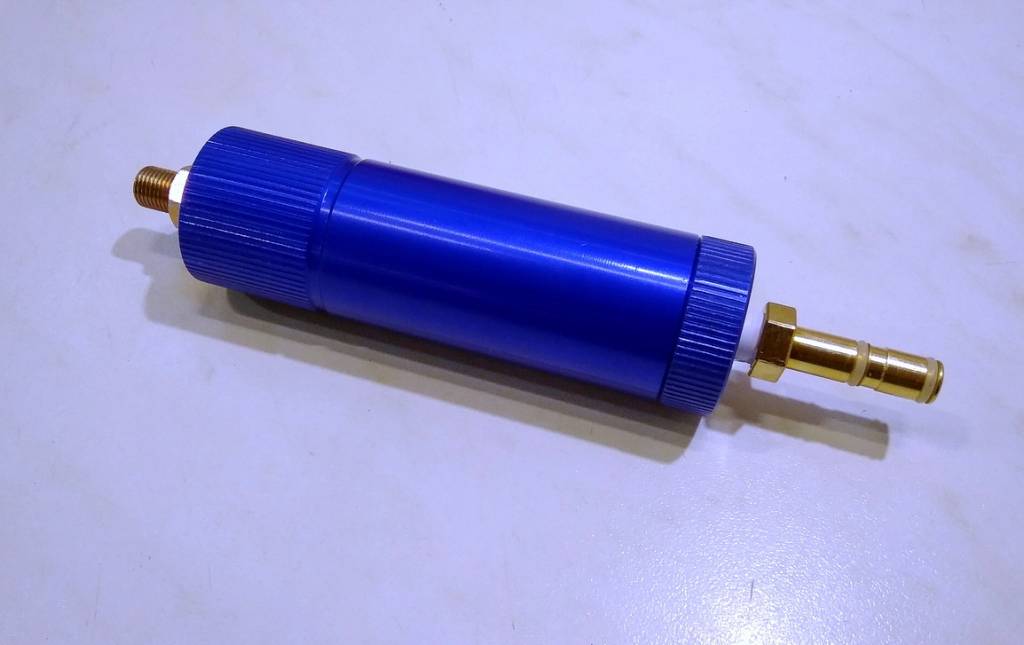

I have connected the supplied filter to the compressor and the FX fill probe at the end.
Both ends inside the threads have a small white delrin washer. When I connect it to
the Wildcat and try to charge it, the pressure does not increase and there is a leak
from the fill probe side. Maybe its the attachment of the fill probe to the filter because
the filter does not have a lot of threads inside. When I remove the probe and close the
hole of the filter the pressure goes up again. I have placed some teflon now around
the probe threads but I will try again tomorrow.
