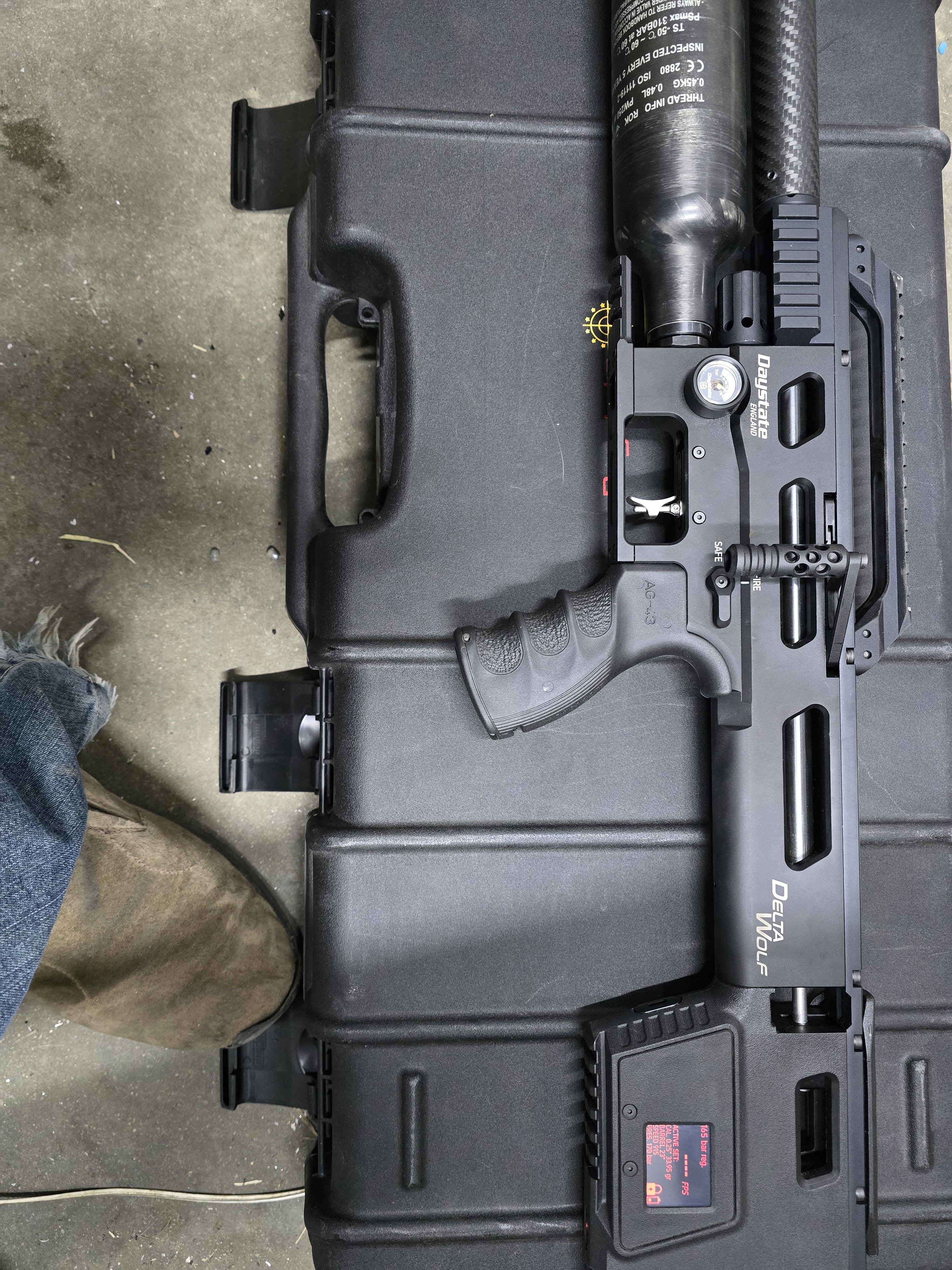

Latest addition has me thinking maybe I'll sell my drs just picked up the delta wolf from a friend is there a way to tell if it has the ultra valve or whatever the latest and greatest valve is it's probably 1 1/2 years old some where in there and a 25 cal

You might give AOA a call.
If you tell them the serial # they will probably be able to i.d. the gun's particulars for you.
And as a bonus, they may be able to tell you whether there is any warranty left on it
And register it with them in your name

Now they have introduced the latest improved Ultra Fast-Flow valve that provides 15% more energy, and the penultimate Ultra Fast-Flow valve began to be installed in March 2023. They have not yet stated whether it is compatible with these old models, but I think it is.
Daystate started in 2023, but as of this summer AOA didn’t have any new ones with it. Not sure how that happens. Don’t assume it is in it. AOA even said that if their site didn’t specifically say it, then it didn’t have it. Most I have seen on their site have not had it. You can call them and ask, but they will only know if it was built with it or if they put it in. They won’t know if someone else upgraded it. There is a Daystate website where you can check the serial number too. Someone recently reposted a thread with that site too.
I would say to look around here for people that have shared their .25 data and see what their reg setting was for their speed. Or take it out and look at it and find out if they look different.
I can check my notes for my .25 I had and get back to you with my speeds.

Well the reg is at 170 and it's pushing 34 gr at 910ish and it wasn't asking for more pressure so it doesn't seem to be struggling to hard to hit 905 is my target speed so it seems to be good
I just checked my notes and remembered I had the 22, so mine won’t be perfect to help. Judging by my .22 speeds though and thinking of other comparable guns I have in .25 and what it took to shoot 34s at just 905, I think 170 is high and is probably withOUT the Ultra Valve.
