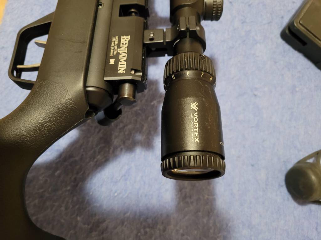

Wow... what a ton of information! My Crossfire does have an adjustable objective, but it is cheap... 200 green ones. I can't move on a scope just yet, but you have moved an optic upgrade to the top of my list... You could once get a LW barrel from Pryamid Air for about $100 more; and I did pull the shroud and stripper and counted the groves to be sure... 12! As I said, it's doing good at 50'. Almost one hole groups with Crossman Premier 10.5/4.5 ... some clover leafs, to be honest... I'll get the Huma or Hill and regulate it, a better scope... and we'll see...

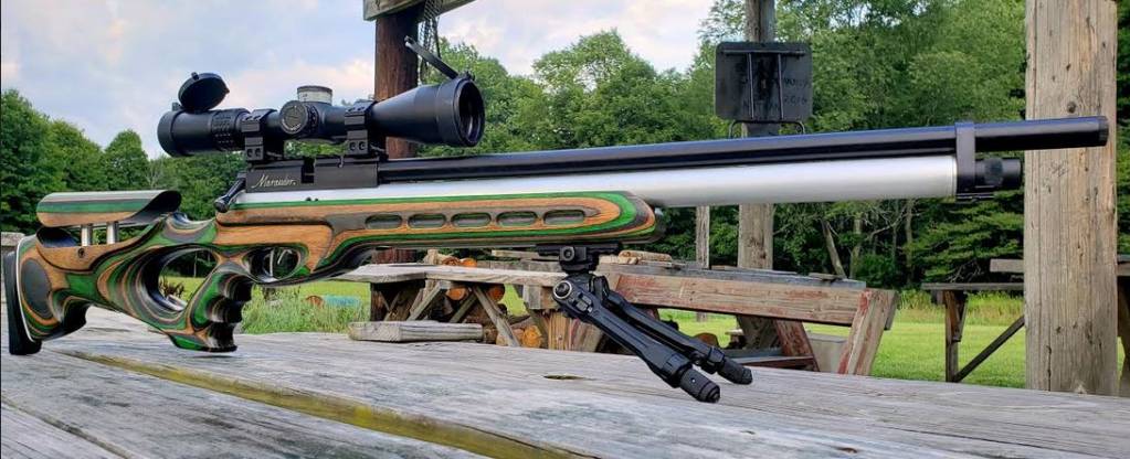

@cousinjenny - a photo from this past summer of my blinged out little .177 mrod gen2. ;) AA 10.3's - it's kinda stupid accurate. I used it just for kicks once last summer at one of my farm permissions and was picking off pigeons off of a silo @55-60 yards. I told a buddy / co-worker at work - "hey man - that little m-rod of mine was EE'ing . . . ! 😁 " ( "Exceeding Expectations" - it's a rating that one might get at annual performance reviews )
It's a LW barrel - thats what it shipped with / OEM. Custom aluminum air tube - *much* lighter than the OEM steel one. I do have a huma reg in it and thats one of the craftsmanvit stocks.

You are of, course, right.... I just drug it out of the safe and checked. I have no idea why I thought it was a 44. Part of my difficulty in benchrest is going to be my inexact mind... I am a retired school counselor and a current ski patrolman, and no engineer. I'm beginning to see an analytical mind is necessary in this game. Hope I can measure up... thank you...
Wow..... Beautiful...
