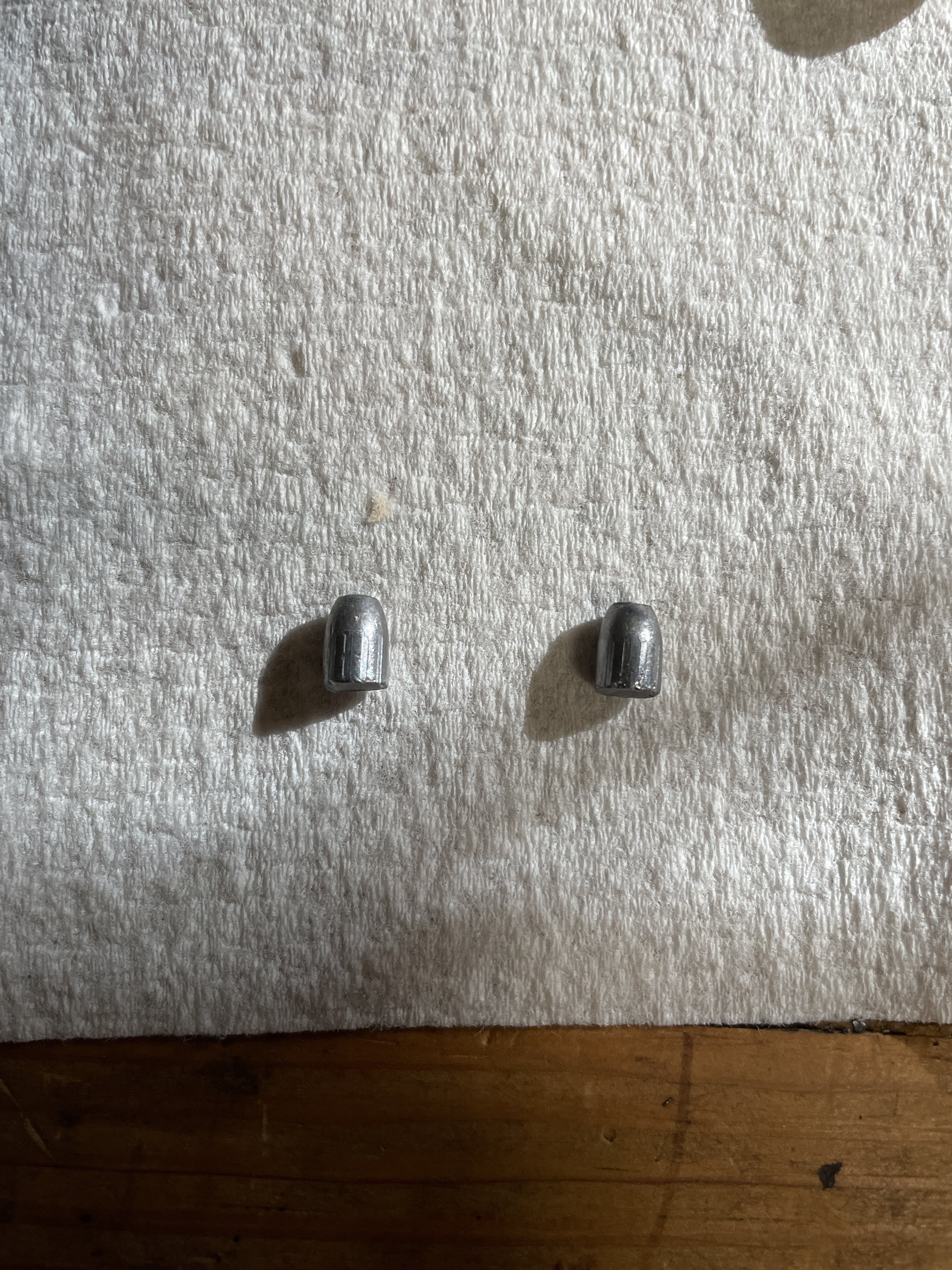

Here are a couple slugs I was able to find in my trap. You can definitely see the rifling on them.
