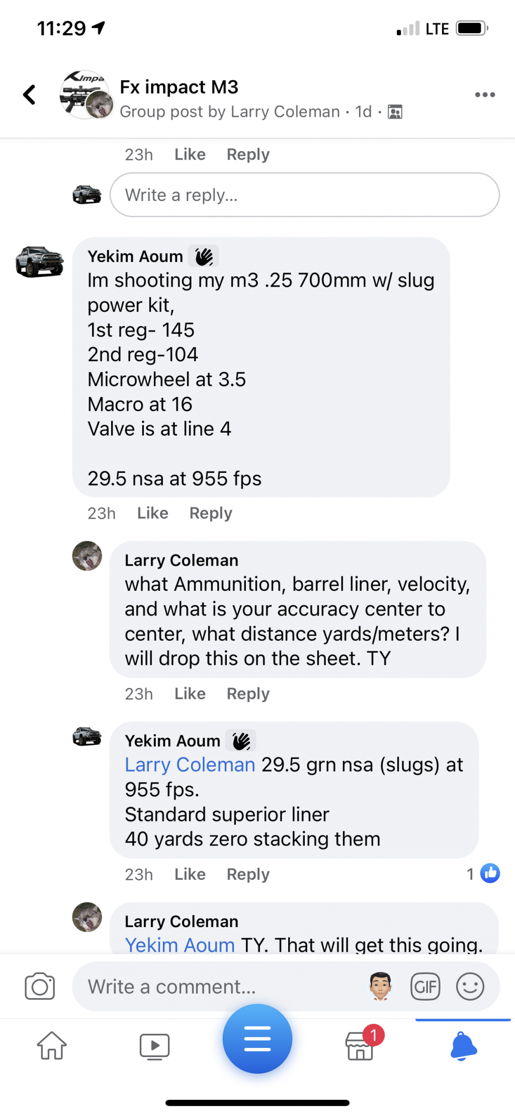

The factory settings for my M3 .25 700 are Reg 1 150, Reg 2 90, Front valve 4+ (about 4.5), Macro adjuster 16, Micro adjuster 2.5
Why would I want the front valve and macro adjuster maxed out? Would it be better to raise the second reg pressure and lower the macro and front valve settings to achieve the wanted muzzle velocity? I very well could be wrong in thinking this but if they are in the mid range of adjustment it would give me more room to adjust for trying different pellets or slugs down the road?
If I should bump up the second reg what pressure is recommended? What have others found is a good MV for these 28.24 gr pellets?
