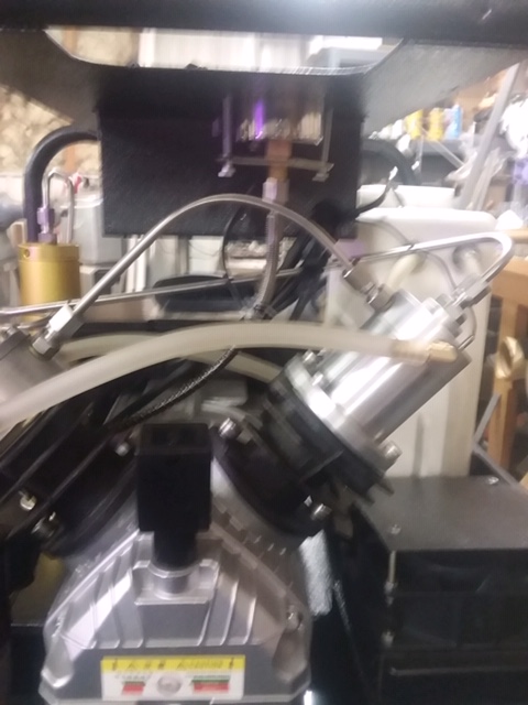

It’s a fitting off of the coolant lines heading to the compressor. If I remember right, the closest cooling line coming from the cooling fan to the first connection at the compressor head, if yours is a 90 degree fitting, let hatsan know yours hasn’t been upgraded. I’m pretty sure yours already is, as that recall was out around October of last year. But, if unsure, just email Hatsan thru a service form on their website. That’s the best way to get a response back. They may ask you to send them a pic of the area they ask for. With that part, they send you a $50 gift coupon for your troubles. I waited for a sale that hatsan had and scored big on pellets with that $50, lol.

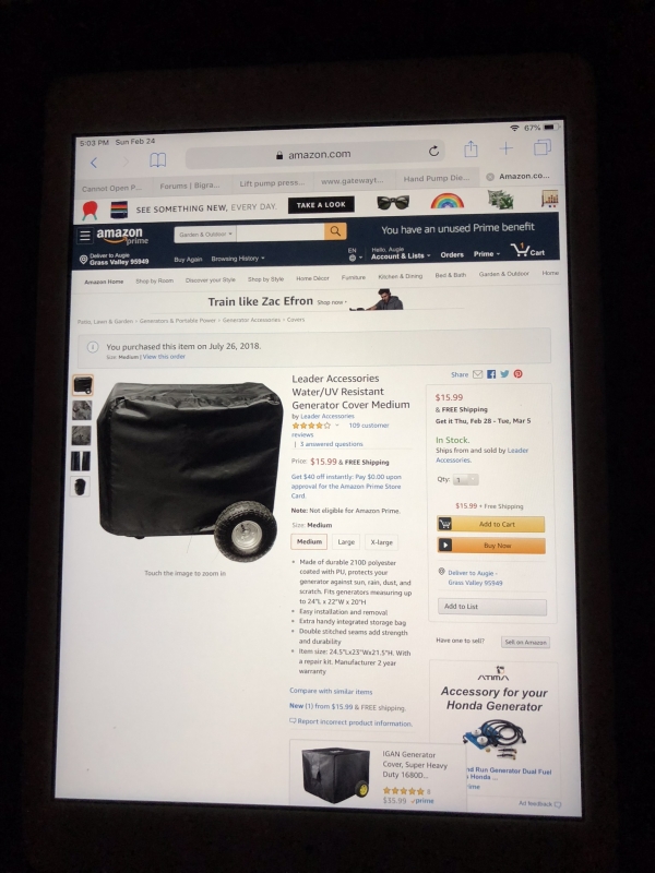

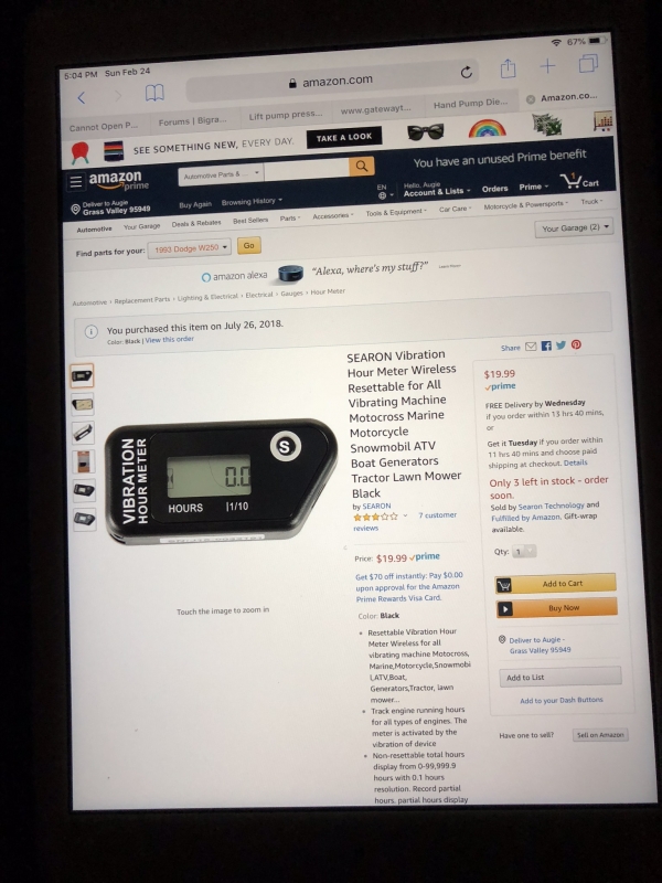

I know I’ve posted this before, but if you wanna keep that thing dust free, there’s a compressor cover I found on Amazon that fits it perfect, and at the same time I bought a vibration hour meter, to make tracking the hours use for maintenance a breeze. If you missed that tread where I posted it, let me know and I’ll be more than happy to re post.

I am using Air Venturi synthetic compressor oil, in the 16 oz squeeze bottle, which is convenient. I think the cover idea is a good one. I would appreciate that link, I also like the idea of the hour meter. Right now I have a little log book to keep track of the time. Until I get a cover I am going to store it in its original box to keep it dust free.

For my cover I'm using my GMG cover. Got a package deal on my grill and it came with a cover and a bag, but since I have an outdoor kitchen (covered deck) I don't need the grill cover. It looks cool and it's heavy duty.
Vibration meter amazon check. Received say day as compressor. Wires are bundled and away from heat sources. I've got some good anti-freeze but will upgrade though. I've got 3 quarts of Amsoil coming. (the wait is killing me). Like I said I searched all local sources. I'd hate to drive an hour and not be able to find any at the local major city.
Here's a photo of my piston heads. Does this look like the upgraded model.
Thanks in advance.

can you post a picture of what its supposed to look like after the cooling upgrade please?

Ha! I haven’t gotten around to replacing mine yet, lol. Contact Hatsan, thru a service form that you fill out on their hatsanusa.com website. They will guide you on what’s needed and how it’s suppose to end up.
Having listened to the Bigragu and his infinite wisdom I'll take a poke at the upgrade. Like he says, look at the first line from the coolant pump. Is it at a 90 or inline. The first lightnings had 90 degree fittings the later ones have in line fittings. I believe mine is the upgrade. (looking at your compressor from the fill end for the hydraulic fluid the piston head on the right should have a straight fitting on the back side. In the photo above it's on the opposite side of the 90 fitting on the right.)
I noticed in earlier video's this fitting was a 90.
