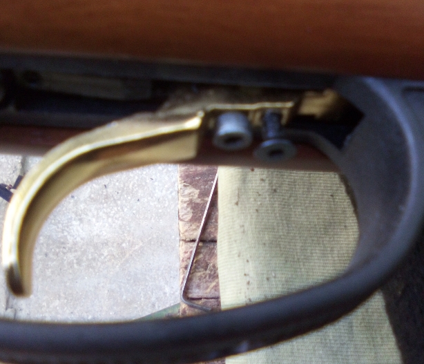

Just seems that one in my picture if you tried to bend or straighten it it just crack or snap in 2 . Maybe some pot metal looking stuff. I dont know but that's the feeling i get from its material.. now the 25 sc pistol aint bad vs the rifle on feel and pull direction. Its more a stamped steel.
Again, not talking about the Quattro although I've read any number of stories from owners who have had those Quattro triggers snap at the front 2 screws. It's just whatever cheap metal Hatsan made them out of then drilled 2 big holes for the adjustment screws and then plated them.

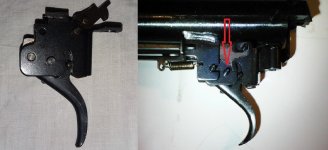

Giy on you tube does the striker trigger mod and seems at gta a guy had custom hatsan trigger . Where from dont know.
Use to be a Quattro Trigger Blade from Poland one could get. Pretty much like the AT44 Pump trigger blade.
IF Hatsan will sell you one? I'd give it a try.
Still have several Quattro Triggers here. Really need to finish dumping that stuff.
Reactions: Hateful McNasty
Welsh Willy in the UK, aka Woodfield-GCP, makes one for the Edge/Striker/1000x rifles, but he doesn't advertise them on his website. An email will usually get you an answer on whether he still makes them and how much he's asking for one.
The Charlie da Tuna GRT III also drops right in and works. Sadly, the blade itself is entirely too short to get your finger on:

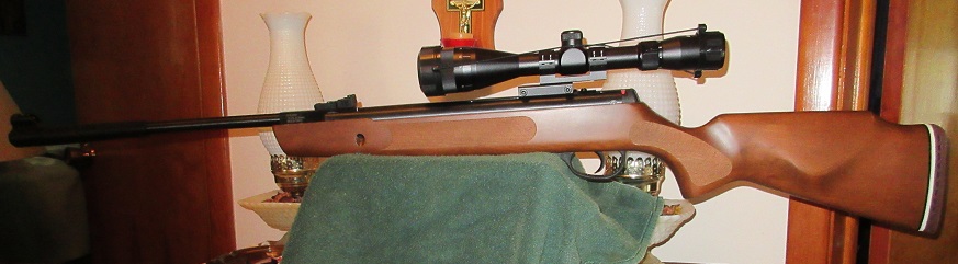

My Hatsan Striker 1000X in .25 cal. has arrived, is came last night so I didn't get a chance to take it for a test drive until today. It is now gone over and sighted in at 30 yards with the open sights, It really is a decent rifle. It packs a wallop and the fit and finish is to my eyes excellent. It doesn't have the quattro trigger but it has a smoother release than my 95. I honestly don't see how they can sell this gun and ship it half way across America for $124.99 plus tax. I'll know more as I use it but for now, I'm calling it a win.
