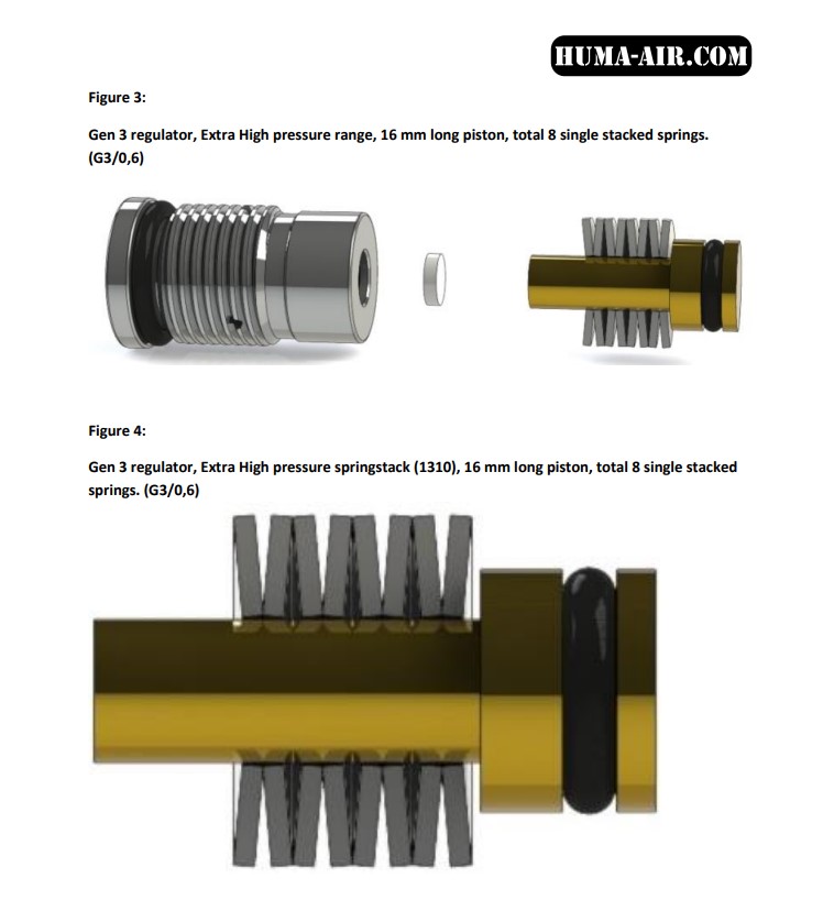

Hi guys, I have a problem with my new reg. I installed new huma air 2nd reg on my fx impact m3. I turned set screw all the way in, but when I screwed in the bottle second reg gauge went all the way to 150 bars (along with 2 other gauges). Isn't it supposed to be at zero when the set screw on the reg turned all the way in?
It should be at zero on the second there are different lengths of piston on the huma second reg one for higher pressure one for lower pressure my huma that I tried came with directions to change the stack accordingly to how high you want to adjust it
Stock stack I believe is like this ()()()()()(
I compared the piston length on huma and it's exactly the same as original from FX. I got extra hight pressure huma, the spring stack on those is: )()()()(
Interesting, what is the thickness of the springs? THAT determines the top pressure, thicker means more pressure, at least on the AMP regs. Ok HUMA is using a flat piece between the adjuster and the piston in-place of the two convex surfaces, the length of the piston also plays a role in it, too long reduced pressure, too short, higher pressure. Of course I could just be blowing smoke here,.
Not sure what's the spring thickness. I don't think thickness is an issue here, tons of people installing exactly the same reg on their M3 without any problems.
I've tried to reassemble it couple times, nothing works. This just drives me nuts, I have no idea what to do.
