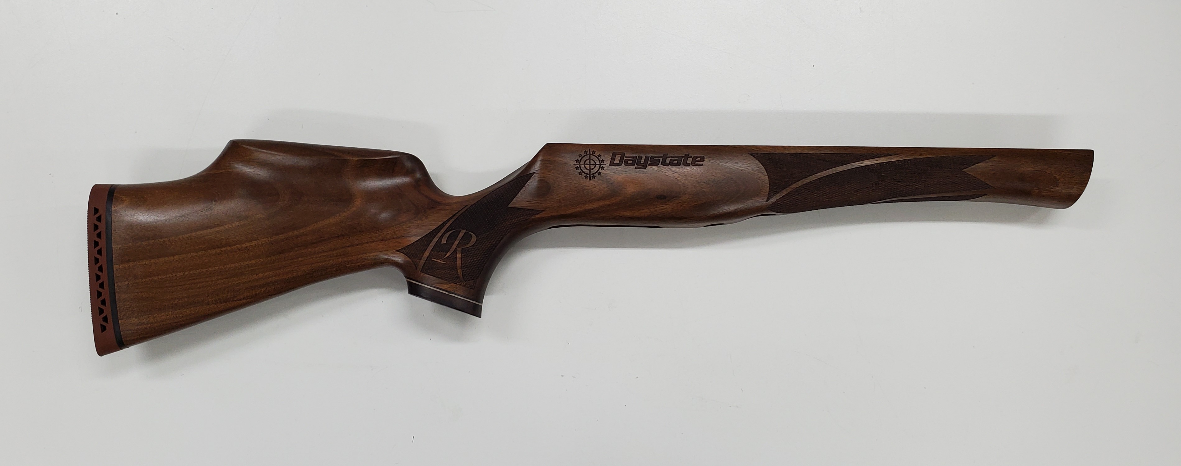

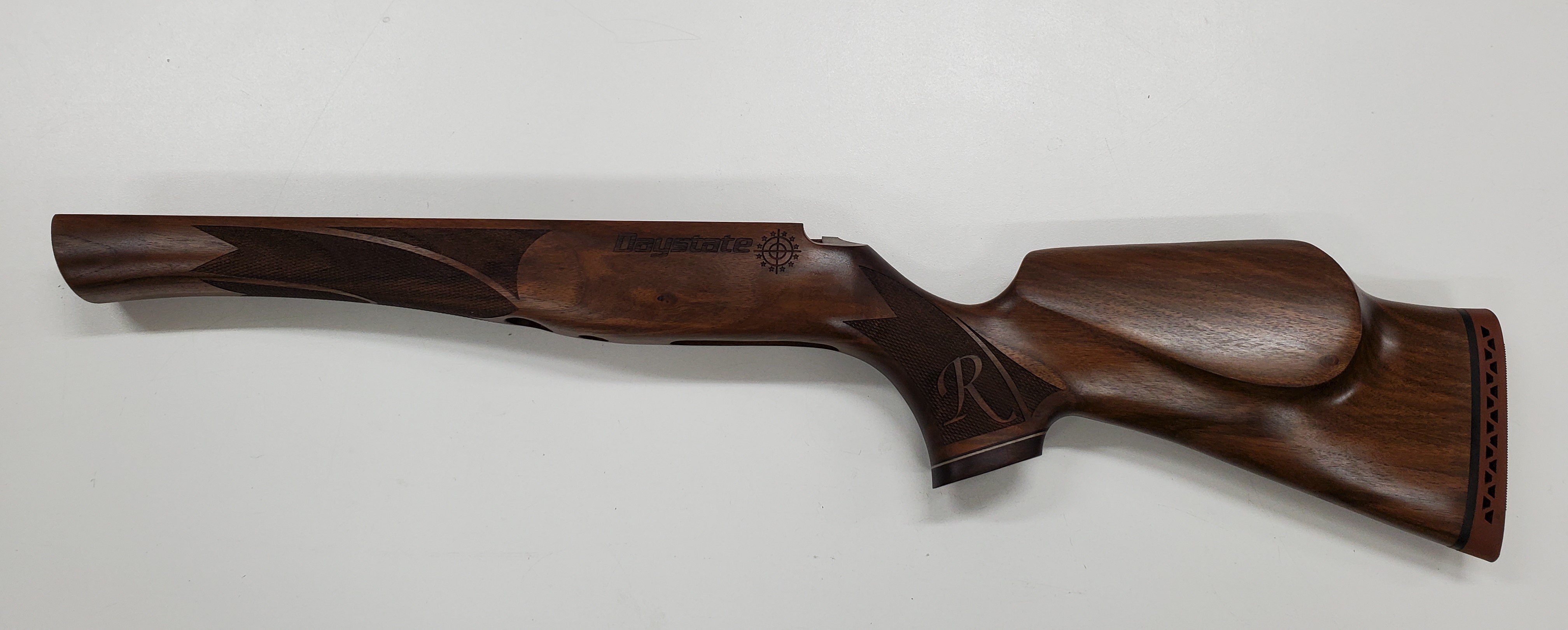

While the empty stock was starring at me from across my shop, I decided to "pretty" it up a little. It was nice looking, but I thought I could improve it. After a couple of coats of verrrry thin Boiled Linseed Oil, it now looks even better than I imagined it would!
Did you sand any of the original finish off to get the oil down to the wood or just apply over the stock finish? I too have a .177 revere and man are they smooth. Mine is unregged and sends 10.3s at 860-870 from 200bar down to 175bar for about 60 shots. Finally got to shoot it at distance on monday and what a tack driver. 50 yards was putting those little pellets in a 1/4" group with a 5x Imersive Optic prism. Mine developed a small leak and it turned out to be on the balve seat as it is just a peice of plastic the metal valve pin seats against. Cleaned up the edges and all was right with the world again.

I didn't do anything to the original stock. I just took a few drops of Boiled Linseed Oil and rubbed it into the stock with my fingers. I did not get any oil in the etching. That would have made it too dark for my taste. After a few minutes, I took a soft cotton cloth and gently wiped the excess oil off. I let it dry for a couple of days then repeated the process. It darkened the wood and brought out the grain contrast along with adding some protection to the stock. It's about the simplest stock mod you can make and virtually foolproof.
