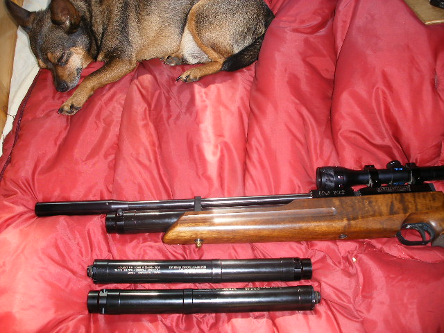

This one is 23 or 24 years old" the only thing iv done is replace the O-rings in the fill tubes and the little O-ring thats on the end of the tube when ya unscrew. Even with the short barrel im getting 825 with 22cal. 15gr. pellet.
