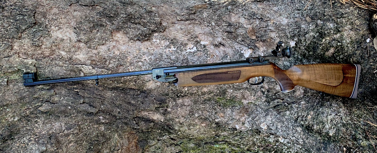

If you look around on eBay or similar you can find a vintage Anschutz or Weihrauch diopter. Be careful and make sure to get an 11mm. All Anschutz are 11mm. Weihrauch made their early ones in 13mm. Afterwards 11mm. So any Anschutz will work. This is my 35 with an Anschutz diopter but I have since replaced it with a 11mm Weihrauch. I think you would really enjoy your new 35 with a diopter.

If you look around on eBay or similar you can find a vintage Anschutz or Weihrauch diopter. Be careful and make sure to get an 11mm. All Anschutz are 11mm. Weihrauch made their early ones in 13mm. Afterwards 11mm. So any Anschutz will work. This is my 35 with an Anschutz diopter but I have since replaced it with a 11mm Weihrauch. I think you would really enjoy your new 35 with a diopter. View attachment 278708View attachment 278709

I really like your stock! Mine is great, but very dark heart wood and hard to see detail from a distance. Yours has more flame in the butt stock. Very nice

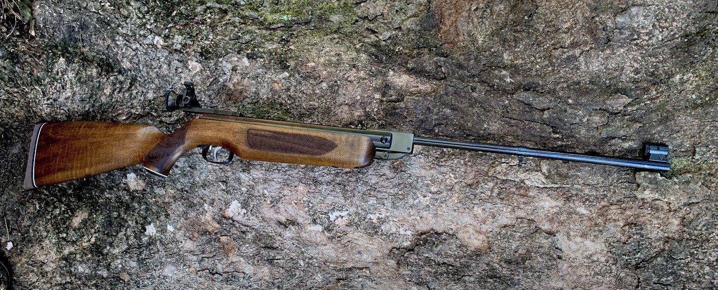

I will see how it goes today with a little steam. I have a nice big soldering iron and was going to put a wet cotton cloth over the dent and heat it up with the iron. How would you attempt to steam it?
The good thing is it is just a dent, not a scratch or gouge.
Not on an airgun, but some 100 year old military rifles. I fold a paper towel, get it almost dripping wet, place over dent( or sometimes gouges), I then took an old steam iron my wife had discarded for anewer one, filled it with water and set on high steam and applied. Rewet the paper towel if needed and steam heavily. Most of the time a dent like that will come completely out, you may need a bit of refinshing, but I would take my chances on that stock as it looks so good.

Yeah was going to suggest you steam out with a steam iron over a cloth …always worked for me provided wood was compressed, but not missing material.

Well done with your steam job..
