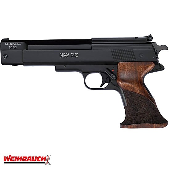

I like the iron sights on my HW75 but my eyes are not what they used to be. I tried shooting at ten meters today with iron sights and I suck. Three inch splatterburst targets and I needed every bit of them.
I purchased a set of these for the thirteen millimeter rail that the HW45 and HW75 share from what I have found. I plan on mounting a reflex dot. Still looking, maybe a Holosun or a Vector Optics.
