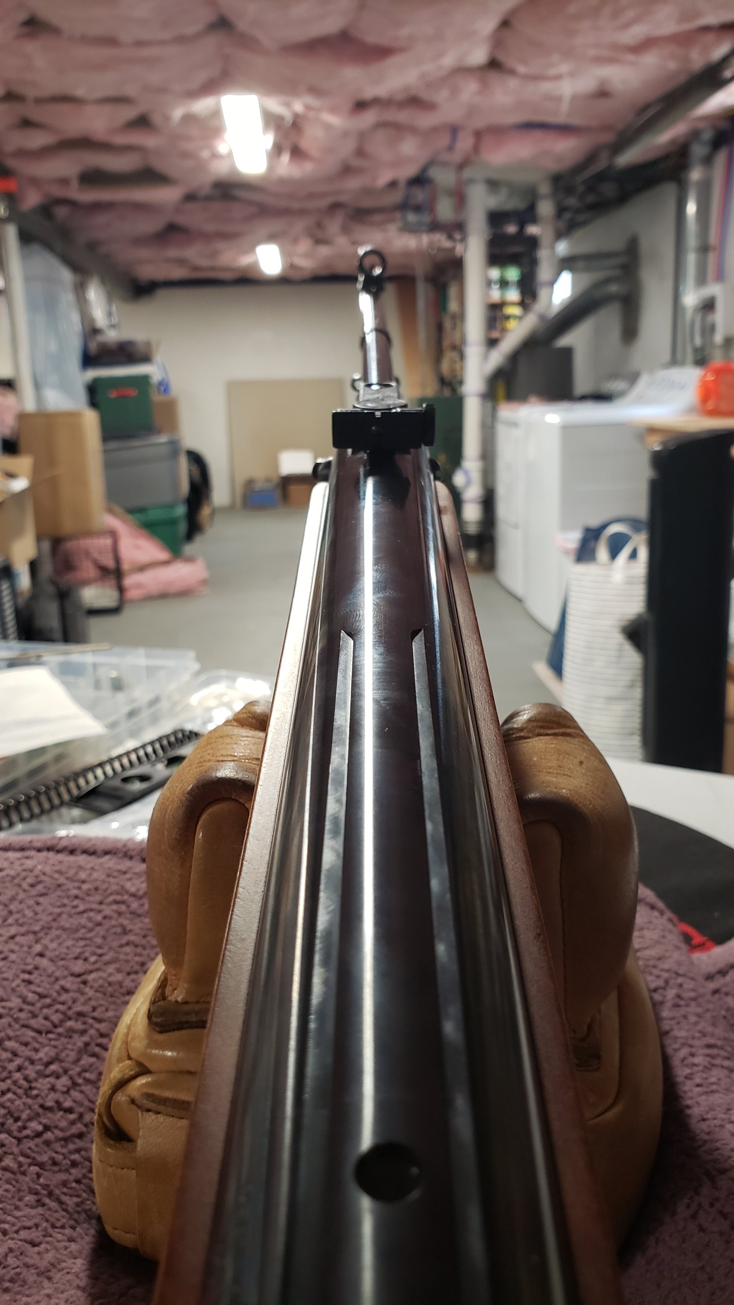

Barrel could be bent. With the sight adjusted left does the center of the Buckhorn align with the the center of the dovetails? If it is maybe it something with the sights. Is the end that the front sight mounts to plum? If it was crooked it would cant the front sight and mess things up. If everything looks right the barrels likely bent or there's a wicked burr on the crown.

Your up late tonight! The buckhorn is not centered on the dovetail. I can't see the front sight out of plumb. I will see if I can check that out. I put a scope on it and need to check it as well. I have on old Leupold VXII. You know, this is the third Weihrauch I have purchased and I had to bend the barrels on the first two. Can you bend a underlever barrel?

Congratulations on the new rifle! It is a great rifle and really easy shoot all day. The back of the HW77 is a screw on cap. It has to align perfectly from the factory to get the dovetails lined up. Mine was off by a little bit and the way they got the rear sight on the rifle was a big hammer! My factory rear sight was way off as a result. Check the dovetail joints for misalignment.

Interesting, I cleaned the barrel before I shot it and it was filthy. I noticed it was slightly tighter at the muzzle when I pulled a patch thru. I'll clean it again.
Dovetail is aligned really well. Rear sight came off with just a little drag at the joint.

Well that is just crazy. I don't see any obvious bend in my 77.

The tight spot at the end is normal. That's a choke. It's supposed to be there.
It's been a while since I straightened out my 97. I don't remember having a do anything with the cocking lever. There was enough play in the cocking linkage to accommodate the adjustment. It takes only the tiniest bit of bending to make big changes in POI. Proceed with caution.

The underlever barrels actually "adjust" with less force needed than the breakbarrels I've found. Yours should be a breeze with that loooonnngggg barrel.
One thing to check before you go any further: Remove the stock and inspect the welds that hold the barrel block into the main receiver tube. Grab the barrel and yank it around while watching those welds for cracks. I bought a 77K years ago for dirt cheap said to have a bent barrel. These spot welds had broken and the whole end plug with the barrel was moving. A quick grind and fill with the TIG welder and I was back in business. If yours is busted, send it back for a new one.
It doesn't take much. If you have a long enough straight edge, lay it down on the stock next to the action and see if the air gap is the same at the barrel end. I straighten barrels all the time. Most of the time the offending bend isn't detectable by eye but enough to cause problems

I wouldn't bend anything yet. New guns can take a while to settle down. The gun as a whole has to break in first. I've had loose piston seals and dieseling throw off POI considerably. Get a couple of tins of good soft lead pellets through it first before thinking about bending anything. That's if you can't positively verify bend with a straight edge
