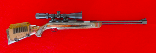

Received my new Hawke 4-12*42 Airmax and fitted it to the HW 77. I had to shim both rings with strips from a coke can as the objective lens and the flat bottom of the turrets was hitting the compression chamber and the top of the scope mount respectively. Beautiful scope made me really appreciate the difference in glass quality to what I have been using.
Noticed something about the H&N FTT 14.66gr I’m using. The head diameter is 5.53 mm and 25j on the tin. About one in five pellets has a smaller head circumference and therefore falls into the barrel quite easily, the others are a slight push. Anyhow the lesser circumference ones shoot approximately one mil dot higher on the Hawke scope than the others at 25 meters. This is no big problem as when I load a pellet and it falls in I adjust my holdunder by one mil dot. If I’m going for that perfect score on paper that is a problem as difference in height can vary a little bit.

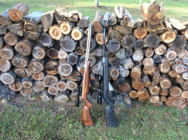

Im useing the same pellets in my LGV and Trail. They are a tighter fit in the LGV than the Trail however there is not that much of a difference in poi with the lesser circumference pellets compaired to what’s happening with the HW. Another interesting thing is when I bought the HW77 I also picked up a tin of the same pellets but marked on the tin 16j instead of 25j. I never had these problems with the 16j version.

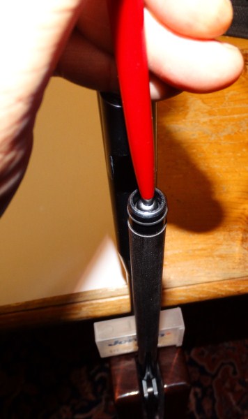

"Jonnes"Part of the twangyness (love that word!) comes from the cocking arm mechanics that somehow resonates. I have not been able to fixe that, but I assume some simple plastic or delrin washers might solve the problem.
That's the tinkling sound of the spring inside the cocking arm.
Press the pin as on the photo and pour a bit of thin oil in it. Move the pin gently up and down until the oil disappears inside.
Repeat that a few times and your twangyness of the cocking arm is just a sound of the past.
