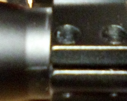

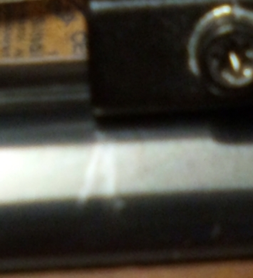

May not slip at all just use a #2 pencil and put a index mark on the rings and receiver to keep a check on slipping ..
Woth the small pencil marks to index you can easy monitor any slipping
This on the receiver and edge of base will show slipping of the base if it slips any
These 2 will mark the tube slip in the ring and any rolling of the tube in the rings
It beats scratching your head if movment causes poi change . If the marks are off ,well its moving / slipping.. near goof proof
