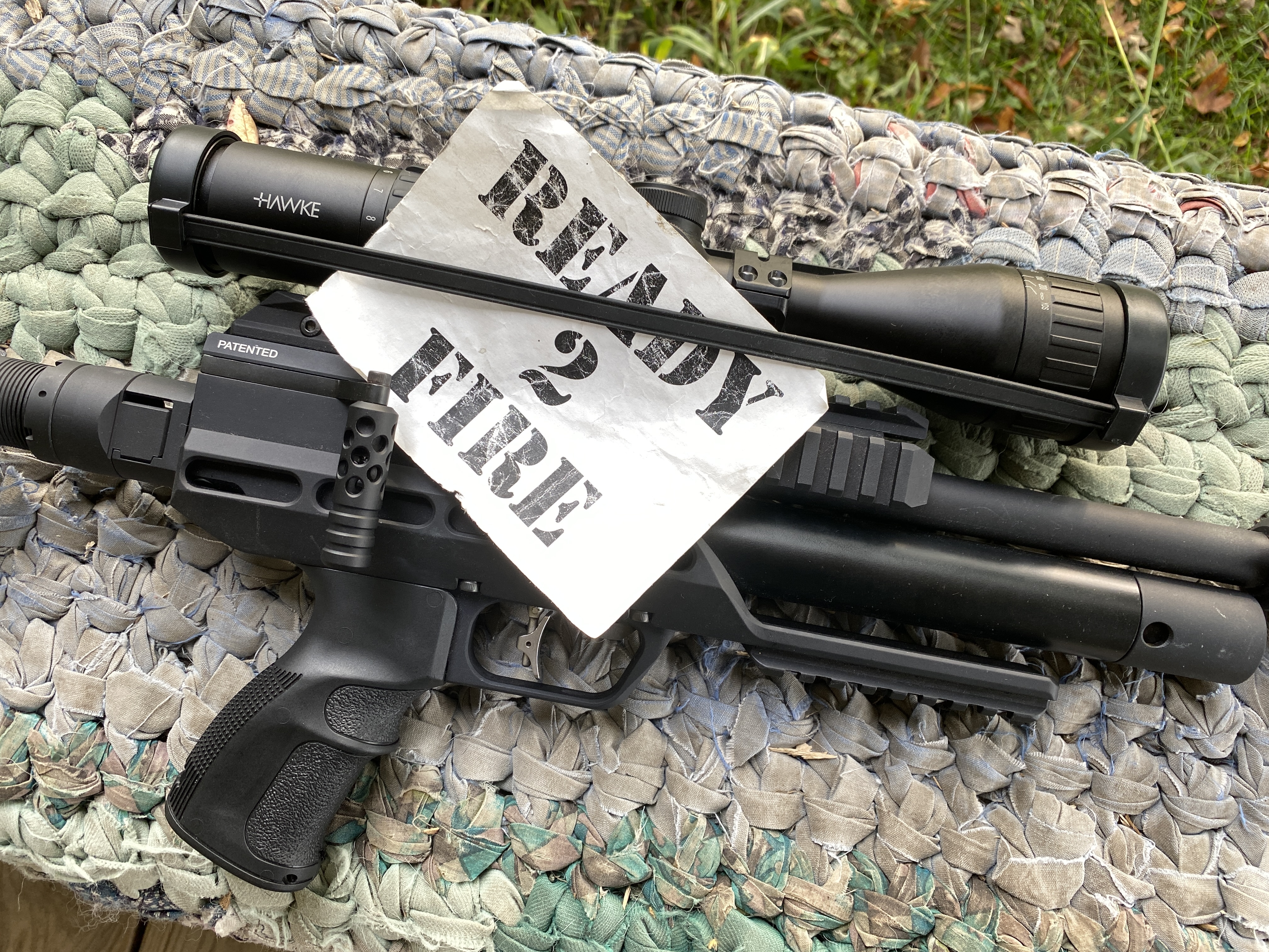

hmmm... if i hafta leave either of my air rifles 'ready to go' i simply make sure the safety is on and add this...
and seeing it's just me and my dog around here... and too, mine doesn't stay 'ready to go' for very long 😁
