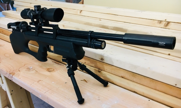

Yes,it comes right off. I removed mine along with the barrel band. The scope riser assembly helps to keep things in check so the barrel is more than rigid enough. Just screwed on a Donny Fl Tatsu and all is good.
This is 12 shots at 50 yds (full .22 mag) using JSB 18.13's. As You can see,accuracy is Not an issue.
Mike
That thing is gorgeous. I'd love to see more of this one.
