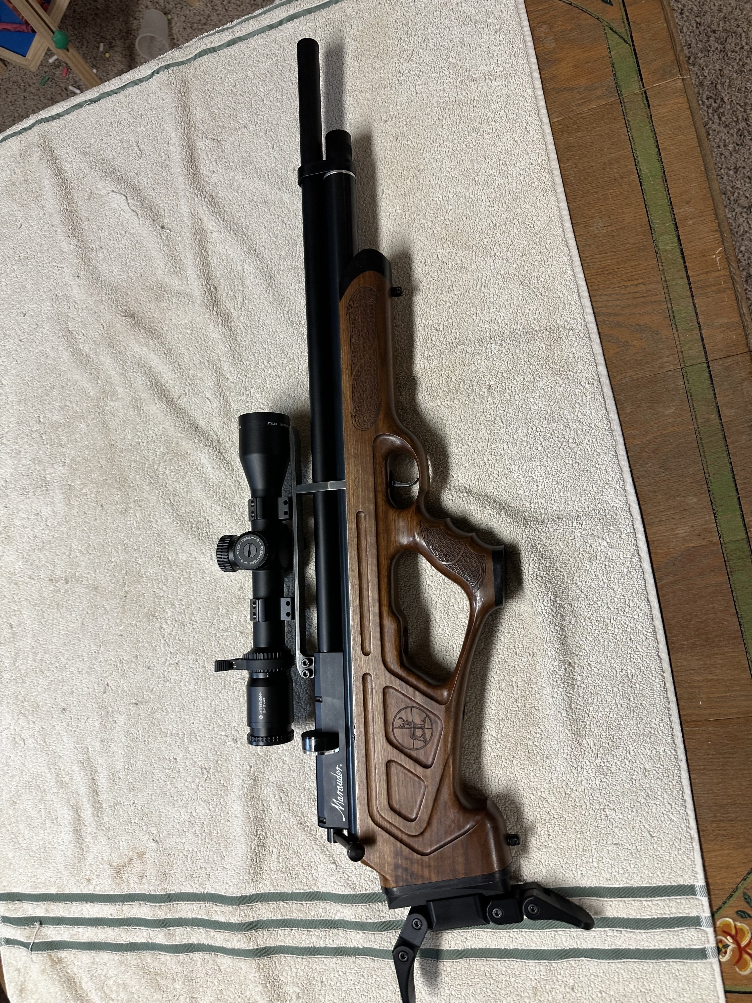

I have been wanting a Mrod but already have a full size rifle or two so I had no reason to buy one. Then Don in Va put this nice walnut bullpup kit up for sale.
Well that was all I needed. The stock arrived safe and sound and in beautiful condition. Thank you Don.
Next up, Marauder shopping…Airgun Revisions. If you want a bargain, that is the place to buy a referb. I ordered a 22 Mrod LW barrel for $300. I can not pass that up.
The gun arrived promptly and full of air. I took a few shots and wow, its a very nice gun as delivered. Thank you AR! I also ordered an SSG with the gun, so yes, a perfectly good gun, now take it all apart LOL. I also had to swap out the pic breech for a standard one. And while there backed the restrictor out.
I need to play with the ergo and the tune. I ran one shot over the china devise, CPHP @ 915fps. Very very quiet. I will tweak that down depending what pellet I end up with. I want to run 16 grain and under in this one. Depends what it likes, but if its like my 6 other Walthers, I will have choices.
Yes 22.
I will re blue the scope rail. I am at least the 3rd owner of the stock. Poor thing found good home here.
I have only seen pups here, never in person. I have a good range of adjustment with the hook. And it adds lop.

How are you achieving proper eye relief with it positioned as shown in the photo? There’s no way the eye relief is that short on that scope, is there? The scope looks positioned much too far back to get a cheek weld on the receiver, but maybe I’m wrong. Looks good otherwise!
I moved it forward a little. My cheek is just touching the back of the receiver which allows a very vertical head position. It’s going to be really nice shooting off hand.
