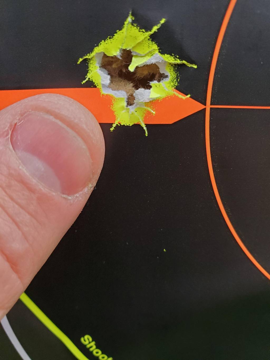

Here is a 5 shot group at 50 yards. JSB Monster Redesigns. 875fps. Was able to ring steel at 120yds with these also.
Thanks for providing not only some expertise, but also an outlet for me to 🅱️itch about this rifle until I got it right. It's 100% the most accurate and efficient air gun I have ever owned. 👊
