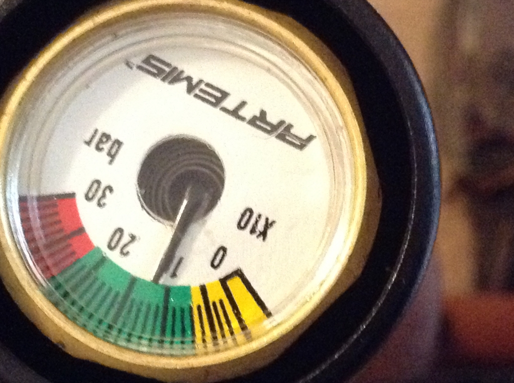

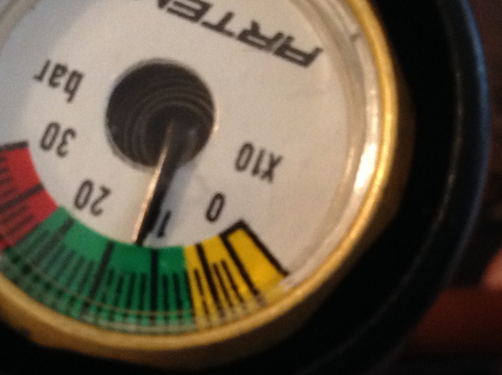

I just joined the Nation and wanted to say hello from NC. I recently acquired an Artemis P15 and noticed a potential problem with the manometer. It appears that the pressure indicator is not properly centered on the needle. When I began airing up the rifle I noticed an indentation on the paper, where the needle was resting on zero during transport. I didn't think much of it at first, but the more air I put into the gun the more noticeable it is that its misaligned. So here are a couple of questions.
Can the manometer be removed from the air cylinder, taken apart and the problem corrected?
Can a replacement manometer be ordered and installed? Any suggestions on suppliers?
Can I use the pressure gage on my pump to determine correct pressure in the cylinder?
I appreciate any feedback you can offer.
Thanks 4nash
Here are some photos of my manometer issue. Hope this helps

I usually never look at my gauge on the gun but look at a bigger, more accurate gauge on the tank if you have one. I use to have a mrod and I removed the gauge. I have a .177 verminator that I had the gauge removed. To keep track of my shot count, I count out how many pellet until I loose accuracy and carry the pellets in my pocket
Welcome to the forum and on the manometer I dropped one once and that is what it looked like afterwards. It was off by twenty bar. If it is close to accurate it just does not matter if not as others have said contact the vendor or manufacturer and get another one. As has been said these cheap little manometers cannot be relied on use the big ones on the compressor or air tank you are charging with. I make a mental note when filling as to how accurate the little gauges on the guns are and use that info from then on. About half of my gauges have been from 20 to 40bar off.

I have two guns that don't even have a monometer. I just fill using my SCBA gauge. I look at it as just one less place to leak air ;-)
I fill my Logun Solo to 2600 psi on SCBA gauge. After 35 shots I know she needs air again. Same process with my Thomas but lots more shots per fill.
