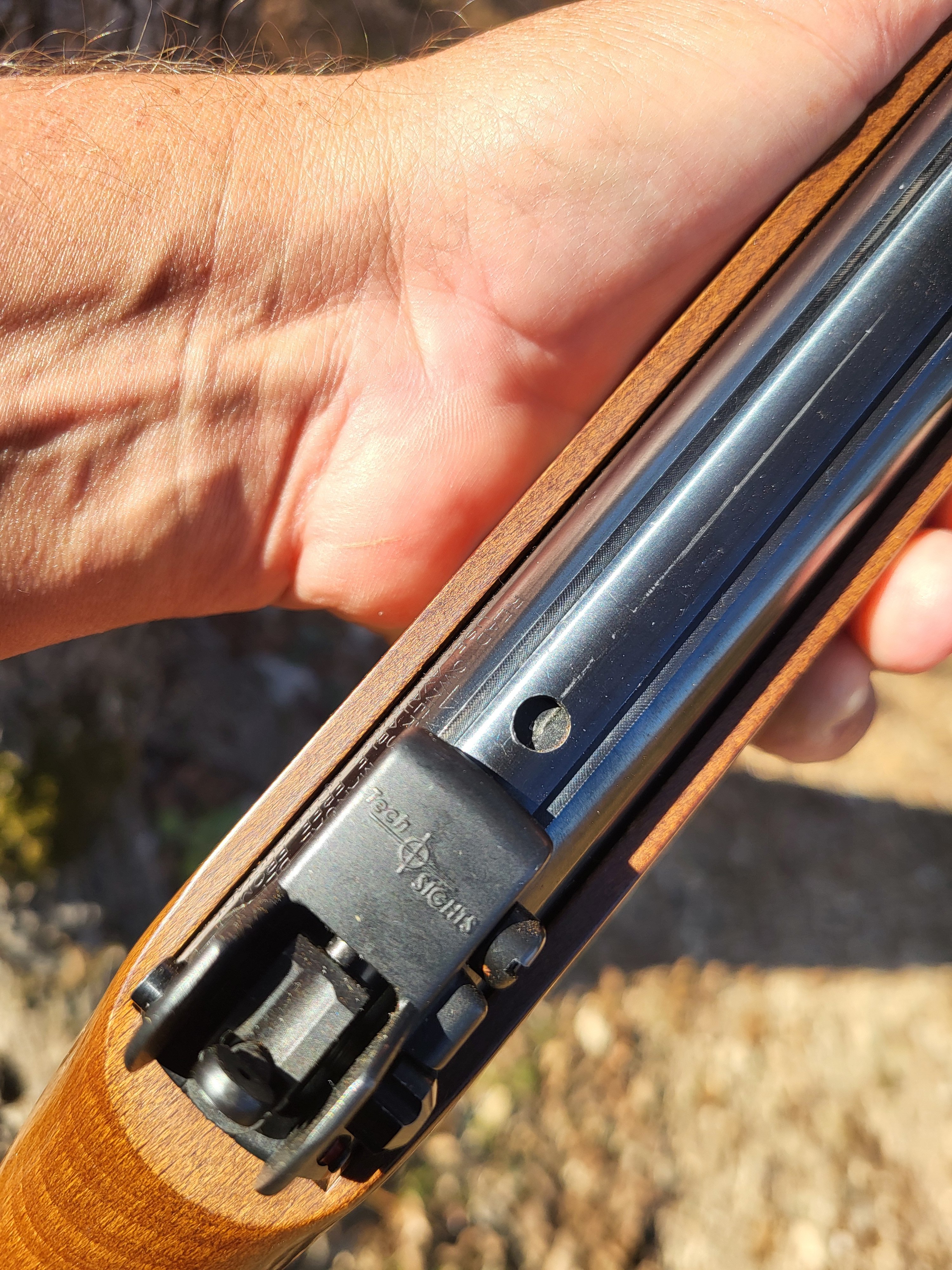

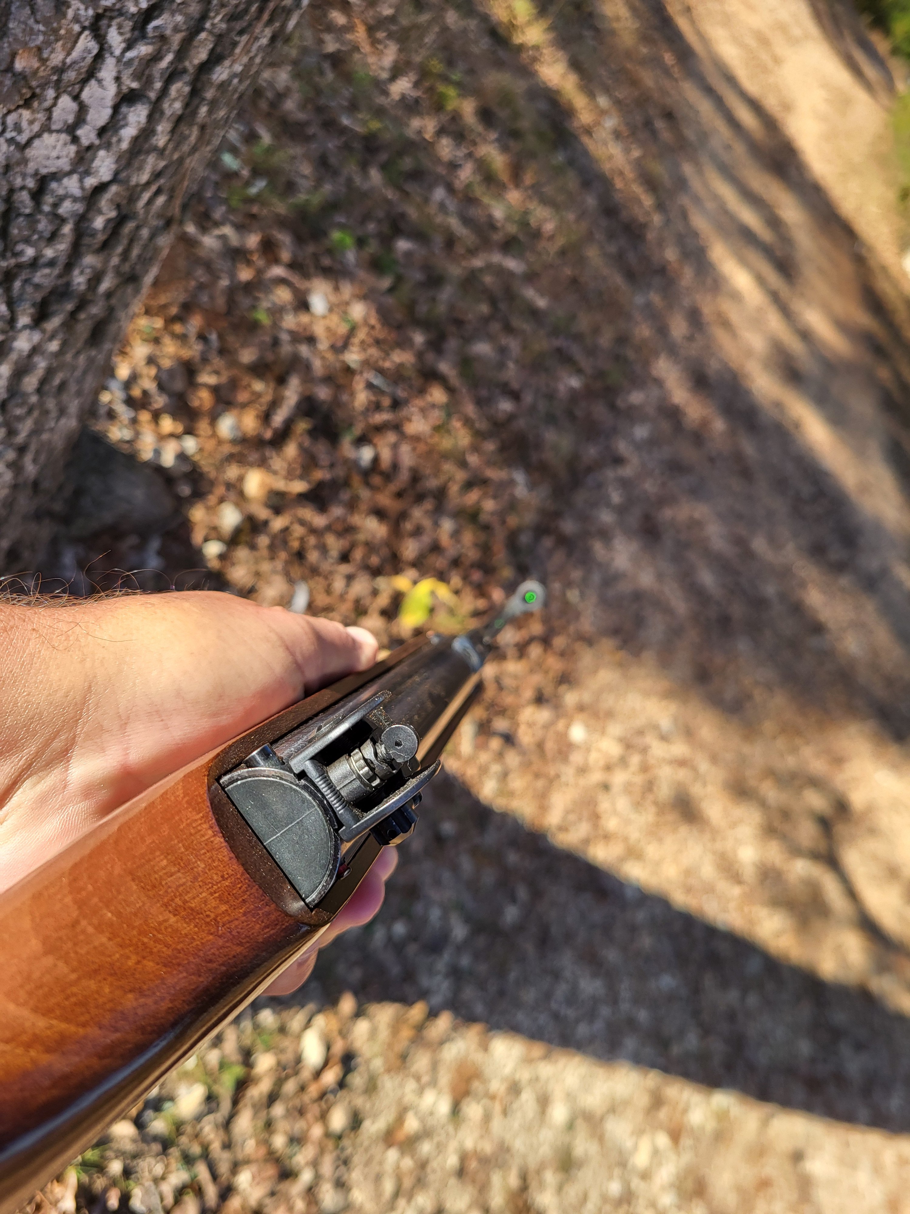

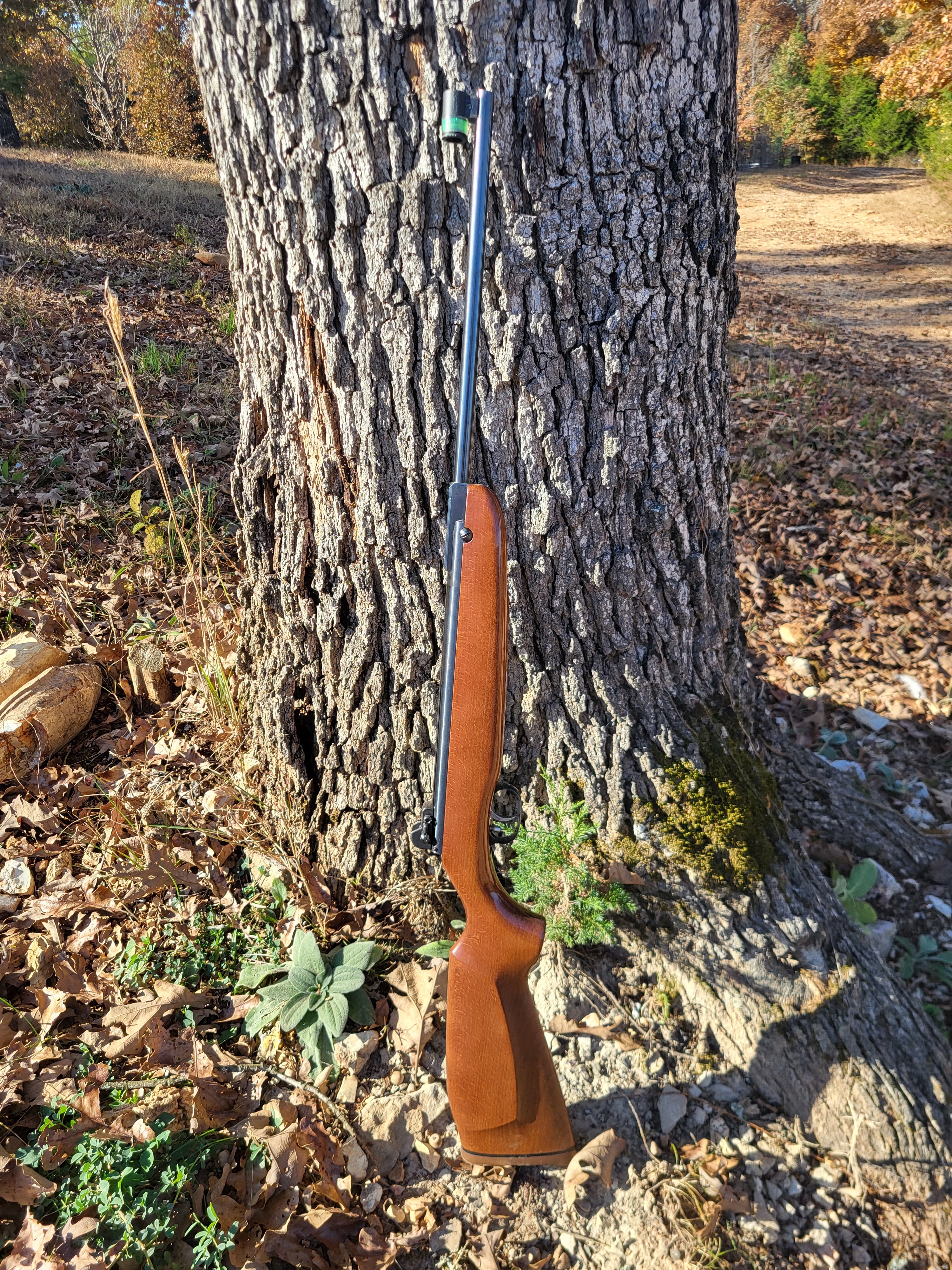

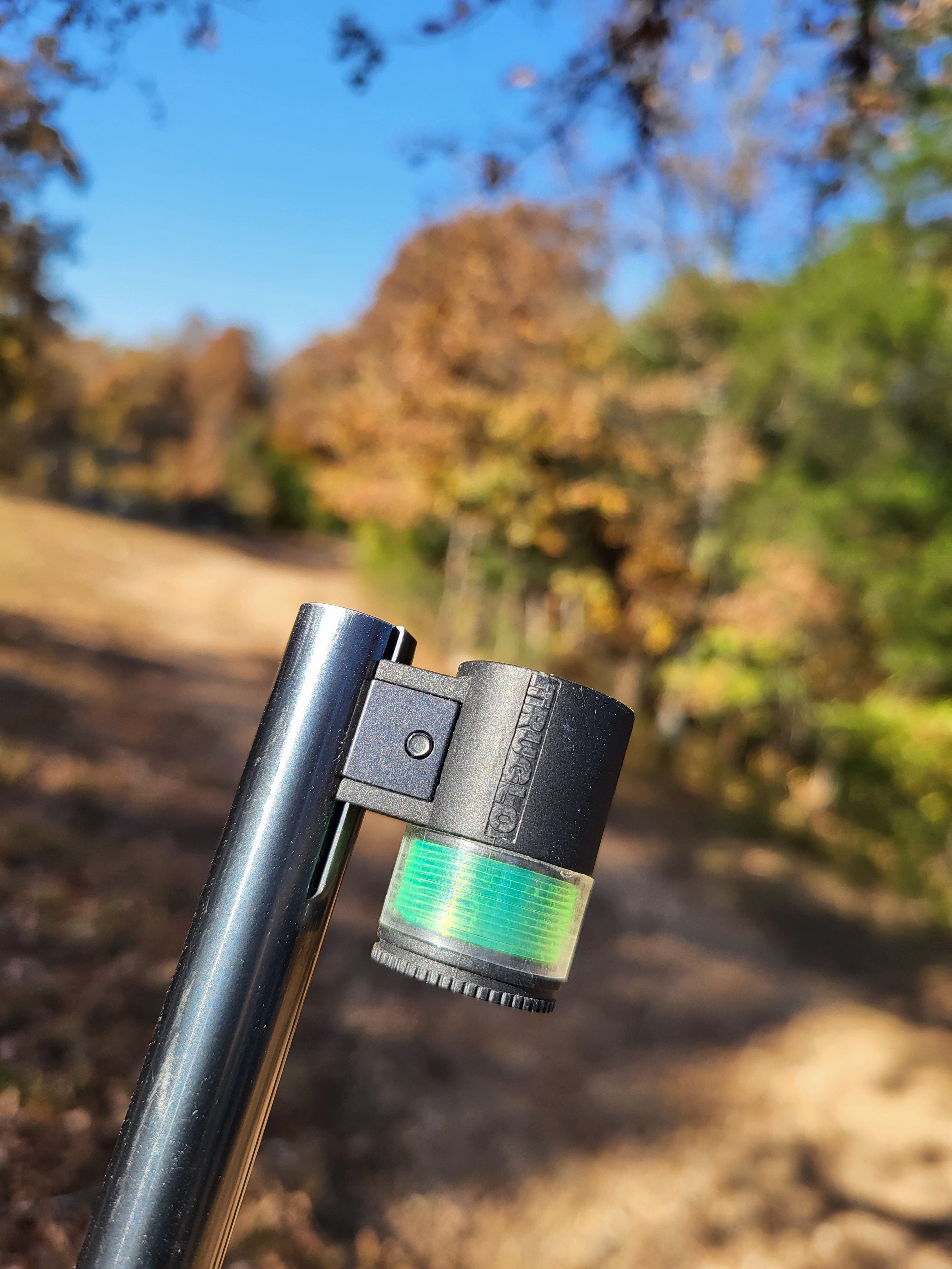

Thanks for the intro. Yes I favor my peep sighted Hw30. In fact it's my favorite rifle including PBs.
I used the Williams FP-AGs for years. I now favor these Tech Sights. I did a full write up on why on another forum. https://gatewaytoairguns.org/GTA/index.php?topic=190140.0&origin=serp_auto
Because my aging eyes are getting worse I added a $10 True glow fiber optic front sight. It's cheap looking plastic and I like the looks of the factory globes better but it works too good not to use.
This gun is ridiculously accurate and it has to have 50k shots on it. I mostly plink and pest with it inside of 25 -30 yards. 2" spinners out to 50 yards is no problem. Gets tricky around 70 yards because too much post covers the target.
