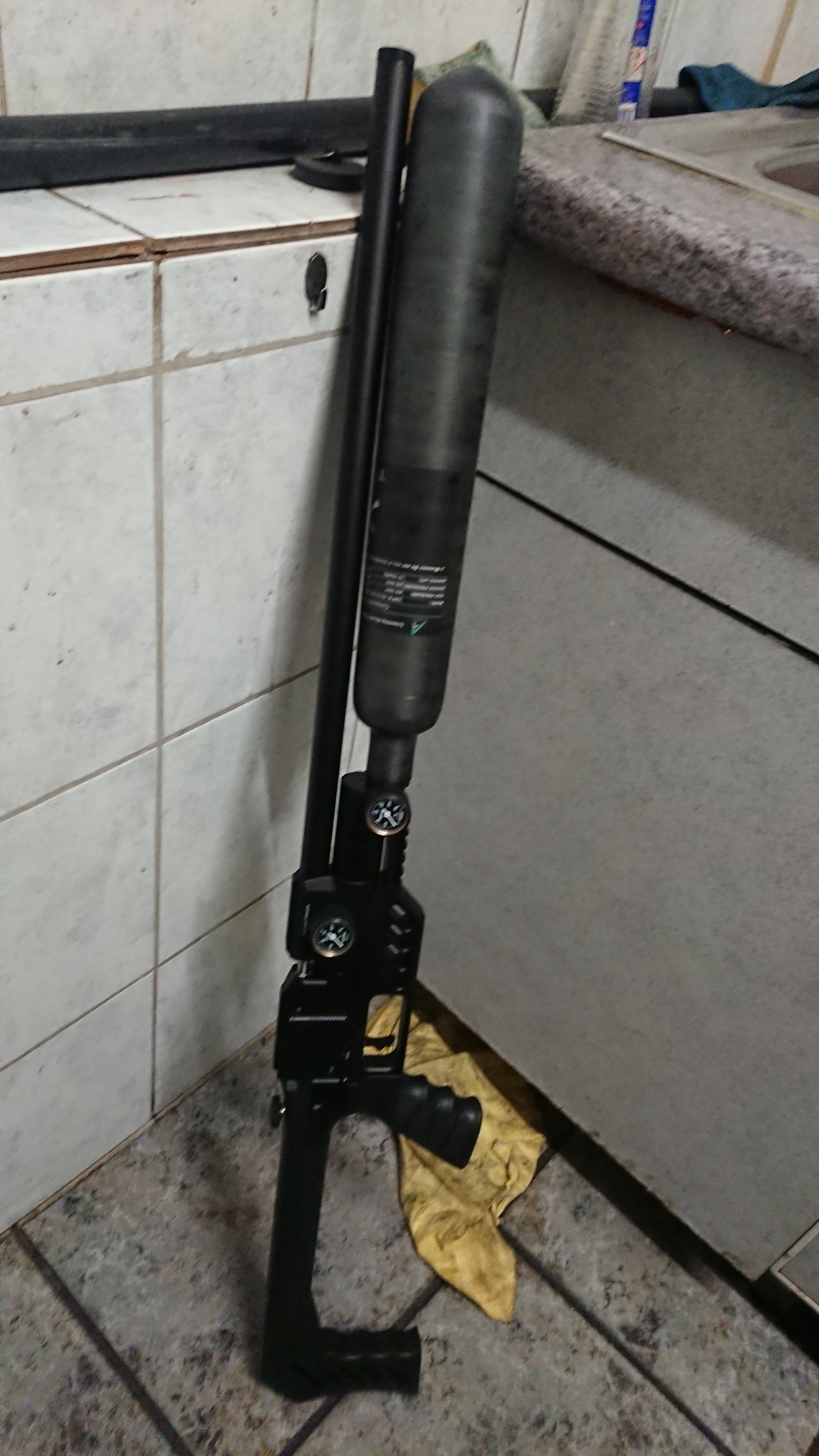

Can you post a picture of where the air tube meets the action(does it look like mine) ? Some of the newer dreamline guns have the bottle adapter and regulator with plenum and a screw on air tube with identical fittings as the fx bottle adapter. This means you may be able to just purchase a bottle of the dimensions you prefer with the bottle valve installed. Or you can buy a bottle valve and find a Chinese carbon bottle in lots of neat sizes and pick what best fits you. So long as the bottle is m18x1. 5 threads it will be a matter of screwing together parts.
The attached pic covers a few examples.
Top gun has a 360cc ali express cylinder that I converted the aea with. It was a tube gun.
Middle gun is dreamtact compact with (obscured) 300cc bottle.
Bottom gun is my money pit, semi useless slug shooting impact with a 580cc bottle for scale.
The 580 won't fit on my dreamline with the moderator.... Short barrel.

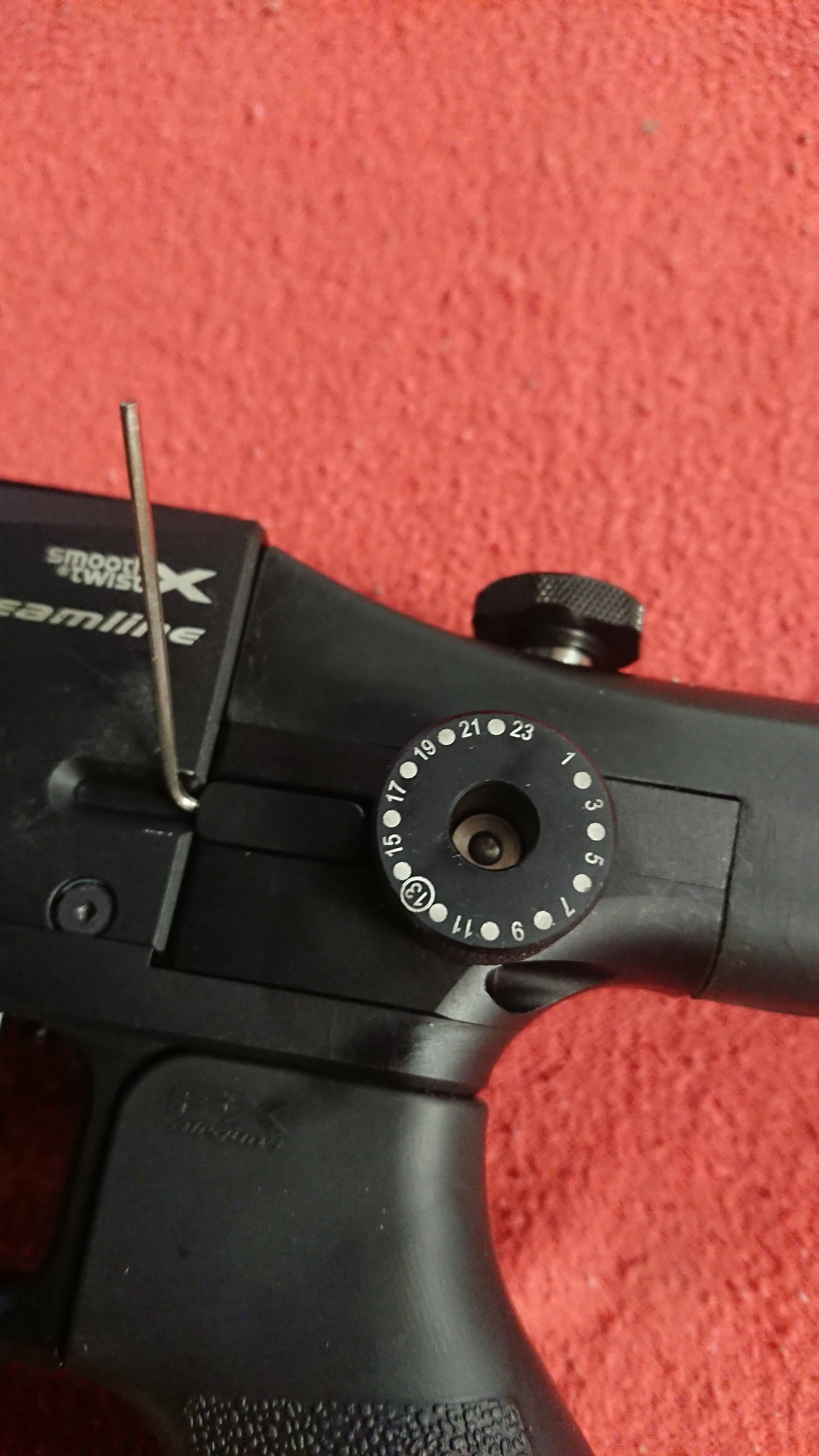

but i must tell you this- i hate this gun so far!
i don't know what those idiots at fx restricted on this gun but its not performing well..
supposedly all i had to replace was the transfer port and add the hammer weight and crank up the reg- which i did
but this stupid gun is making 720fps at 130bar and power wheel on 23 (max) and spring tensioner at max!
so if i go to 135-140bar and try to tension the spring for the higher reg pressure- there are no more threads on the tensioning screw left
so what i maxed out on 130bar is all i get
now i am thinking they not only removed the hammer weight (and put it on the side in a bag) but also put in a weaker spring but did not include the original in the bag..
so what to do now- i don't know if my spring is the original .30cal spring.. so i am thinking of just upgrading with huma power parts..
a great member here already told me to get the power spring and probe from huma..

His dreamline was a 5.5fpe German restricted version. He replaced TP Wheel which was limited to the .177 opening only to limit power. Been guiding him how to tune, and come to the conclusion he likely also has a power limited valve seat.

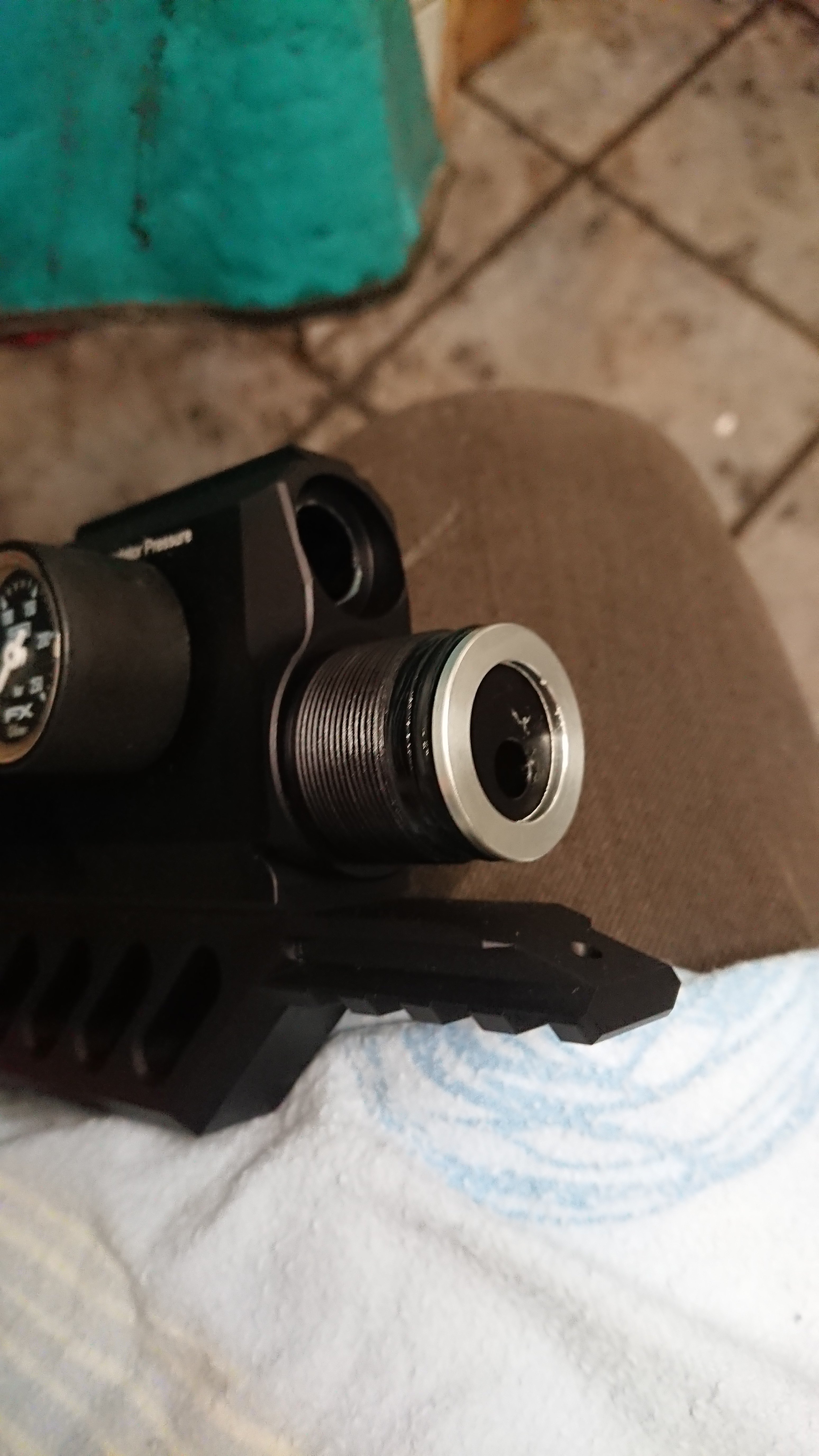

Grzech doubled up the little dreamline plenums already. Which it sounds like didn't leak and the wiggle went away after airing up?
but there was a large washer between the original air cylinder and the valve housing which i did not keep when i put my new 700cc bottle with the new bottle adapter and new power plenum
was i supposed to keep it?
i thought the plenum was not using enough threads with this washer as without it so i threw it in the bag..
maybe it should go back on the gun?
