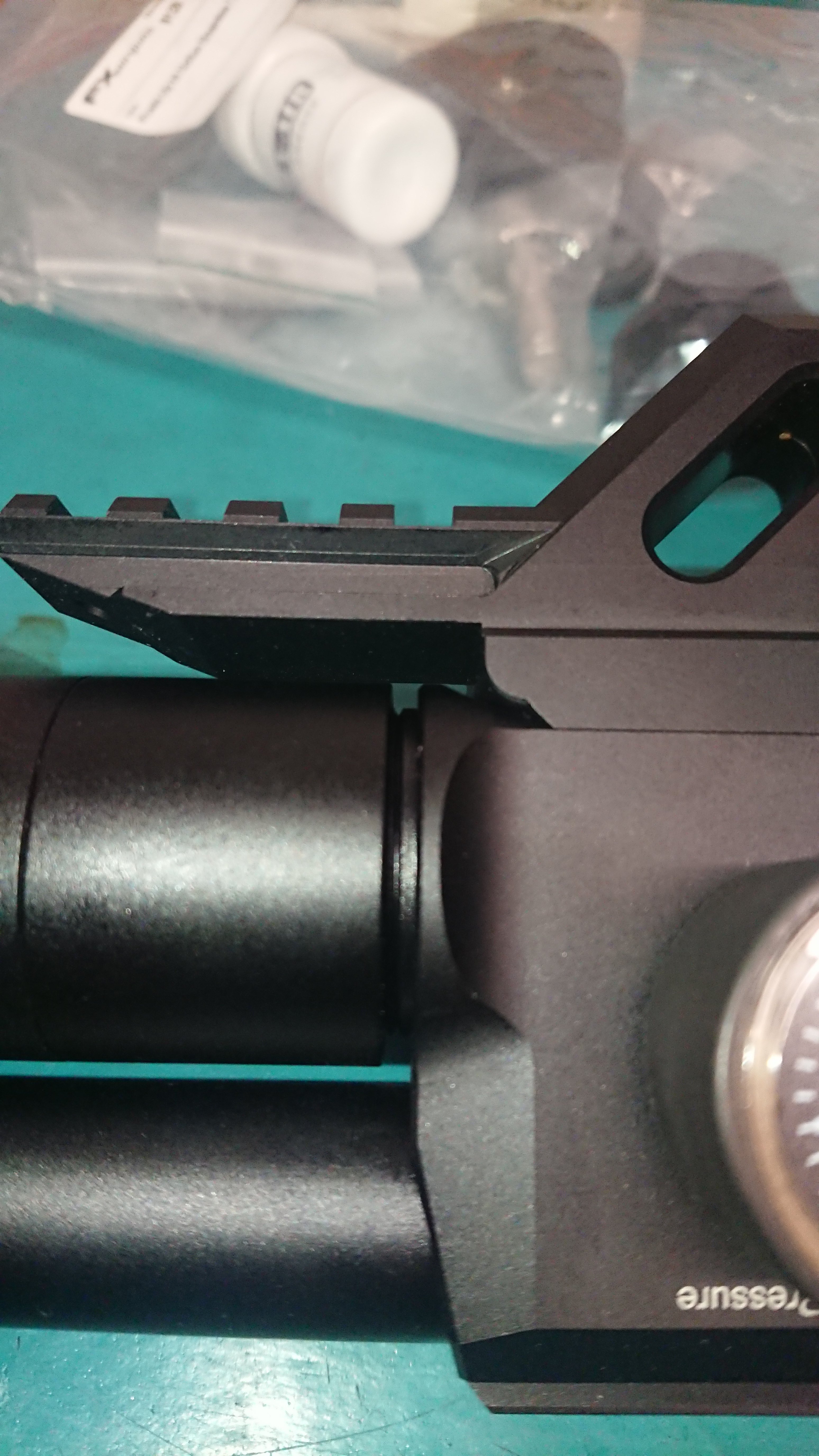

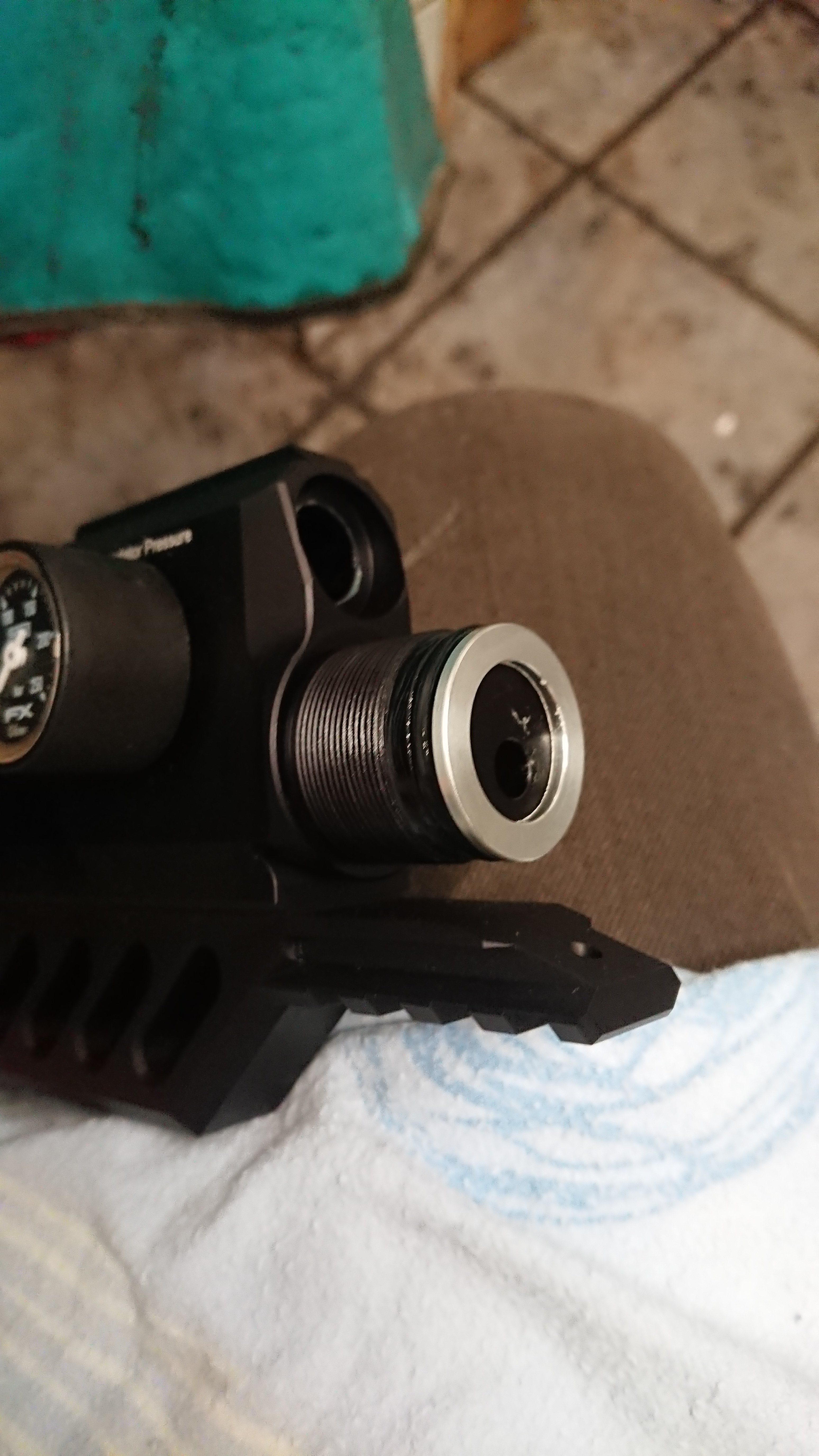

FX New member- please help with my new fx dreamline lite 30 cal- i have ton of questions but no answers..
but there was a large washer between the original air cylinder and the valve housing which i did not keep when i put my new 700cc bottle with the new bottle adapter and new power plenum
was i supposed to keep it?
i thought the plenum was not using enough threads with this washer as without it so i threw it in the bag..
maybe it should go back on the gun?
There's a couple reasons I can think of it being there. Maybe the plenum has a shoulder that sets up against it? It also adds a tiny amount of volume but I wouldn't over think that. These are only guesses.
you mean the plenum inside the original cylinder- i will look..
plus i might put it back in as it adds the new powerplenum space by a little.
i was just curious if someone knows the exact reason why the washer was there
I do not, but i will lean on the idea that it's there not by accident. Maybe it prevents chewing up an oring with a thread and keeps it on the smooth sealing surface. Not sure. It's complex and I'd have to see and think about the assembly. 1 or two threads won't be a structural deal breaker in my experiences. Especially fine threads like fx tends to use. Like I said don't over think it, if it's together and working id only mess around and degass when an oring leaks.
It looks like part of a sealing surface, personally I'd keep it.
yes- i degassed it and just put it back in since i don't know what its for- i rather leave it in... but it pushes the plenum another thread back so i have more unused threads now..

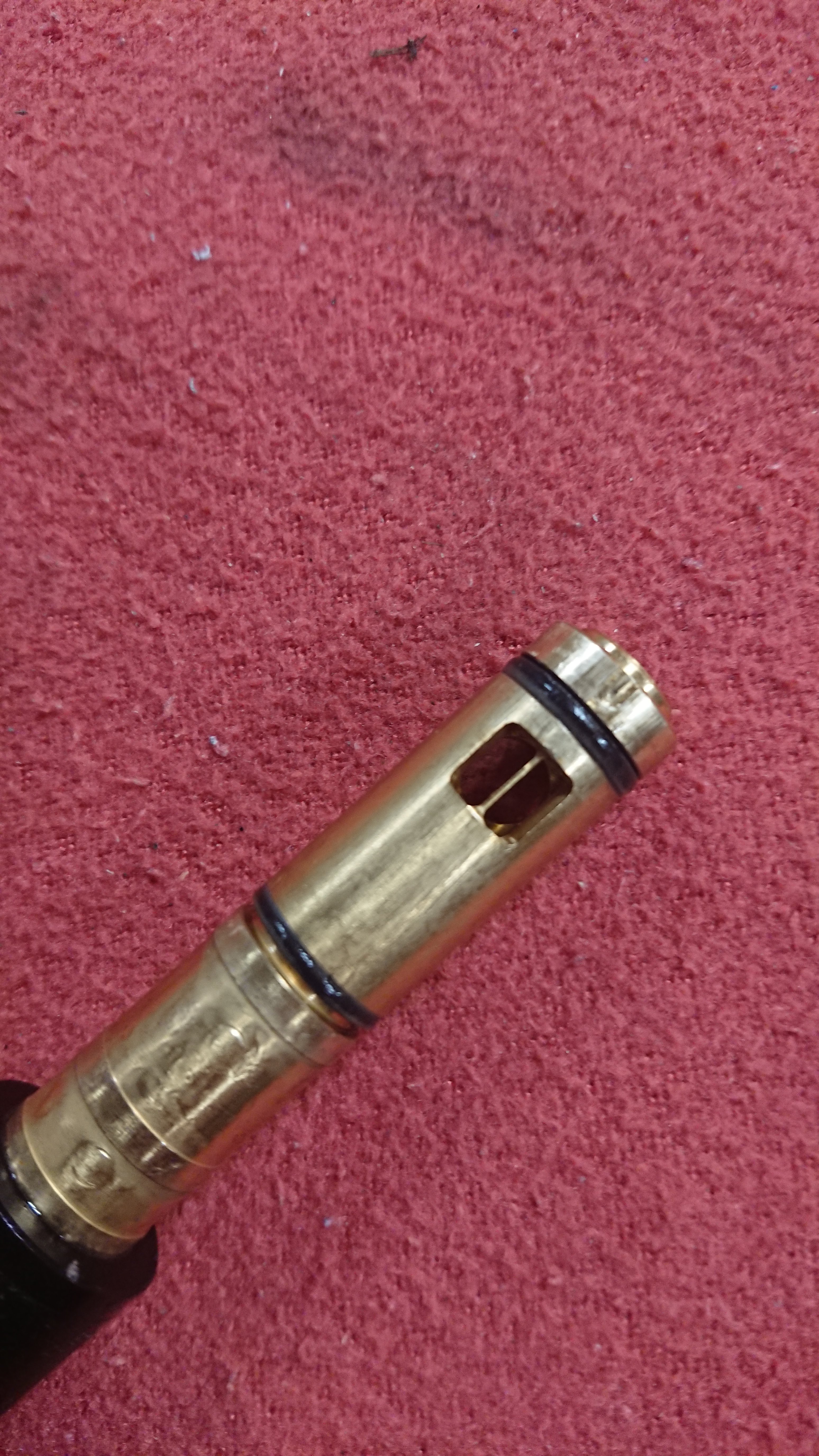

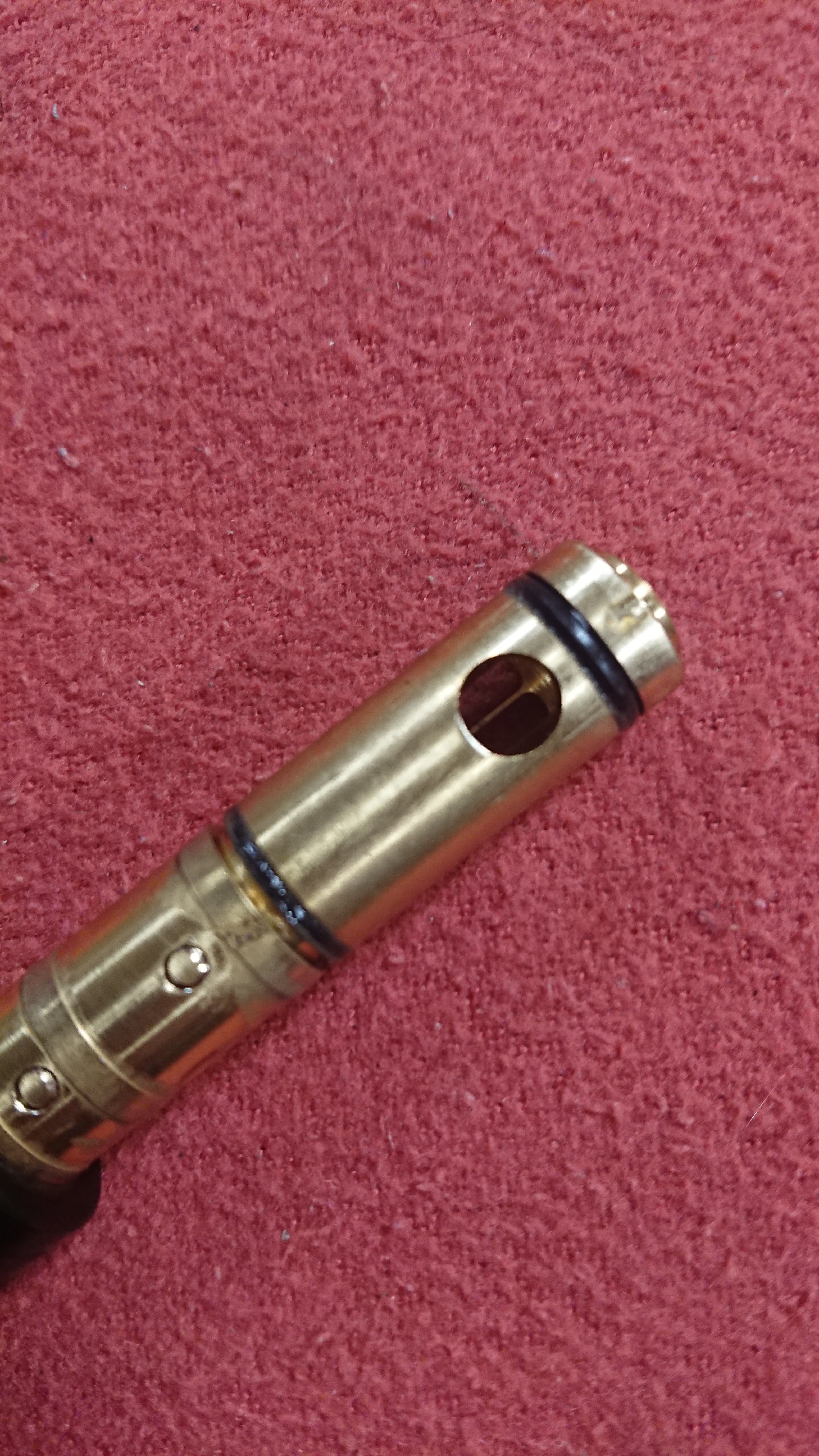

i put that big washer back in... can you tell me how to use the dual port- the hole is for the pellets and the dual holes with bridge for slugs and pellets or how does it work?
the hole that i want to use goes on the bottom??
which should i use- the single hole or the dual hole with bridge?

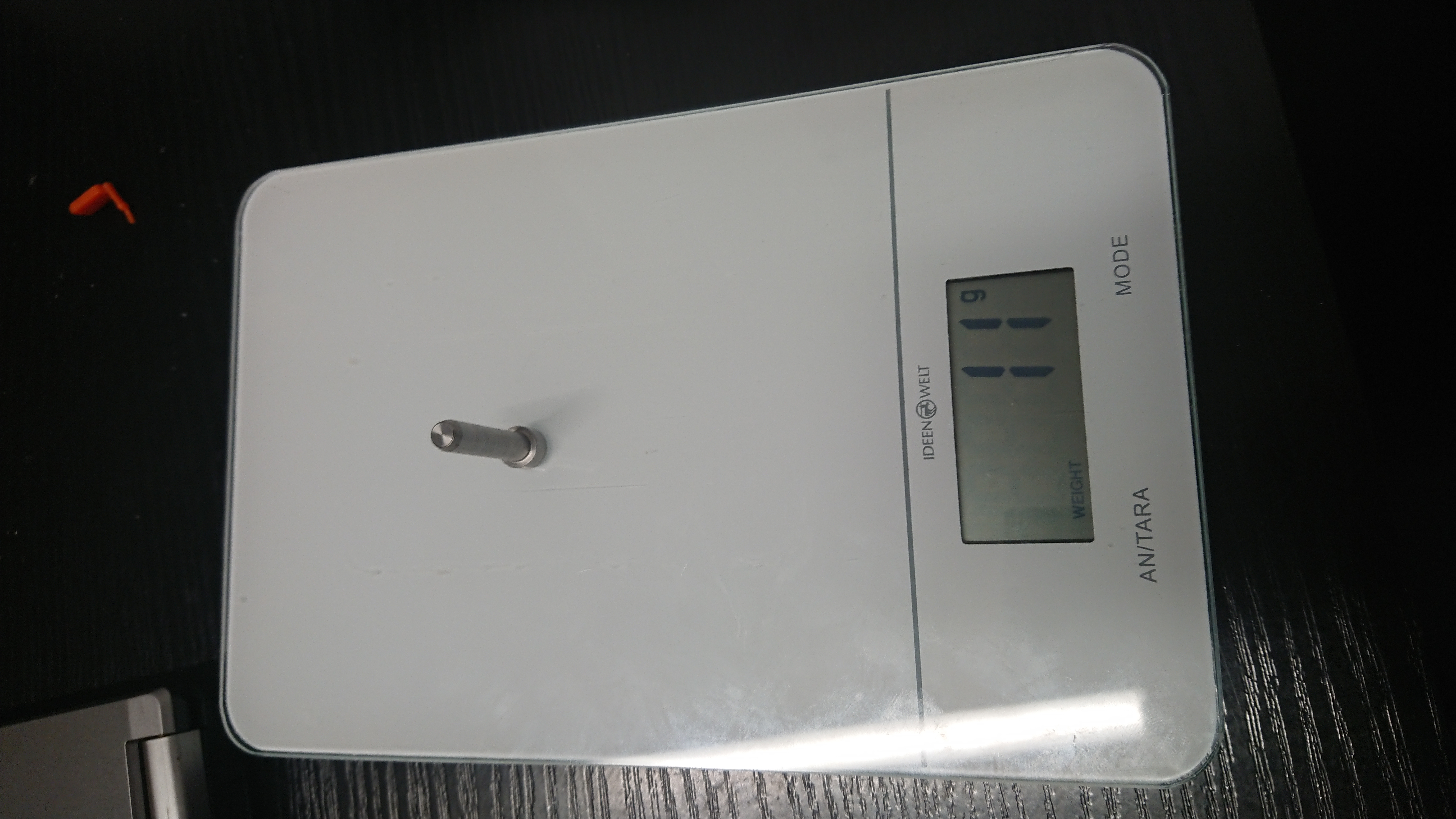

i took out the hammer and spring and weighed them today- can someone tell me if that sounds about right for the original fx hammer weight- 11gramms?
i also put the spring on the scale but i know that we don't weigh springs, i just did it because i had it in hand..
Correct. Put the window down, the hole goes up. There's a bridge in the middle to prevent projectile tipping.

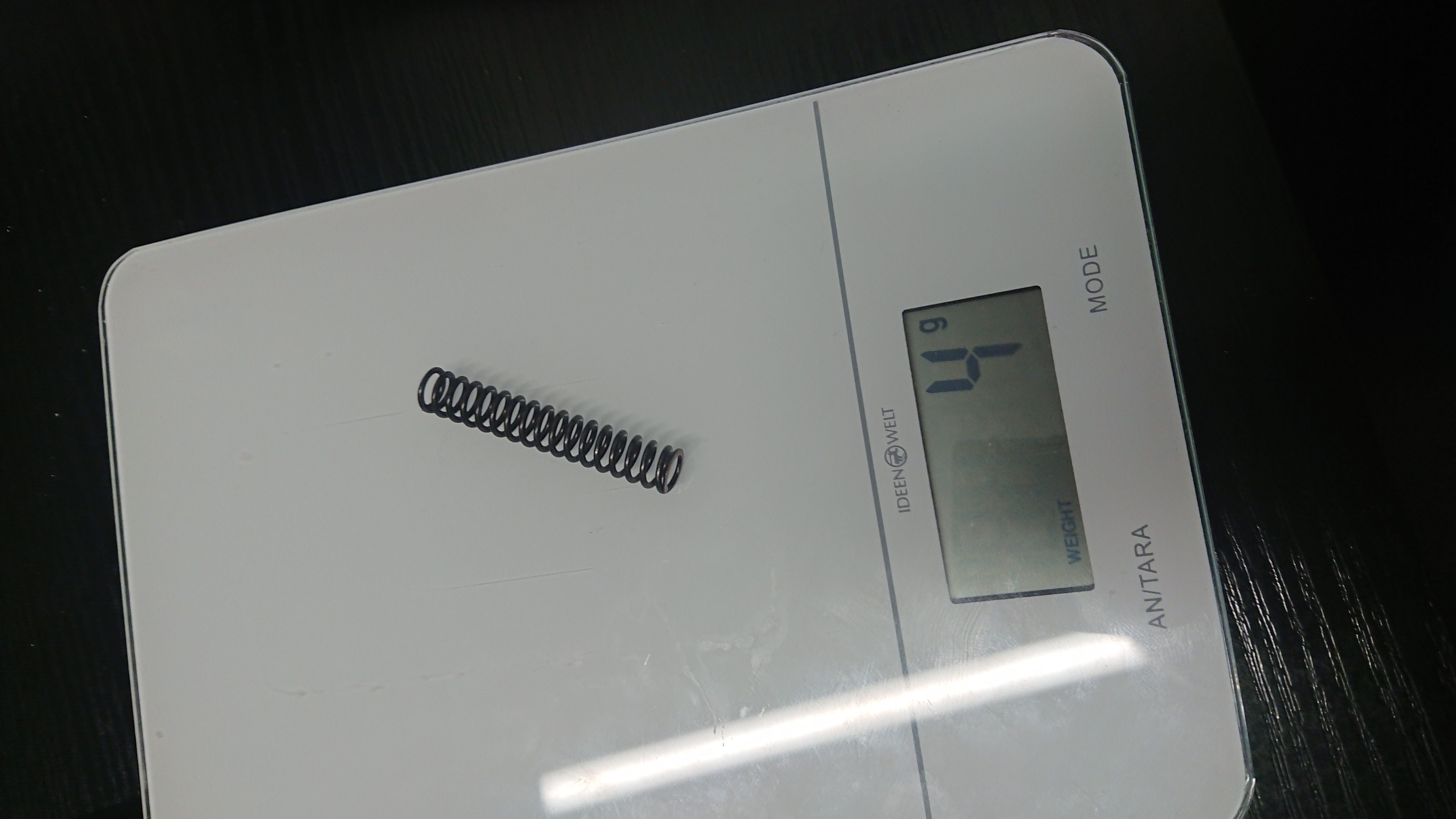

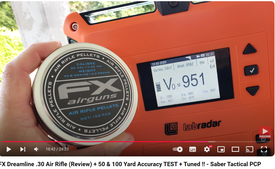

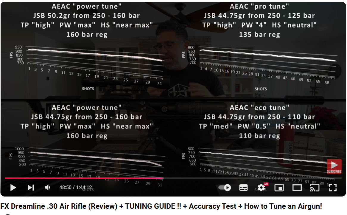

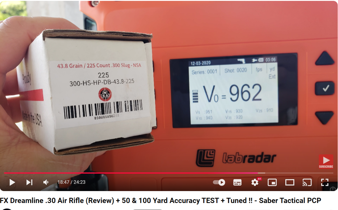

i did not buy 30cal to see only 850fps when i watch the guy doing youtube review and showing me that his DL 30cal is doing 950 with 45gr..
and many others too.. so it is doable and i want it too :ROFLMAO:

You probably need a 13.2g hammer weight. The 11g is in the .177s and .22s . I put the 13.2g hammer weight in my .22 Maverick to shoot heavy pellets .
Here's some information that might help. https://www.airgunnation.com/threads/fx-hammer-weights.1305975/
thank you!!

this is my hammer- only 11 grams
