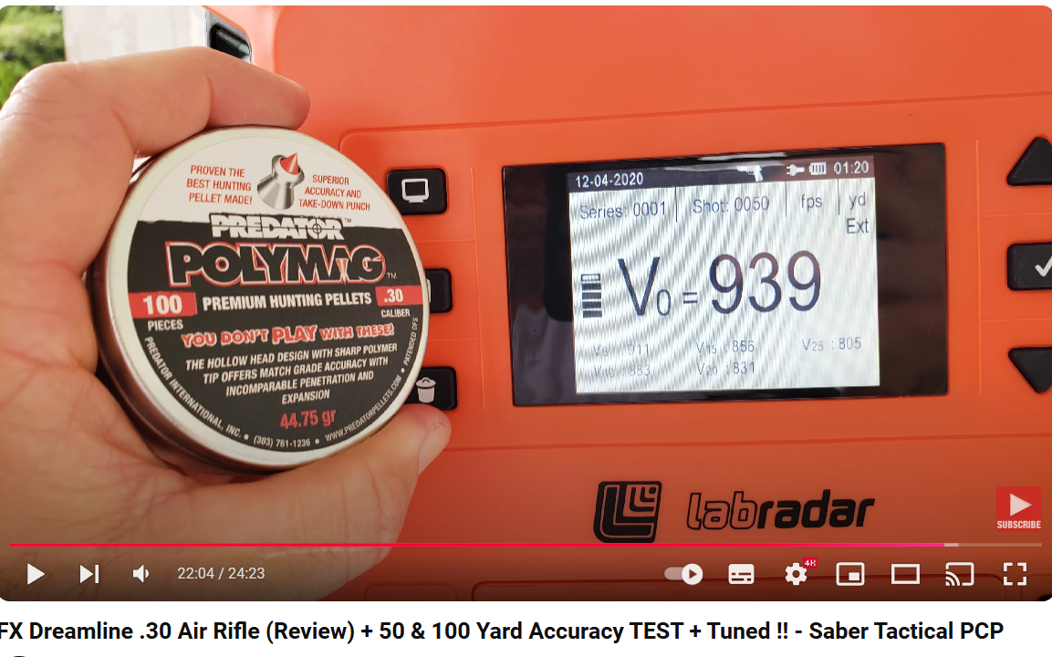

The AMP reg in the post 2021 dreamlines is the same AMP V2 in crown and impact I believe. It's not supposed to be set above 160.

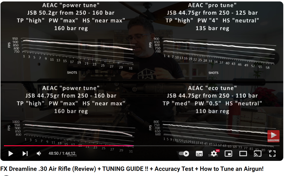

I suggested he started a work up at 130bar. Because of my experience with my .25
From 100-135 bar I can reach acceptable velocities. It's between 128-135 that I can get the most out of mine. I've installed the high flow tp, probe, power tune spring and I'm shooting 34gr HMk2s at just over 900 if I roll the wheel up to 23 with my current preload and and reg setting... Almost 62fpe, and I still have another 1.5-2mm to go on the internal (micro)screw. At this setting Im only getting 55shots per 500cc tank fill (250-150).
I think it may be, in his eagerness to get power he may have it overdone. Could be plateaued... Rolled right past the sweet spot and it dropped slightly. He doesn't have the experience you or I do with these particular guns. I'm not expert ... But I have learned with 3 FX guns... Simply turning up the knob doesn't make big numbers.
I'm not trying to insult him or anything. But he's said himself "it doesnt make sense'.
I said the same exact thing when I was learning. It blew my freaking mind to see the velocity going up significantly as I lowered the pressure. I didn't quite understand the instructions. Using the Pw to tune and making brute force adjustments of the internal. When it could literally be a quarter rotation between perfect and absolute crap tune. From a sub 10fps extreme spread to 30fps. High lo hi lo. Wanting to pull my hair thinking I threw away $2500 (parts and scope etc included)
The plenums will possibly help the gun reach peak velocity and output at a lower pressure than without

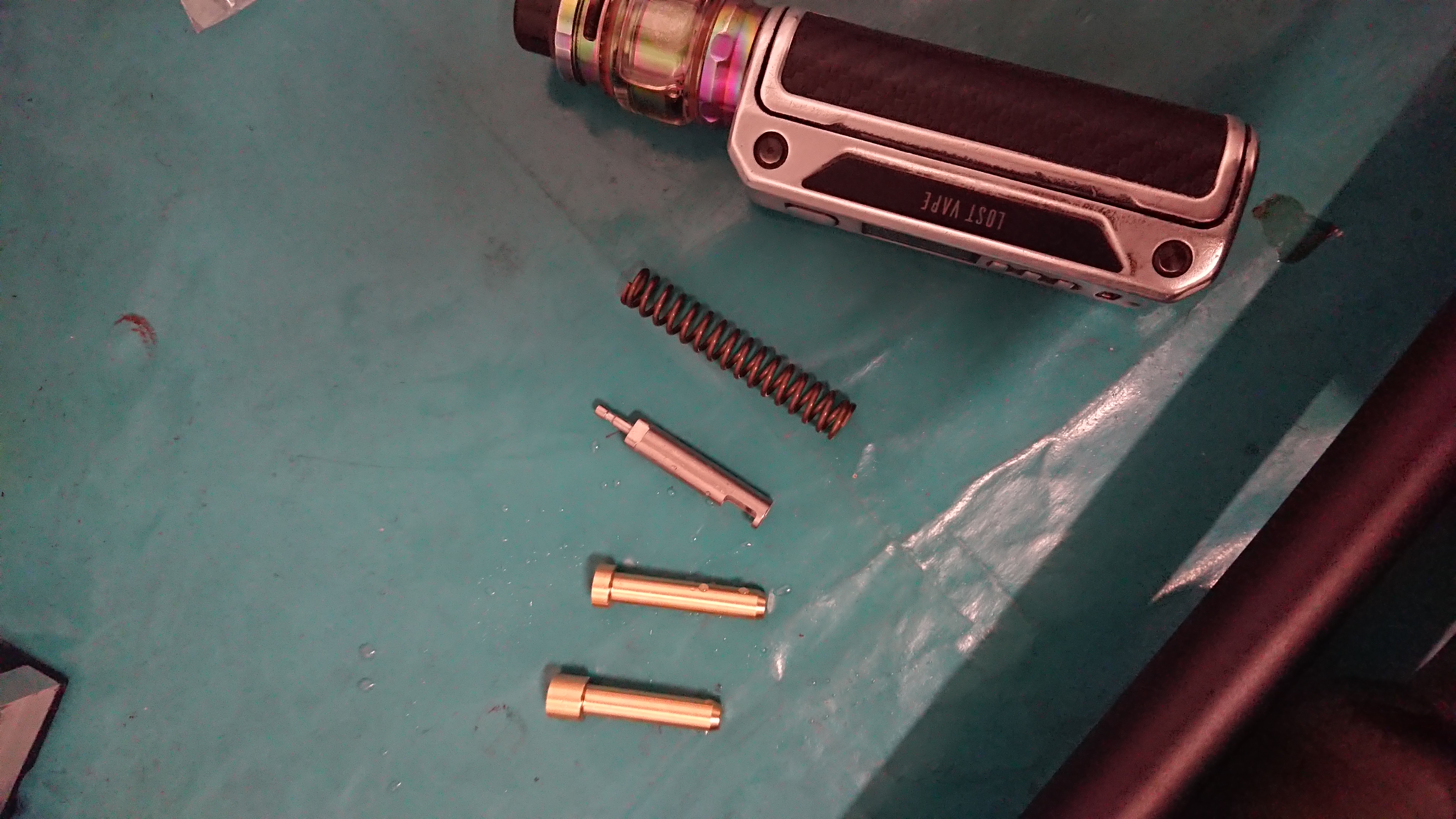

i got the pellet power kit and i installed the spring and the heaviest hammer, the probe not yet..
after putting the 13.2gram hammer nothing changed- i still could not get my fps to drop at 130bar reg so i decided to put in the heaviest 14.5gram hammer
and still nothing- i kept cranking the micro 1.5 to the max but my fps would not drop but i was getting only 800fps..
so to finally get the damn power wheel to overcome the pressure i shimmied the spring with 3 washers!

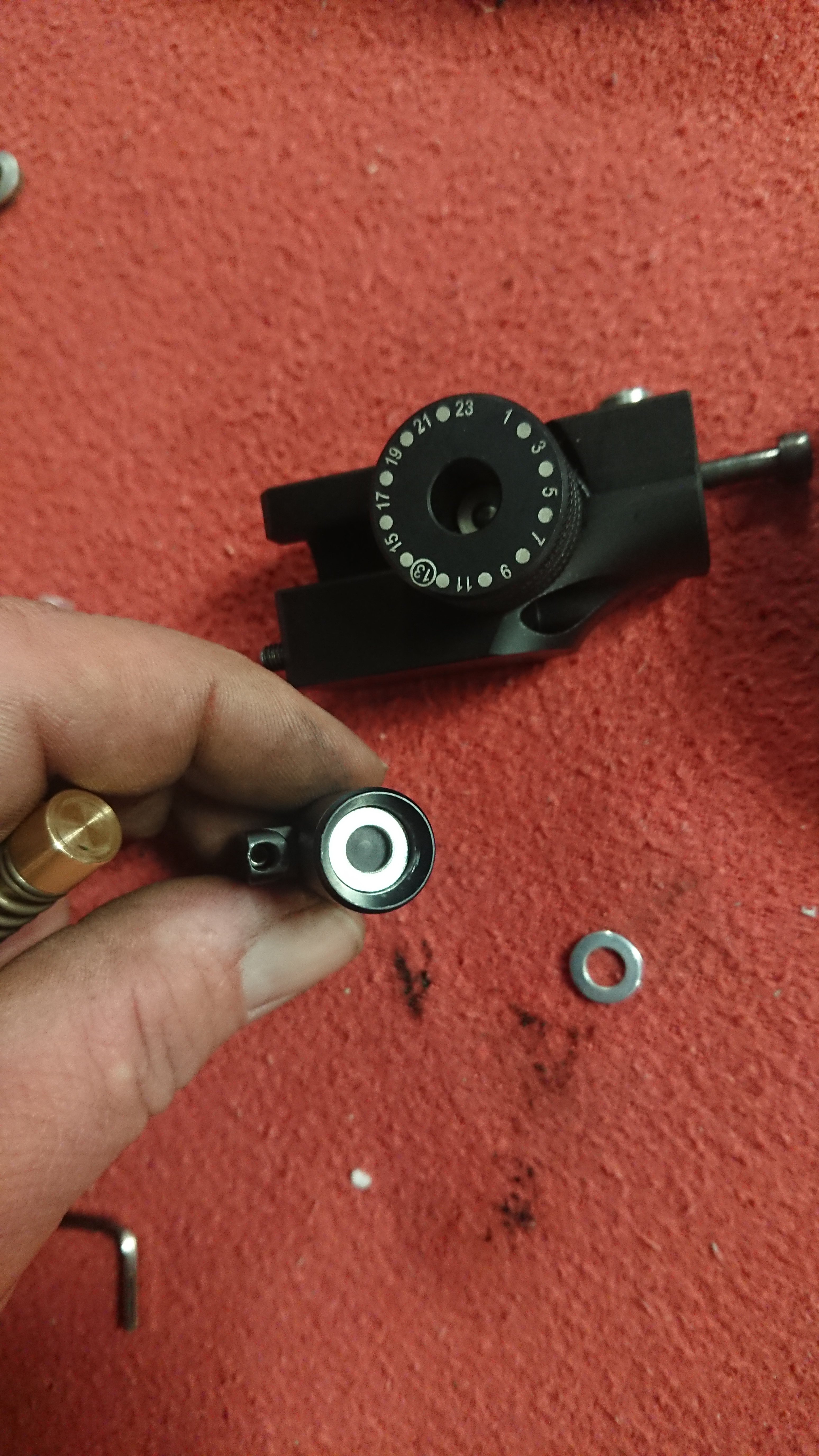

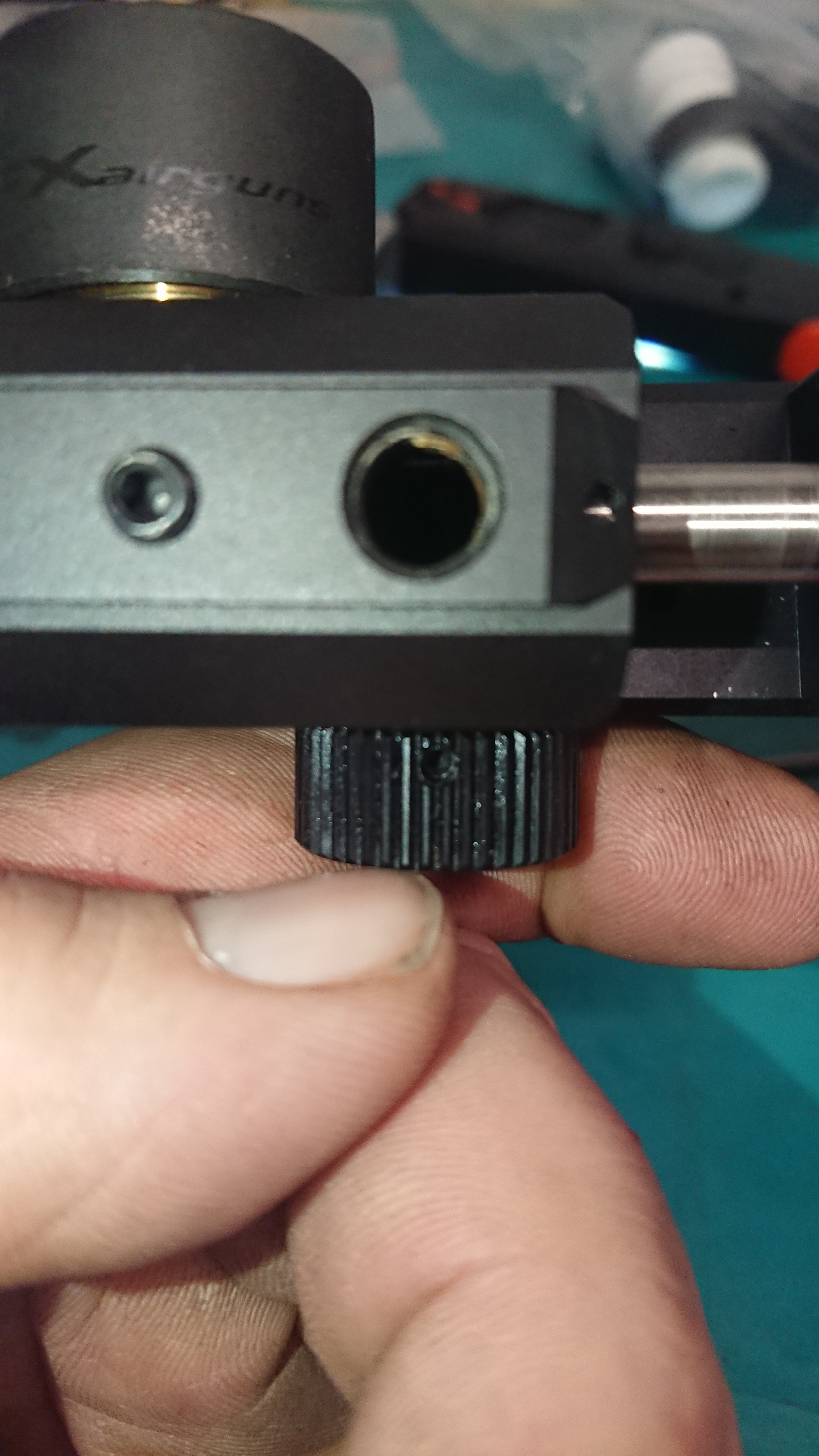

so at this point i thought there is nothing else to put in but i kept thinking about my transfer port selector- that maybe it is not right put in..
and sure enough i took out the barrel and the last retaining screw- the biggest one closest to magazine and shined some light on my transfer port wheel to see if its open correctly
and sure enough it wasn't opened right- it got twisted and in the highest selection almost half the port hole was covered with the other part that lest the selector turn on it..
now i got the hole right- it got a lot bigger so i knew i am on to something

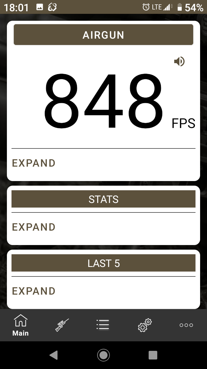

and nothing big came as i expect it to come- i managed only 850fps with the 45gr jsb..
so- after figuring out that the transfer port was not opened all the way, after putting in a stronger spring and the heaviest hammer, after shimming the damn spring with 3 washers and cranking the pW to max i managed to get around 850fps with 45gr or 820fps with H&N 50gr slugs which made around 75fpe or 101j..
i know it is a lot better then the 770fps i was getting last time but i was sure i would get over 900fps with all that added stuff and the shimms and not only 850fps..

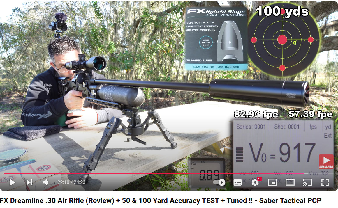

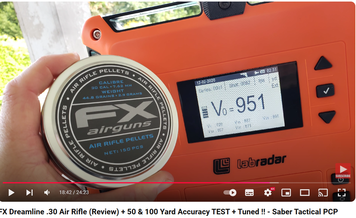

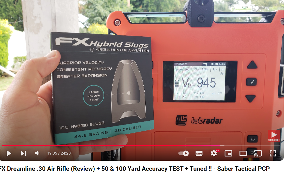

so the 850fps seems to be my limit but others are getting 950fps out of theirs 30cal dreamlines..

-how to hell is this guy getting with his exact like mine DL 30cal 600mm these numbers?? beats me..

If you up the reg pressure and velocity decreases, you're out of hammer power. Spring and hammer weight work together.
The reg pressure and air flow will help close the valve if you are over gassing,so id like to see you use 150 bar and THEN experiment to overcome it with the hammer etc. Don't expect more than a few fps from the probe.

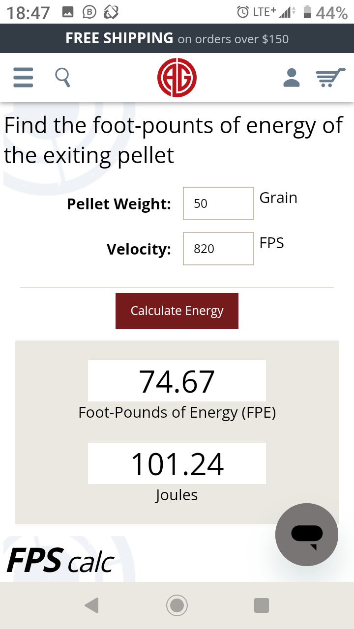

You're already well past the energy im making with my 700 in 22 and im running 142 bar right now, but different gun. The dreamline isnt anyrhing ive ever seen as a powerhouse but it's not to say it cannot be done.
