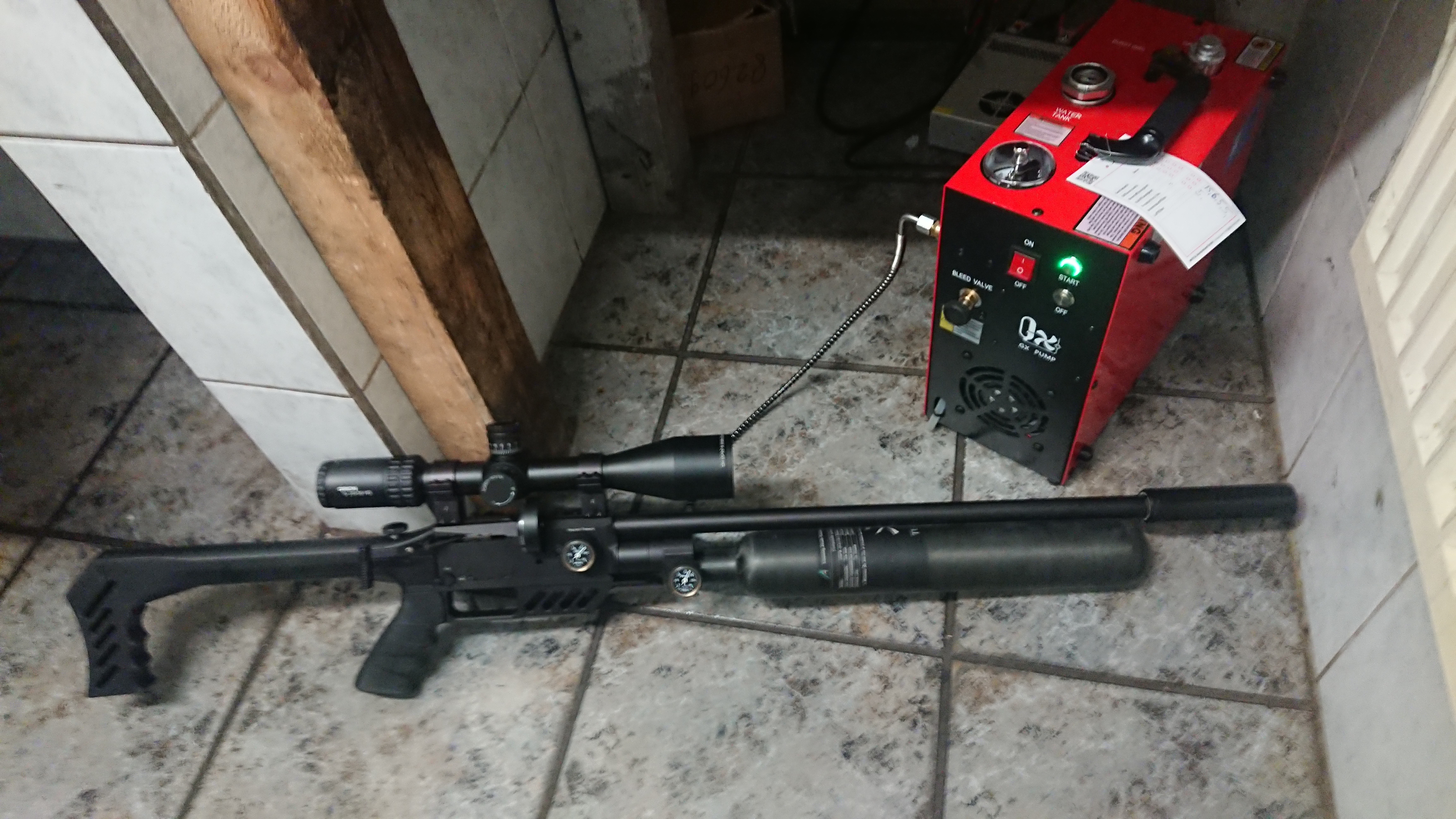

FX New member- please help with my new fx dreamline lite 30 cal- i have ton of questions but no answers..
Mess with what you have in the gun a little more and find the hammer limit. Pretend that the micro screw and macro wheel do not exist and leave them as they are, only adjusting the regulator(as directed in the manual do you don't ruin the piston)
You would need to get the high pressure reg and the tungsten hammer if you want to exceed the factory specified pressure limit. If your micro isnt helping anymore, have you found the point where increasing regulator pressure starts to lose velocity(a repeatable 10 fps) ?
The linked hammer is basically the end of the road and you will then be capable of over gassing the gun making it loud and often less accurate due to the air disturbances behind the exiting projectile. You could try it with your power spring eventually. I would carefully experiment with increasing pressure gradually over the chronograph to find where the pressure increase starts to help close the valve and shorten you valve open time.
At least on my 22 I was able to find that limit, and then turn it down using the tungsten hammer to make my shot sequence a smoother one at more realistic pressures and velocities. More force is more wear too on the hammer and valve components.

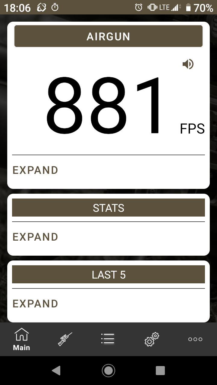

yes- i think at 150-155reg and pw max and micro 70-80% i get 870fps but when i went up on the micro it dropped to 860fps..
but i can not go any higher on the reg or i will risk damage to it
so it means my hammer is too light when i go over 80% on the micro..
so should i go for thungsten hammer? but it makes no sense since i am almost at 160bar and can not go higher to utilize that heavy hammer, right?
and i am not sure i want to beat the gun with 180 or 190bars if i get the super high pressure reg :ROFLMAO:
but maybe just getting the super heavy hammer could help me get my 870fps at lower reg pressure? would that happen- no.. that would not happen because if i add to much hammer at lower pressure on the reg i will overpower the valve and the fps will drop
so getting the tungsten hammer makes only sense when one gets the super high pressure reg from huma..
or not so?

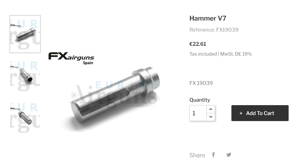

Not only will Increased hammer mass open a valve with more pressure behind it easier, the mass leaves the valve opened longer. It's a little bit different tuning experience because you have enough stuff to beat up parts and extrude orings now.
you did not answer me- will i be able to get the same 870fps (or more) i get now at 155reg with less reg pressure?
i could get few of those hammers and cut the back ends off at different lengths to get different weights...
and experiment with that.. so make like 18gram and 22gram hammer..
what do you think?

i am ordering this hammer- its a compromise between my 14.5grams and the tungsten at 27grams- it weighs 18.1grams

ok... i was thinking about some posts where the posters said that the heavy hammer broke their valve pins but that's the chance i am willing to take
so i opted for both
so i will basically gather my experience in smaller steps- first with a much heavier 18gram hammer and later with 27gram..
i already saw the difference in fps when i went from 11gram to 14.5gram (3.5gram increase) so i will probably see an improvement with the 18gram which is again another 3.5grams increase... and later with another 9gram increase
i did not order yet because i am looking who has them both so that i pay the shipping only once.

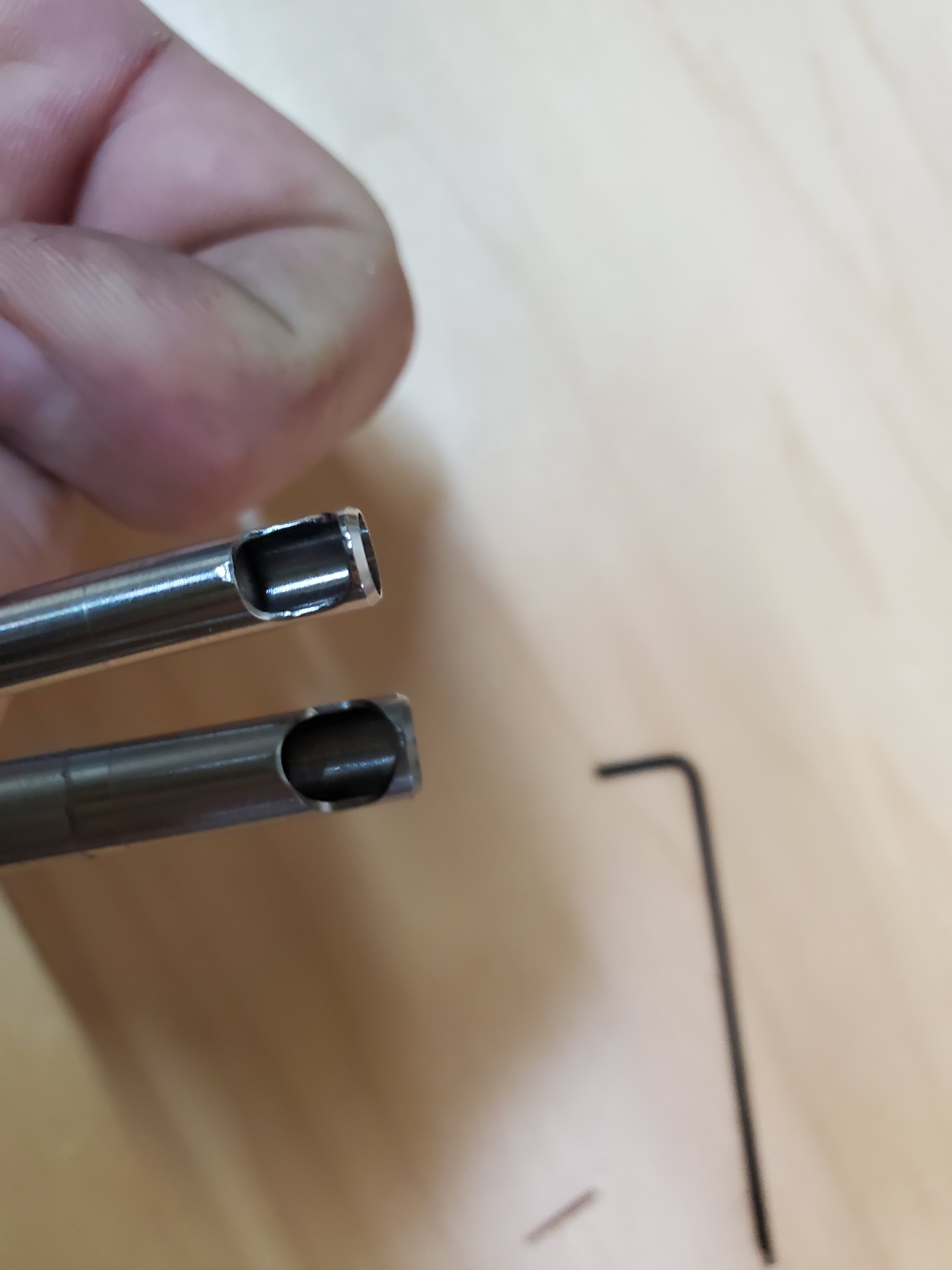

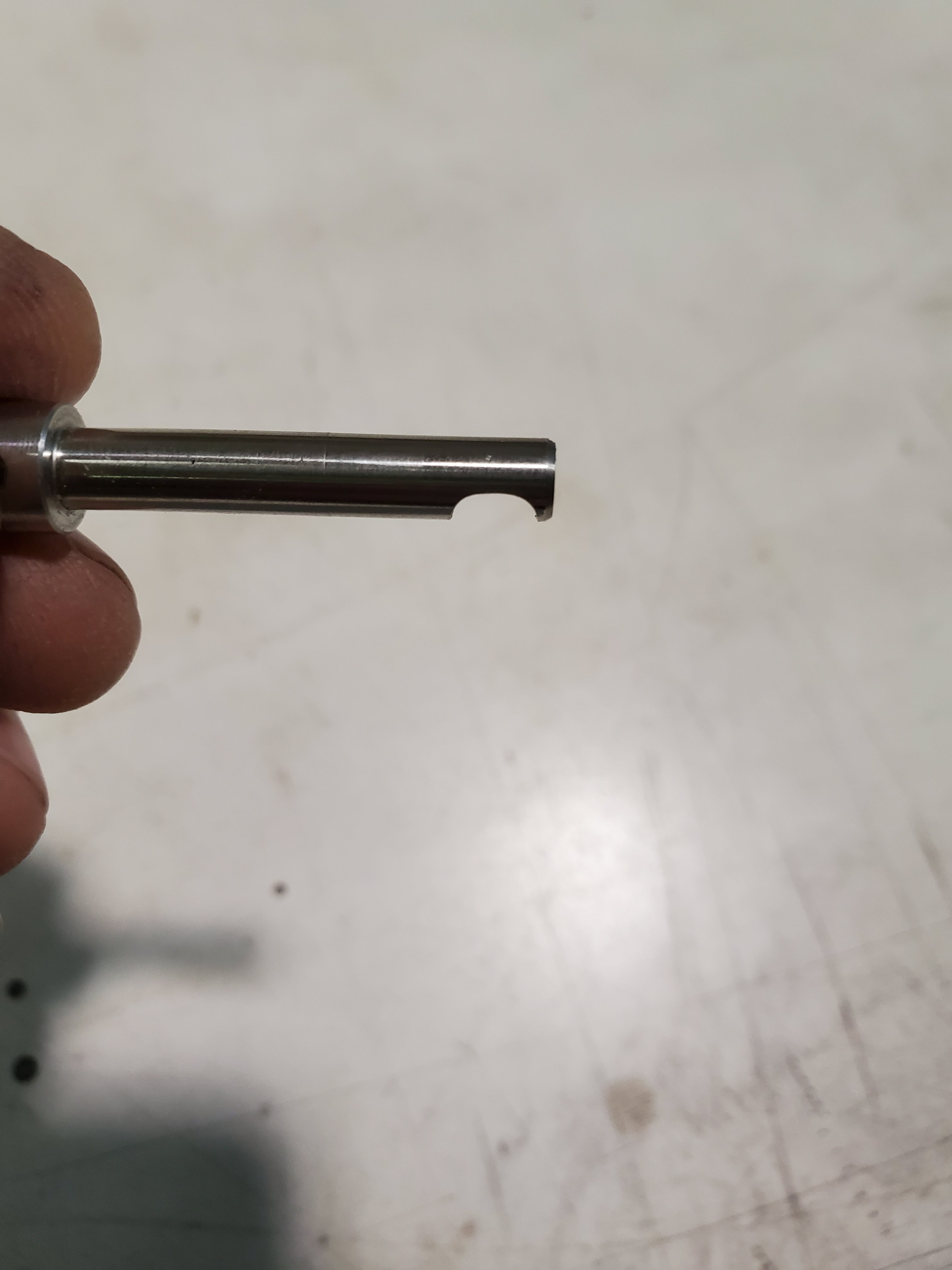

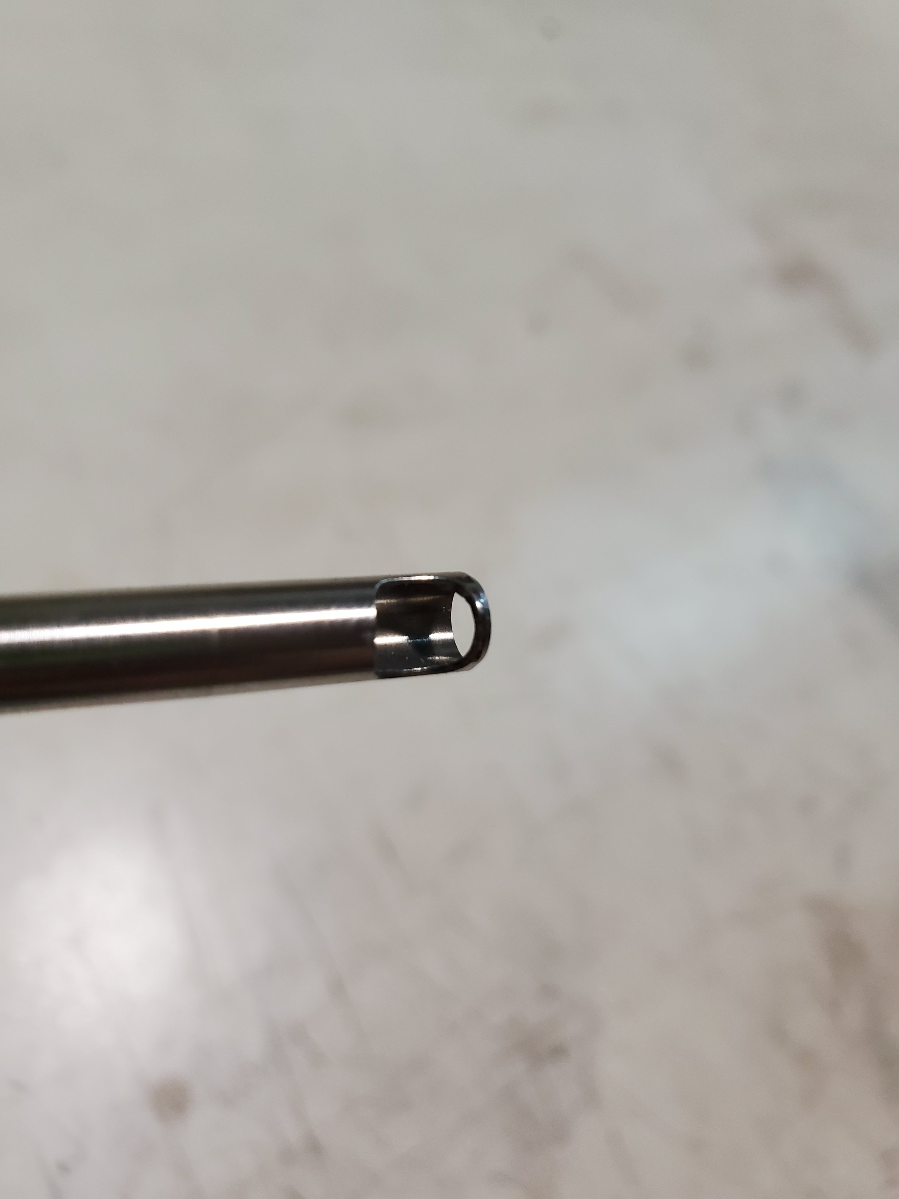

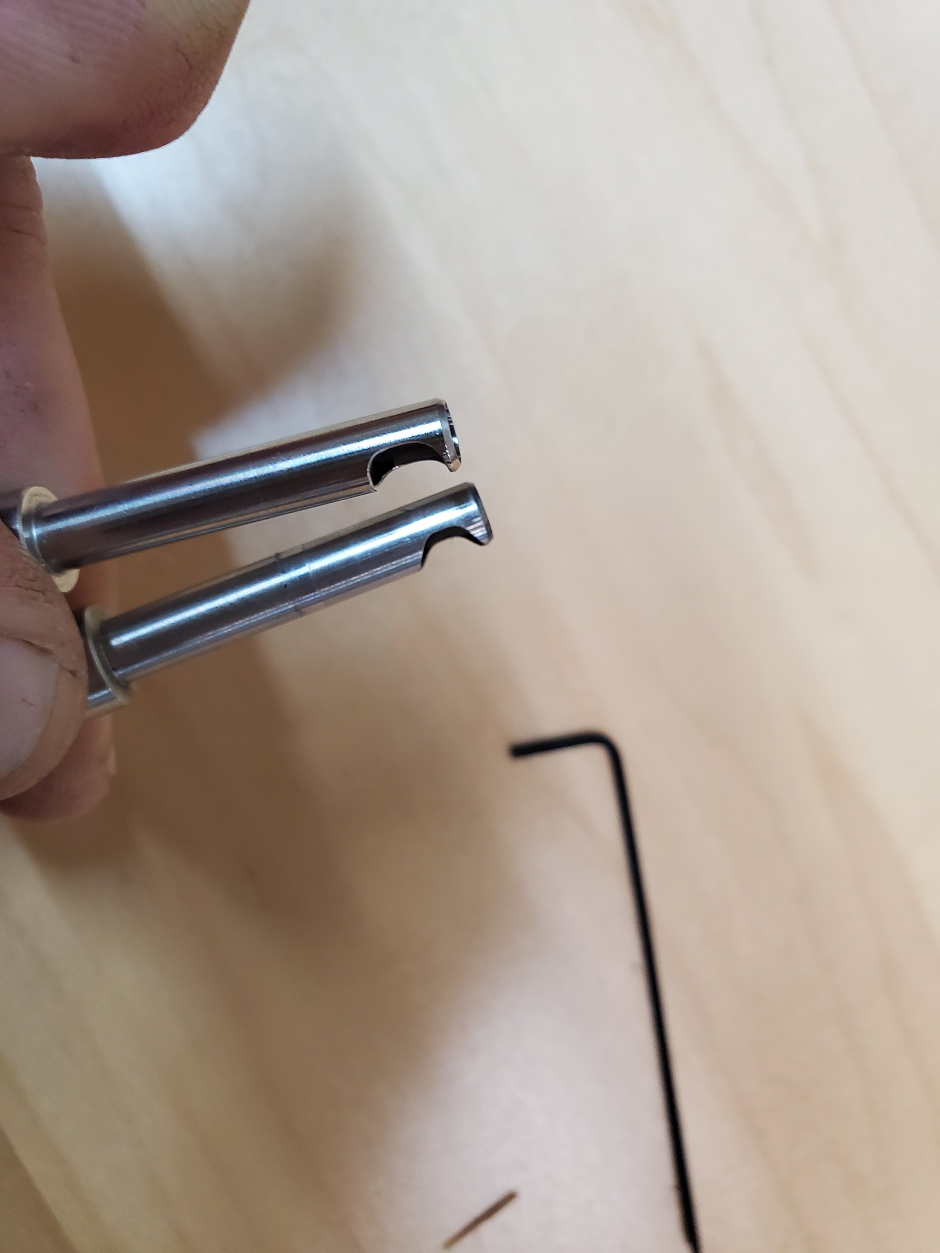

i am done with my dreamline tuning, i put in the high power pellet probe and my fps went down.. so no more tunning- i get 870fps with 45gr hades and thats enough to play with, now its a nice toy..
the huma pellet probe was hanging up on the oring in the barrel so i had to smooth it out, then it worked but no fps increase but 10fps decrease so i dumped it..
i get 1cm groups at 50m and thats enough for this airgun, its enough for me.

i did not gain anything with my high flow pellet probe from huma, i lost speed.. it makes no sense but i did..
i am getting now around 870fps but dropped to 860 after installing it..
so i threw it away
tuning this gun makes no sense at all- when i should see fps increase- i get a decrease, dumb :poop:
not to happy with this gun but it will have to do because i am not getting any more fx
