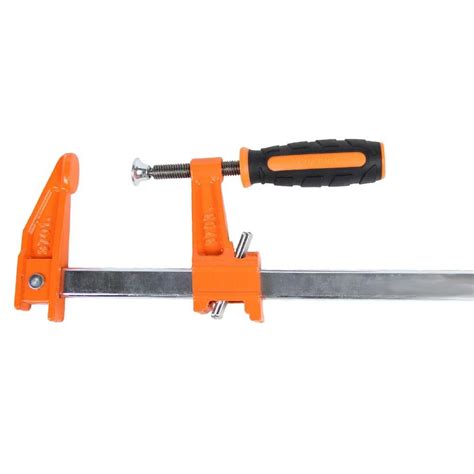

No problem , plenty of dyi ones to look at on forums , I just use a bar clamp.. cheap at harbor freight. Just make sure it's the right length one for the job/ guns ..
I got this one I think 36" on a sale at home Depot ( it comes with rubber pads on the clamp faces unlike the one pictured without them (??)
View attachment 400684 Just look / google up air rifle spring compressor and should be plenty of easy homemade dyi one to review..
