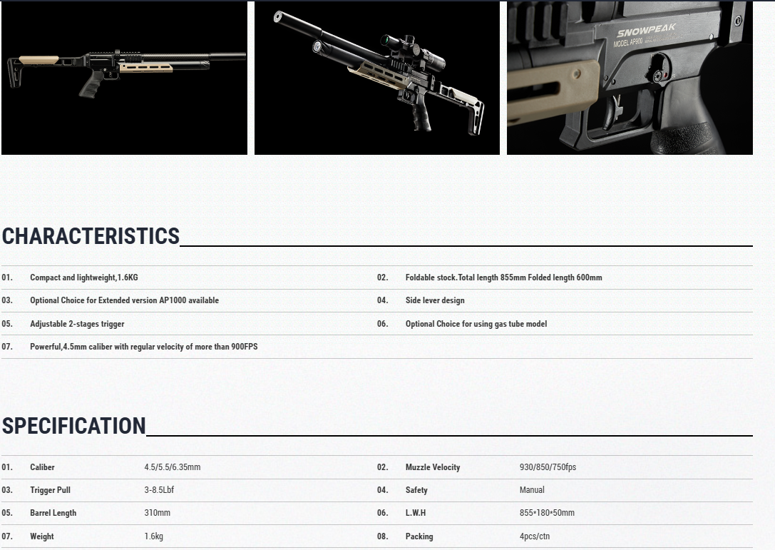

AP1000 and AP900 compact and lightweight.
