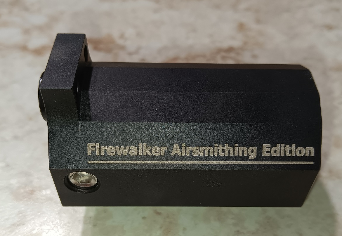

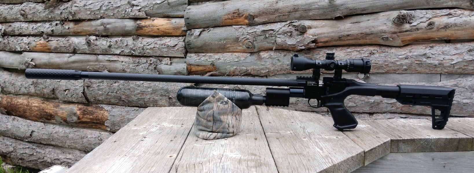

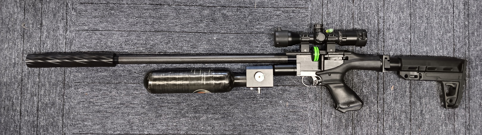

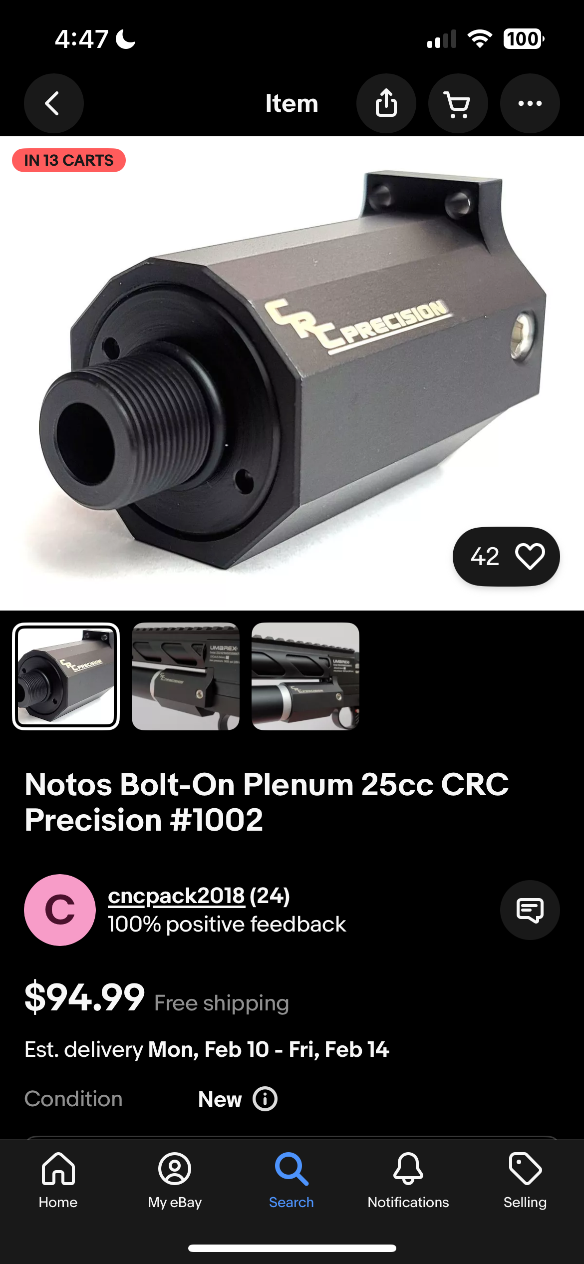

Curious if anyone has seen or tried this new Notos plenum yet. I went on eBay looking for the 15cc tube plenum hoping for a little increase in power and saw this one that I haven’t seen before. 25cc and claims to add 60-100 fps. I was hoping for a little more power on the Notos and hope this gets me closer to 800fps. Currently shooting 725fps (18.5fpe) with 15.89g Hades. If this can get me into the low 20s I’d be pretty happy.
