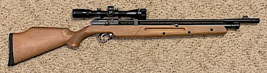

FWIW, I turned 70 on 9/11, Brother Geez. More importantly, I've owned and tested over 500 airguns of all kinds. That includes my .22 Dragonfly.
So to start, I disagree with anyone attempting to steer you away from a Dragonfly despite you making it clear in your original post that's what you seek information about. That's a common affliction in humans, especially on forums.
Yes, a .22 Dragonfly is an excellent choice for backyard plinking and occasional hunting. As recoilless as a PCP, it is much easier to shoot well, especially from multiple positions and rests, than cheap springers. And considering you're new to airguns, I wouldn't recommend buying used (even a Sheridan).
As taken from my testing, here's some information you can actually use-
.22 Seneca Dragonfly MK2 multi-stroke pneumatic repeater
15.9gr FX, 4 pumps, 3 shots- Low= 510, Hi= 515, ES= 5, SD= 3, Average= 513 FPS/9.3 Foot pounds
15.9gr FX, 6 pumps, 3 shots- 576, 579, 3, 2, 577/11.8
15.9gr FX, 8 pumps, 3 shots- 614, 621, 7, 4, 618/13.5
15.9gr FX, 10 pumps, 4 shots 638, 648, 10, 5, 644/14.6
15.9gr FX, 12 pumps, 4 shots 661, 666, 5, 3, 664/15.6
5/13/23- Six consecutive three-shot groups at 50 yards on 11 pump strokes averaged .68” center-to-center.
