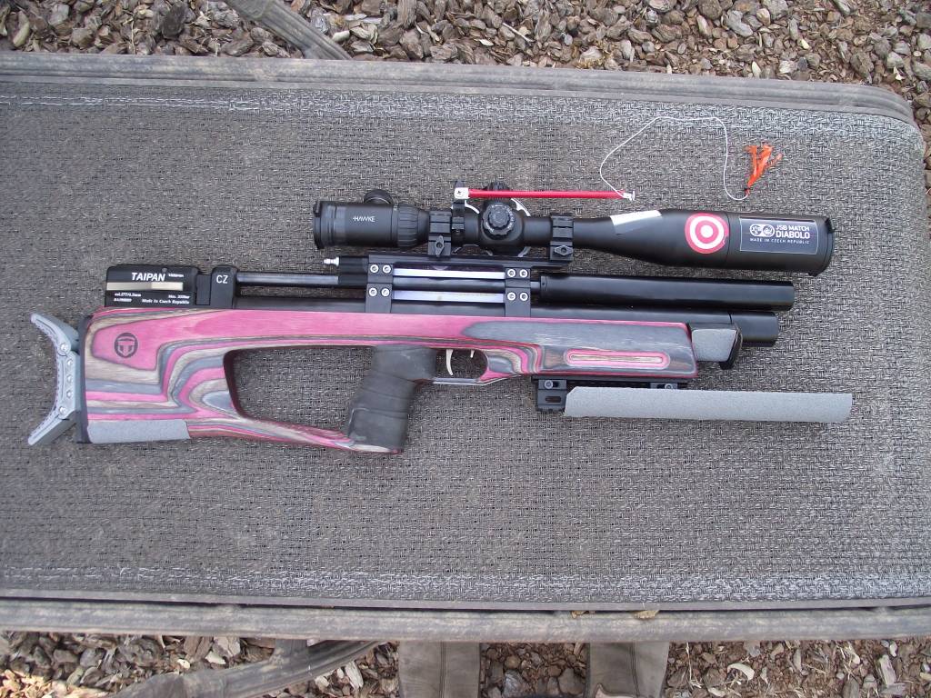

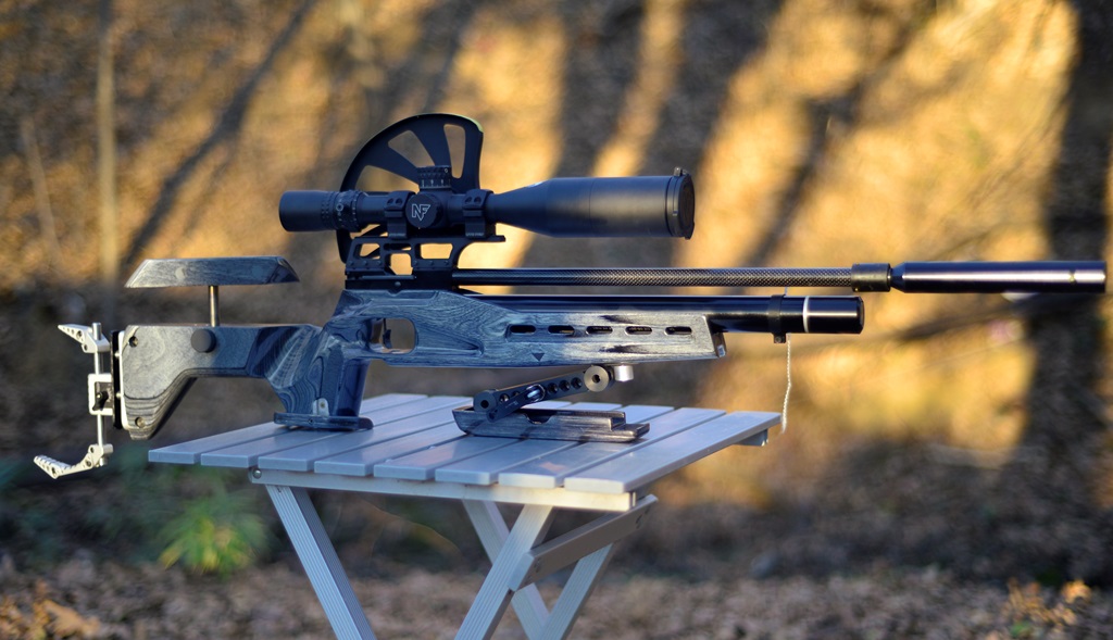

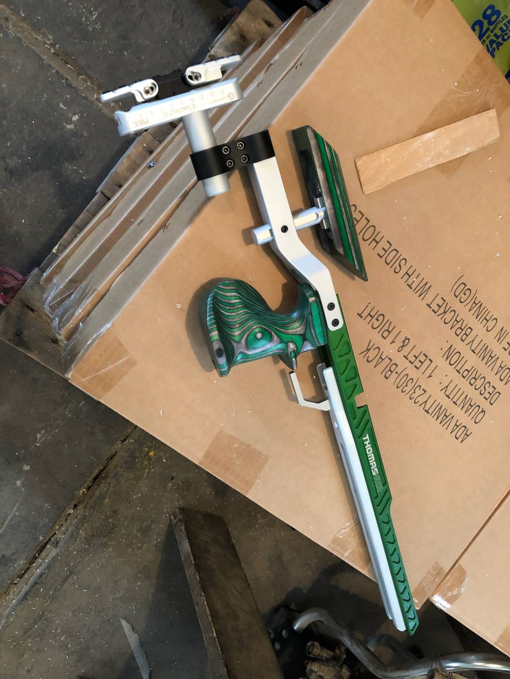

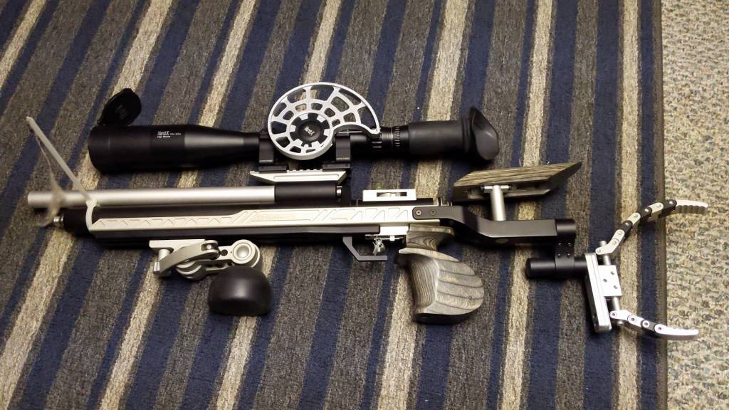

I wanted to take this opportunity to introduce my new custom FT air rifle. If you have one share it over here so that we can all learn from your setup. Tell us what it is and how does it shoot.
The air rifle shown below is a Tau Brno MK300. But I have done a lot of work on it to suit my ergonomics. The original air rifle looks nothing like this. I put this together for WFTF. So far it shoots very well and it is very comfortable to shoot. Have not taken it to a match yet as I have been working on it for the last 5 months.

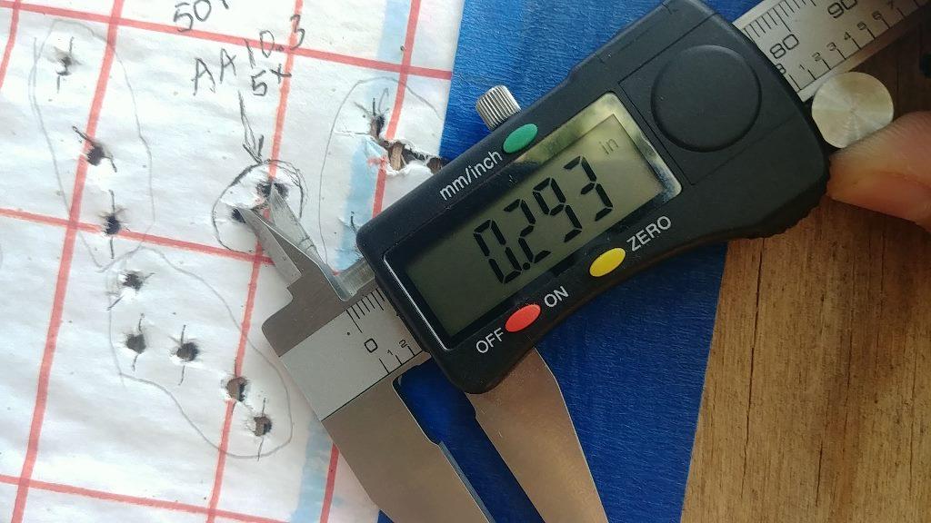

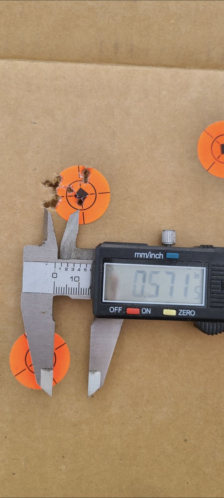

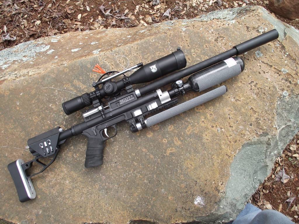

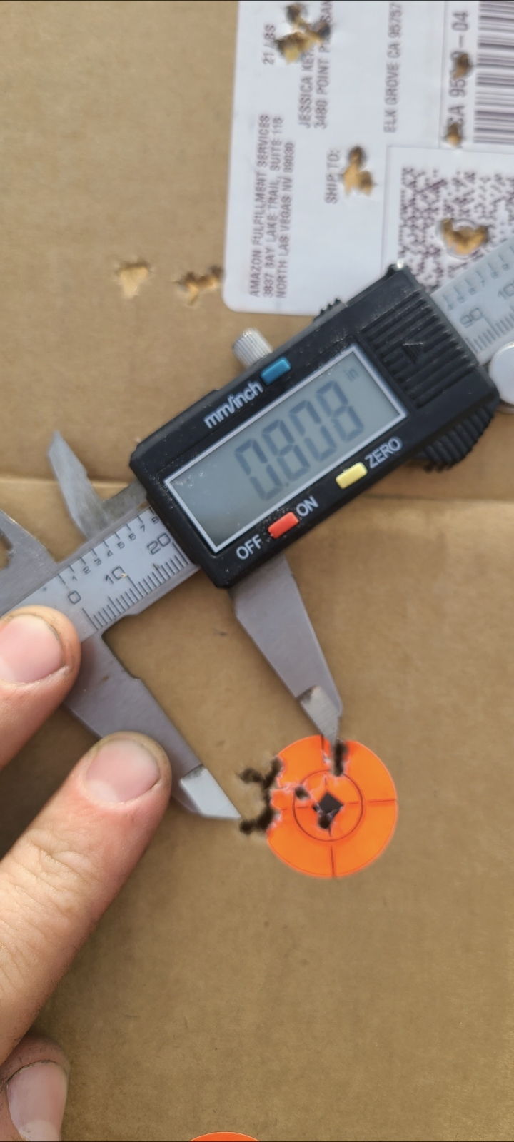

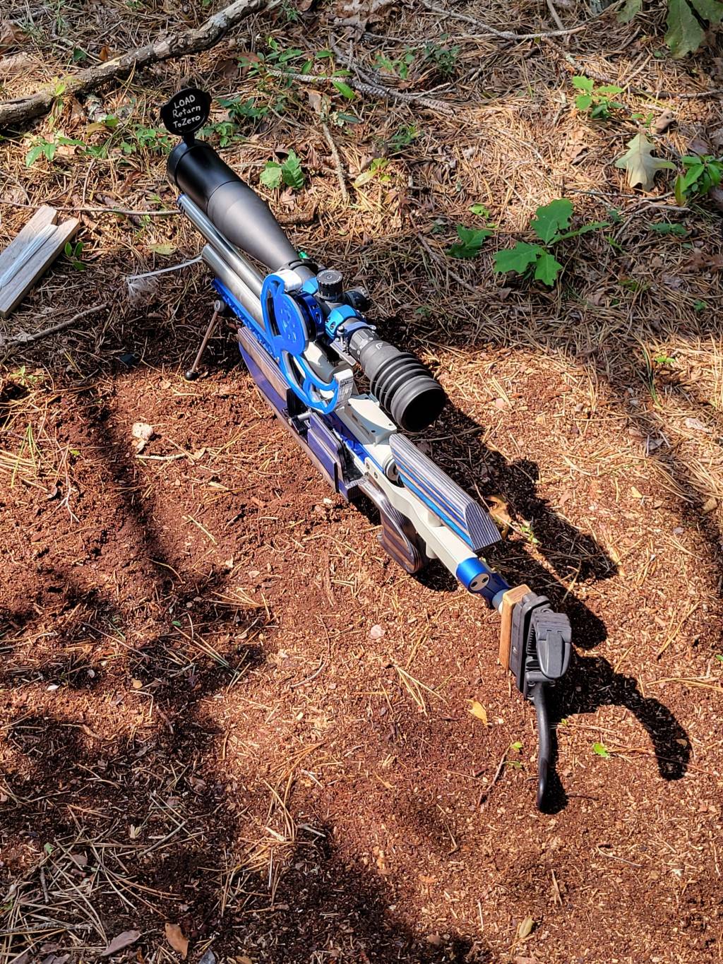

Well I'll jump on the Thomas Train 🚂🚃🚃 with John and tell you about my Thomas FT Carbine. Mines setup for Open Class FT shooting 13.4 monsters at 19ft lbs. I've owned this rifle for 3 years now and has never given me a problem. This machine will consistently shoot 1/4"-3/8" 5 shot groups at 50 yds off the bumbag. I recently sent it to Jason Neal to have it checked over,resealed and.the regulator rebuilt and Jason said this about it. " ..a real 50 yard aspirin assassin with the Beasts you included. No joke, this ~1/4" (0.5 MoA) was the first attempt at grouping after the rebuild.
A great rifle quality made by a real perfectionist Mike Niksch. Now getting one of his rifles is even faster due to his new dealers/tuner network.

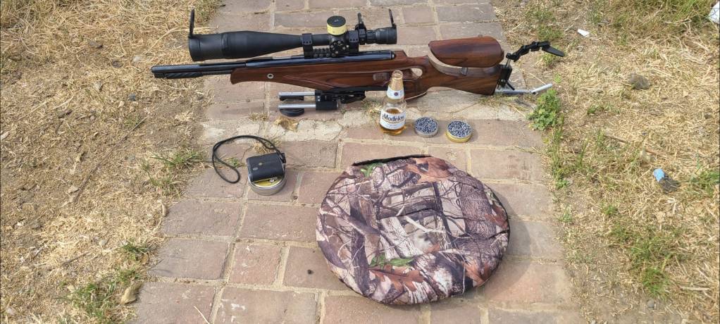

No piston love!

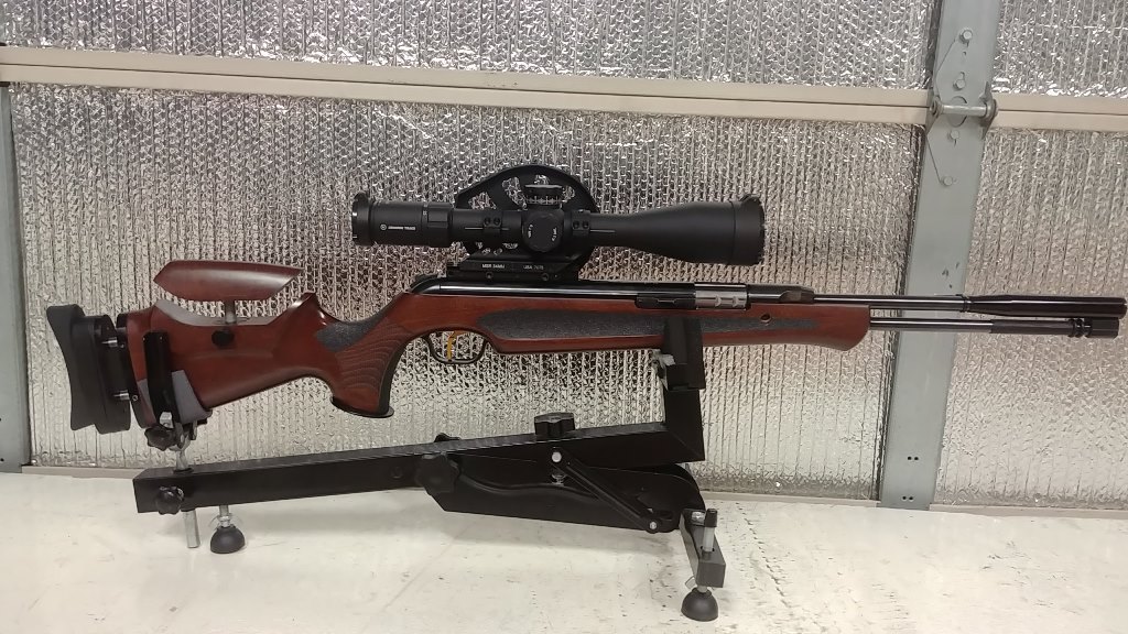

TX200HC
GINB Stock
Sub MOA Systems Buttplate and Hamster
Custom Carbon fiber Cocking extension and Custom Cocking aid (not in this pic)
Falcon X50 Scope Mounted on Burris XTR Signature rings with my own Sidewheel design.
My own Guide/ tophat w/ a 0.118" Wire 0.78" od 27 coil (+-1 coil can't fully remember)
22mm piston w/ sleeved comp tube

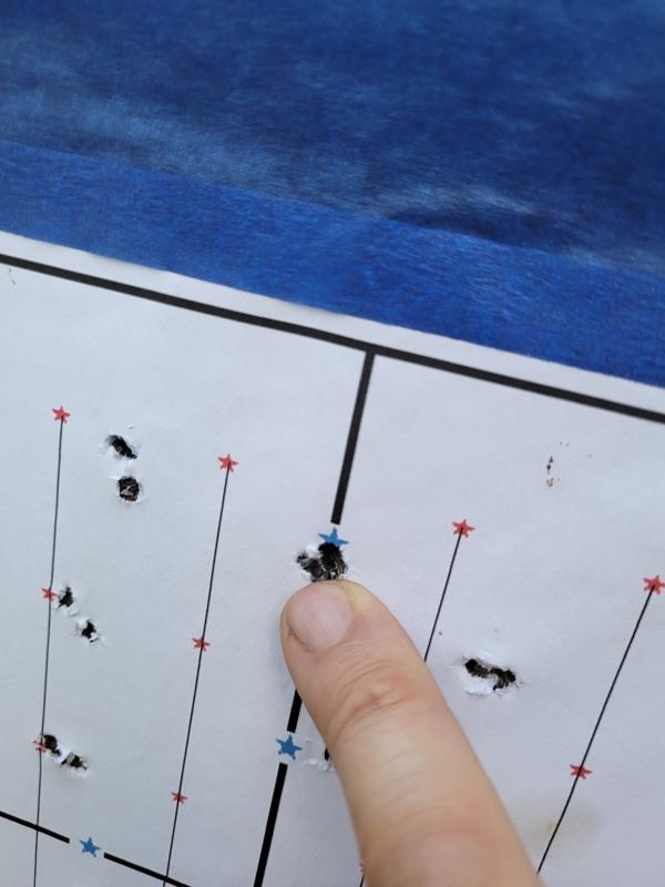

Shoots 8.44gr at 12fpe.

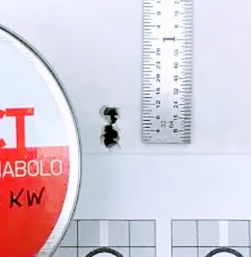

55y group in FT position 12 shots right to left wind.
Nice shooting Cameron! Is that a Tony Leach 22mm conversion?
