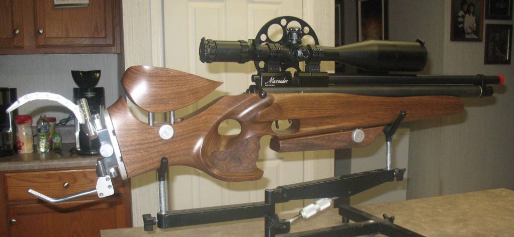

I built this Gen1 Marauder for use in WFTF. My Marauder has a custom Gary Cane stock, and many other mods. The scope shown in this image has been replaced by a Falcon X50 10-50X60, so I should really get an updated image uploaded. My WFTF days are on hold, as I am now in need of total knee replacement in both knees...

Not a weight limit on the rifle setup If you can lift it and be steady with it for standing shots, that is all you need. Generally heavier can help with stability, but the tradeoff is on your ability to handle it. Some people like their rifles light and others on the heavy side. Typical weight ranges with optics and other accessories from 8 lbs to 15+ lbs depending if it is a PCP, springer, smal, large, heavy scope etc.
Nice stock. I do not shoot FT but I do shoot Metallic Silhouette for air rifles. Not many FT matches around here. Is there a weight limit on these air rifles?

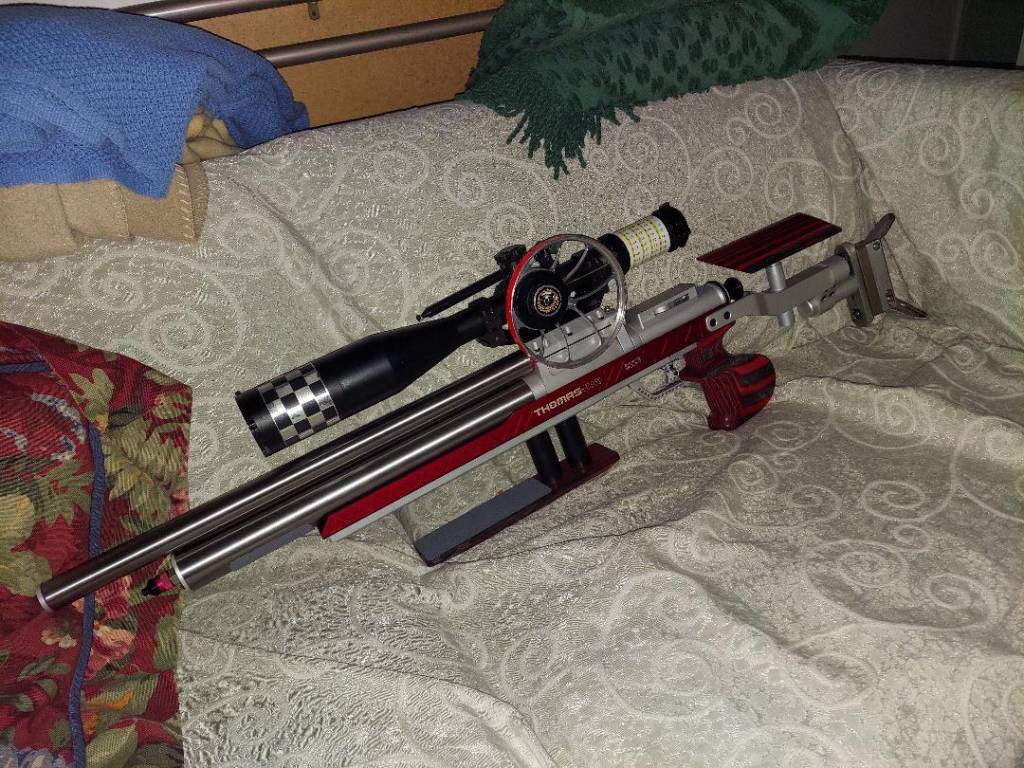

I got my Thomas FT built by Mike N and received it 11 days ago which I used last weekend in the Sonoran Desert match. As far as a rifle for offhand I haven't come across a rifle that I've shot so well before, this includes 3 Olympic match rifles I've owned. Even in a match setting with nerves making me less steady or sure than I would be normally I was able to get 15/16 of the positional targets which for me and my ability level is more than I could have ever wished for! Kneeling is very uncomfortable to me so I shot those lanes offhand as default.
I don't like the forward weight bias on a gun for offhand but rather the balance of the gun being directly above my non dominant hand and this Thomas is right there. Also the weight of the rifle is near perfect for me because I find if a rifle is too heavy I fatigue quick and if its too light its not stable enough. Well half the reason I bought this rifle was hoping it'd increase my offhand comfort and scores and it certainly has done that.
It sure shoots awesome too! Often when I'd see where my miss went it'd be a spit at 9 or 3 o'clock!
