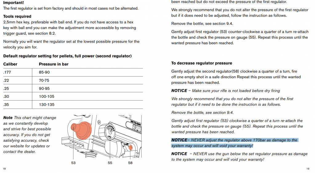

Here is a part of the manual:
It says that "The first regulator is set from factory and should in most cases not be altered". It seems mine came at 190bar? Should I remove the bottle and set it lower to around 150 bar?
2) "Never adjust the regulator above 170bar as damage to the system may occur and will void your warranty". Are they talking about the first regulator or the second one?

1) What is the pressure in the air tank? Unfortunately there have been cases in the new M3 where the front regulator (#1) is creeping up, sometimes to the point where it matches the bottle pressure. When you dry fire a few shots, does Reg #1 pressure settle down to a lower value? As one data point, when I received my M3 .30 cal Reg#1=165 and Reg#2=114.
2) I believe both regulators have this limit.
3) Refers to the Reg#2 set point.
4) It is always safest to remove air from the gun (and the plenum) when adjusting the regulator down, but not necessary. FX says you can turn the regs down by 1/4 turn and dry fire a few shots. Instead, be safer to your reg and only adjust it down 1/8 turn, then dry fire 2-3 shots, and repeat as necessary. Removing air from the gun and plenum is best when making large regulator adjustments (down). When gun is de-aired you can turn it way down, below your ultimate goal. Re-attach the bottle, dry fire a couple shots to let the regs settle, and then just increase the reg pressure at will to your chosen point.
Just don't try to turn reg pressure down too far in one action (between dry firing), and you will be fine, and won't damage your reg.

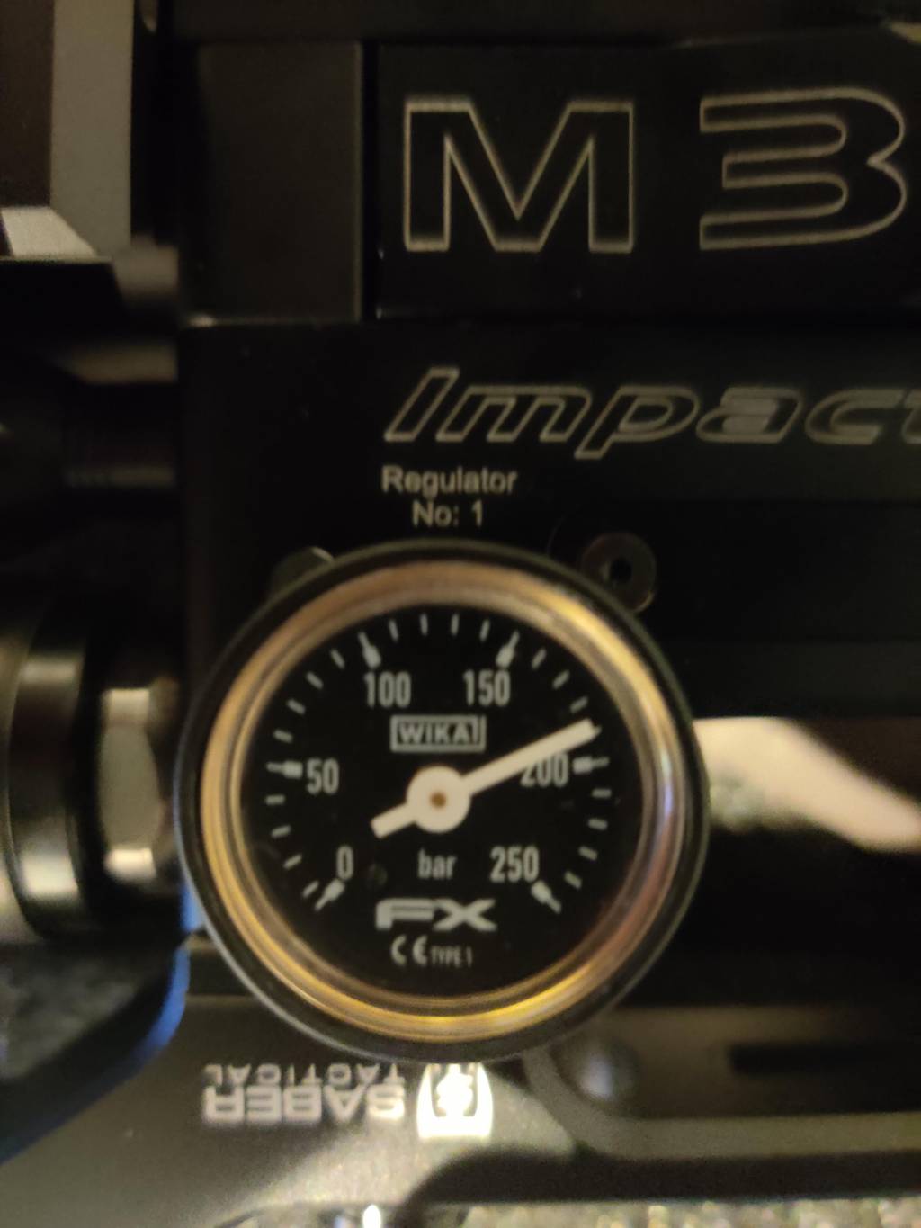

About (1. The air tank sits around ~210 bar. I dry fired 5 shots, the Regulator No1 went down to about 165-168 after 2 shots, fired 3 more to make sure:
Is there any reason to be concerned that the reg no1 is creeping up? I do have to mention that the rifle has been sitting in the case for about a week.
I'm glad that your Reg#1 went down to a more normal value after dry firing. Yes, there is reason to at least monitor Reg#1 pressure. Perhaps what you originally saw was just due to the new regulator breaking in. Or perhaps you have an issue with your Reg#1. It really should not creep up after sitting, even for a week or so. If it continues to do so, you should contact your dealer or FX about a warranty repair.
It is not that Reg#1 creeping up should cause any damage or any poorer shooting performance. That is still mostly based on the performance of Reg#2. But the whole idea of the 2 regs in the M3's is to 'protect' Reg#2 from high pressures, and thereby prolong its life and reduce its potential for creeping.
