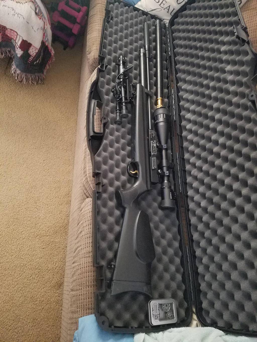

That's a 50 mm scope! It is longer than your pistol and a 6x24 power will have a lot of trouble focusing on a 10 yard target at anything higher than the 6x power! I have this exact scope (under the TwoD name) and it is a great cheap scope but it is on my Hatsan AT44 rifle. The scope is almost 16" long! Here is a crappy pic for reference (BTW it is an amazing value in a scope!)

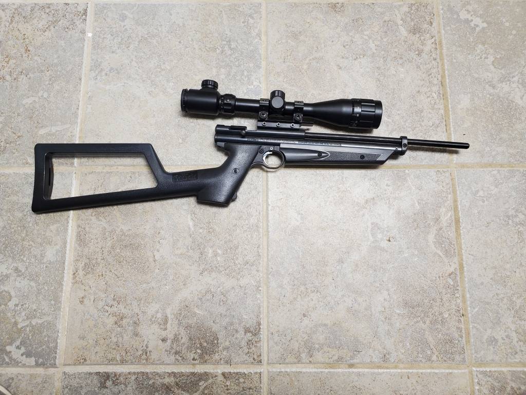

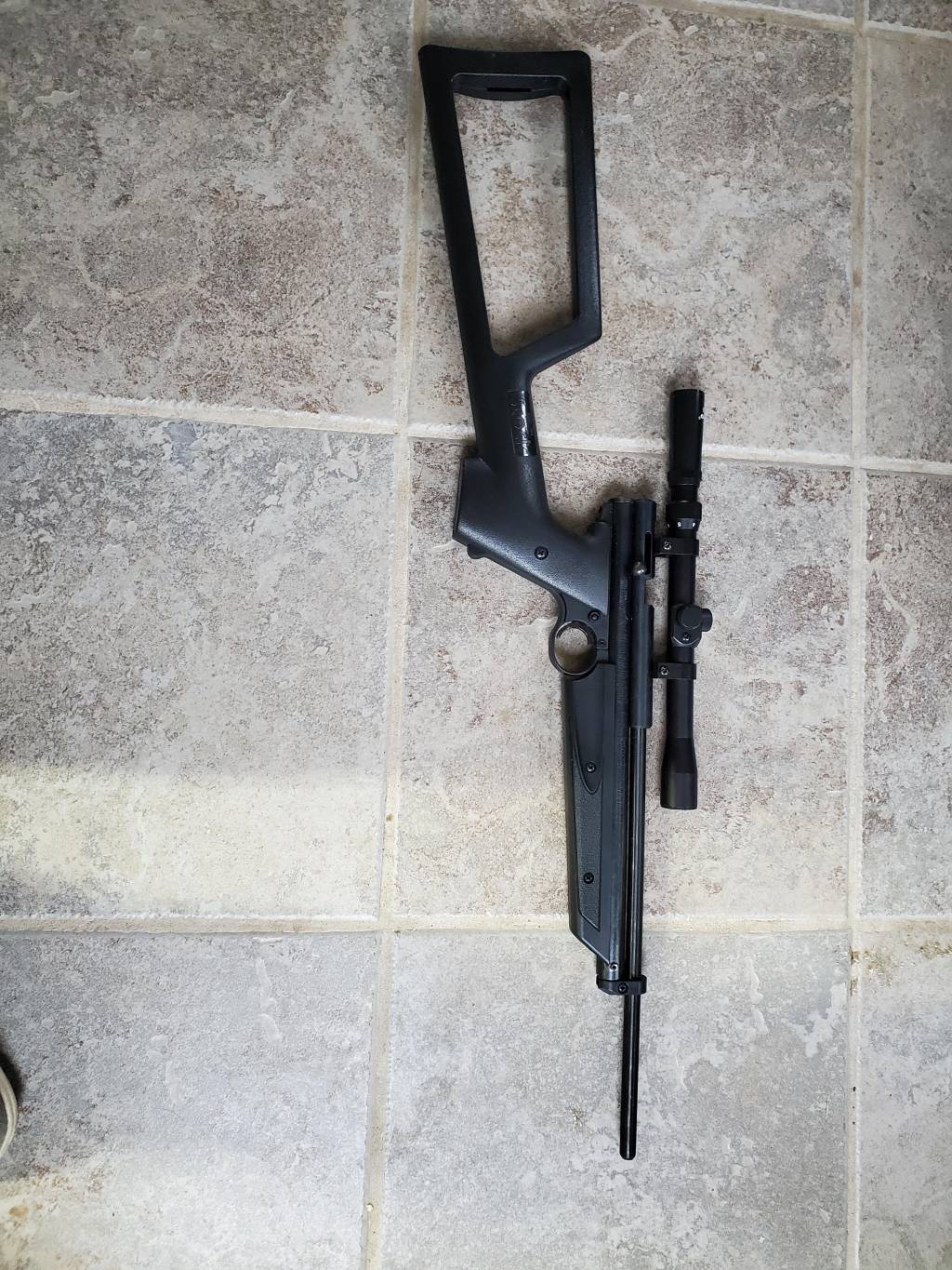

Well I ended up putting the carbine stock on it. I will have to check the scope out when it gets here. If it's too long, I will go with a red dot. Never hurts to have a spare scope around.
Today I installed the 14.5 inch barrel. The steel breech was a super easy install too. Broke a cheap allen wrench off flush with the allen bolt on top of the breech. Ugh!!!
The gun does very well at 18 yards (distance to the feeder that the squirrels are invading). It does 10 shots in dime size groups. Thats plenty good for squirrel head shots.

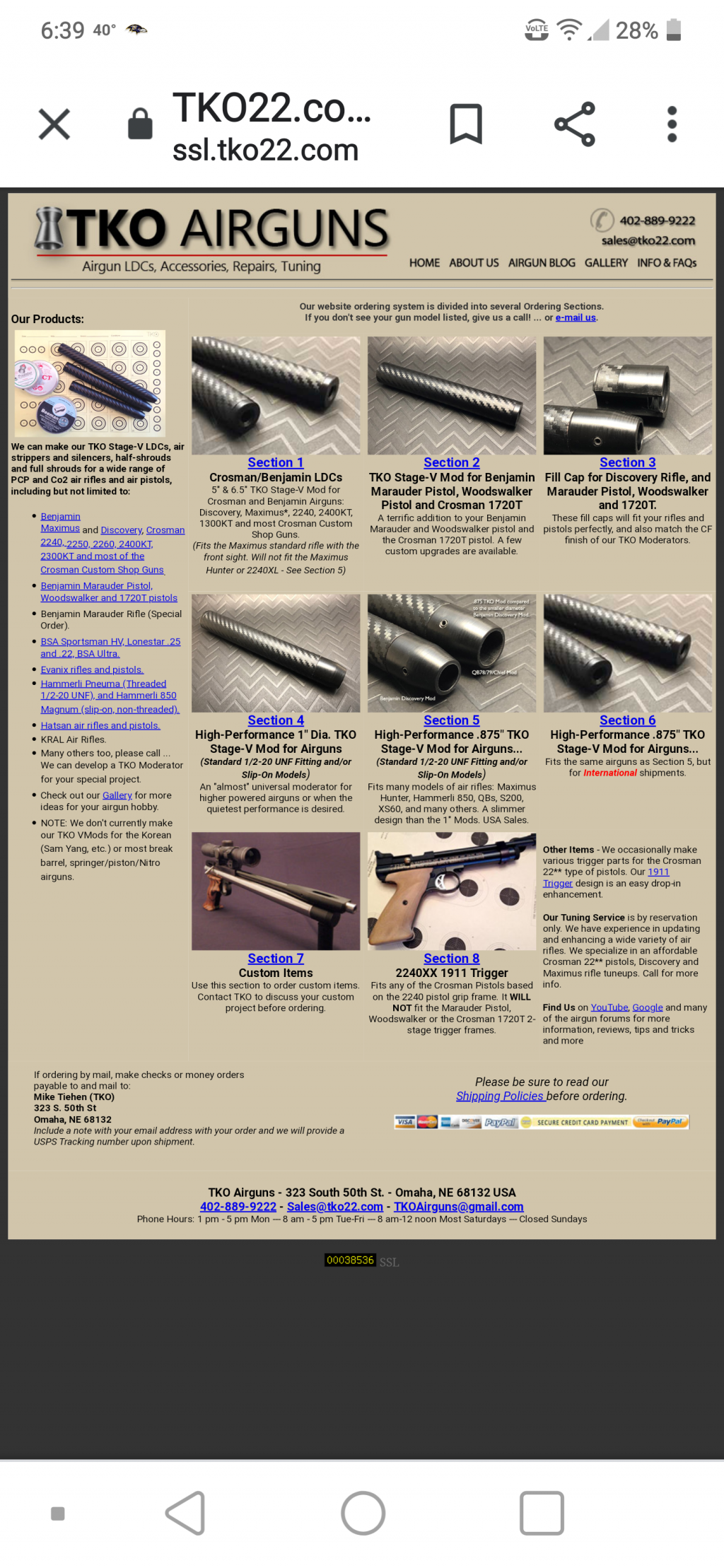

Just need a moderator adaptor for the barrel so I can install an extra DonnyFL Sumo I had laying around. Then I will move on to upgrading the internals to a flat top. It's a fun little gun to shoot.
