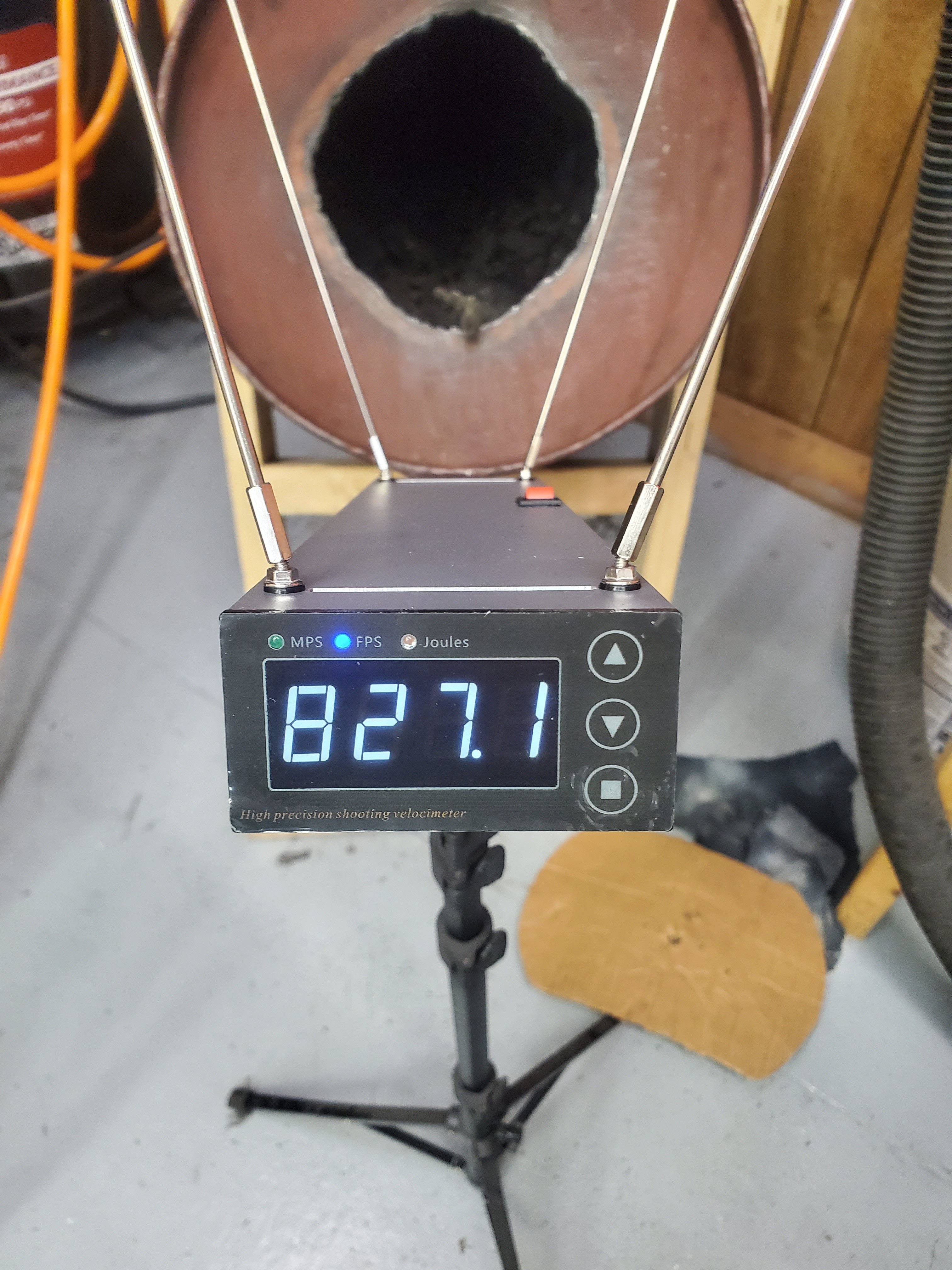

It held air overnight without any leak down. I tried it at 1700psi.

Had little time to work on the airgun today but a friend brought me some 110 grain hard casts for a PB that I tried. Still haven't pinned the valve but I tried a shot with a 2000psi fill which yielded a velocity of 685fps or 115ft lbs of energy. Not too shabby for half charged. I'm already exceeding Umarex Gauntlet 2 energy levels.

What's the shot count going to be like with that tube?
I'm not sure yet. Currently at a 2000psi fill, each shot drops off 500psi but the volume will increase exponentially with the pressure increase at a 4000psi fill so I'd be guessing if I gave you a number. Plus it'll be tunable when I'm done.
