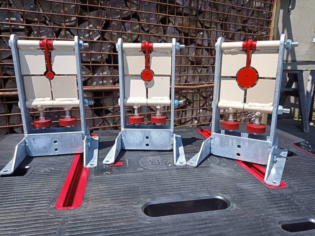

A friend and I made some quad targets. They were a bit of work but it gave us something to do on a covid Sunday last winter. Material costs for 10 sets of 3 targets was about $800 including paint, galvanizing and fasteners. We are selling the extra sets to recoup our costs. We aren't looking at this as a money generator as we just wanted a set for ourselves. My regular job pays a whole lot better per hour than making these lol. Once they are all sold we will have 2 sets of targets worth of profit that will subsidize the next set of targets I'm designing. At the end of the day nobody is going to get rich off these unless they set up proper manufacturing systems and sell a lot of targets. Most of the targets on the market today are light gauge material purely to keep costs down.
I doubt galvanize is really needed, and likely even the threaded fasteners and nuts could be replaced with steel rods welded in. So if thirty targets used $300 in materials, I think a few bucks can be saved there, so maybe $25 per unit vs current almost $ 27 in material?
So it looks like a part can be eliminated (besides the nuts) with full welding also, like one of the crossplates. Still a lot of cutting and welding of close to 20 parts.
But I suspect a decently equipped welding shop can sell them for around. $100 each + shipping if they can take 40 fpe hits without bending.

Galvanizing wasn't necessary but I lucked into a situation where a buddy was sending a large frame to be done so I only had to pay the per lb cost with no minimum charge. The paint and labor would be more money. Likewise with the bolts. You could certainly weld in bar stock. At the same time you must purchase the bar stock, cut it, weld it and clean up the welds and spatter. Painting would also need to be touched up or paint an assembled target. You also give up the ability to remove the paddles for maintenance or clean up. The small cost for a couple bolts and nuts now looks pretty attractive.
There are many ways to design and build something. Each option has its associated pros/cons. Trying to save a penny might cost you a dollar lol.
The different kill zone sizes were intended for FT shooters. I find the more I practice the further I set the targets out. It's nice to have some target size variation but that's just my opinion.
