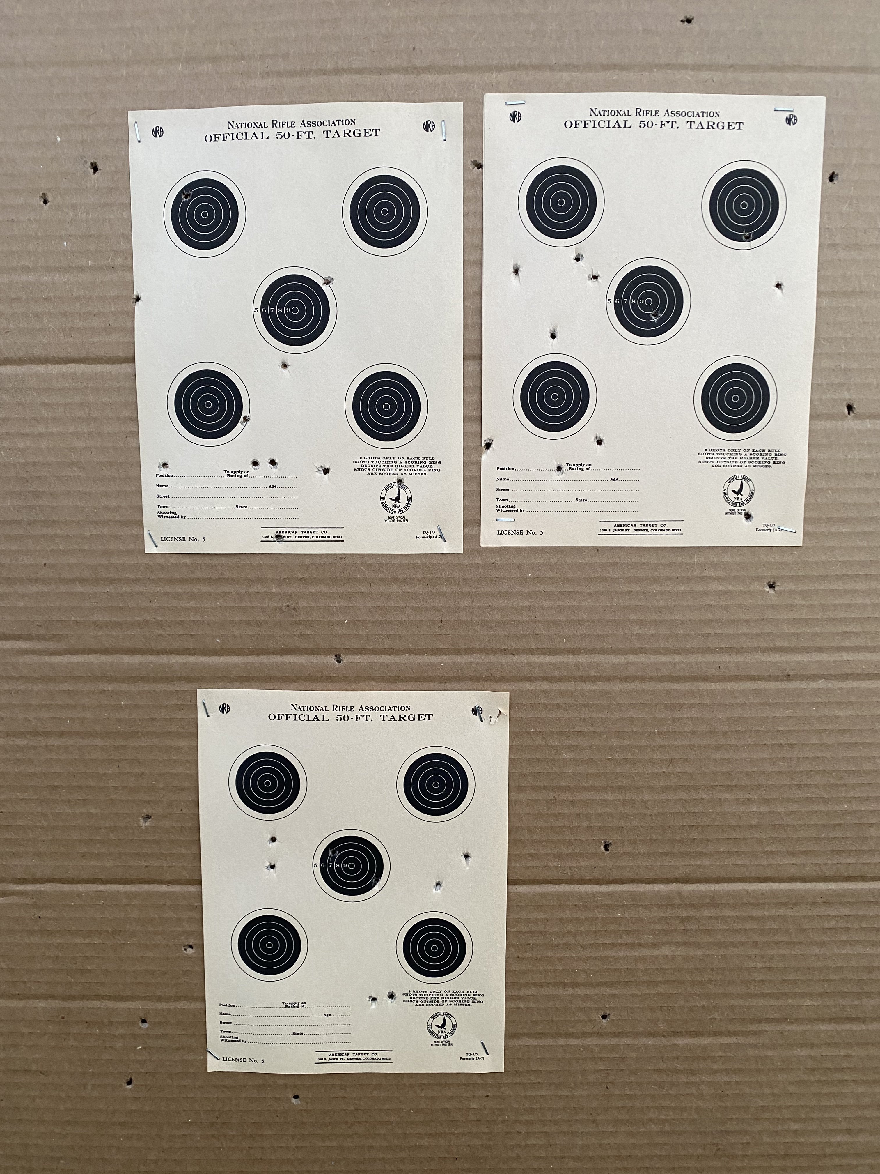

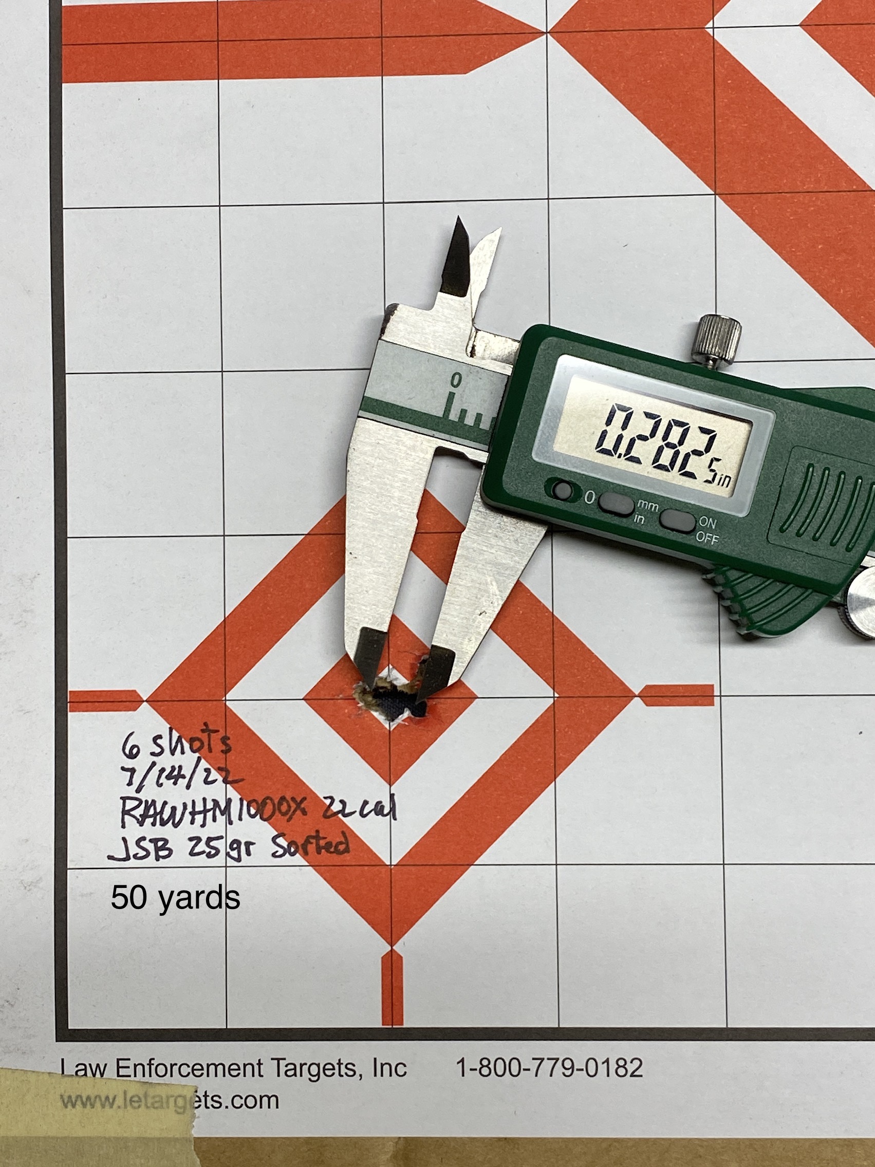

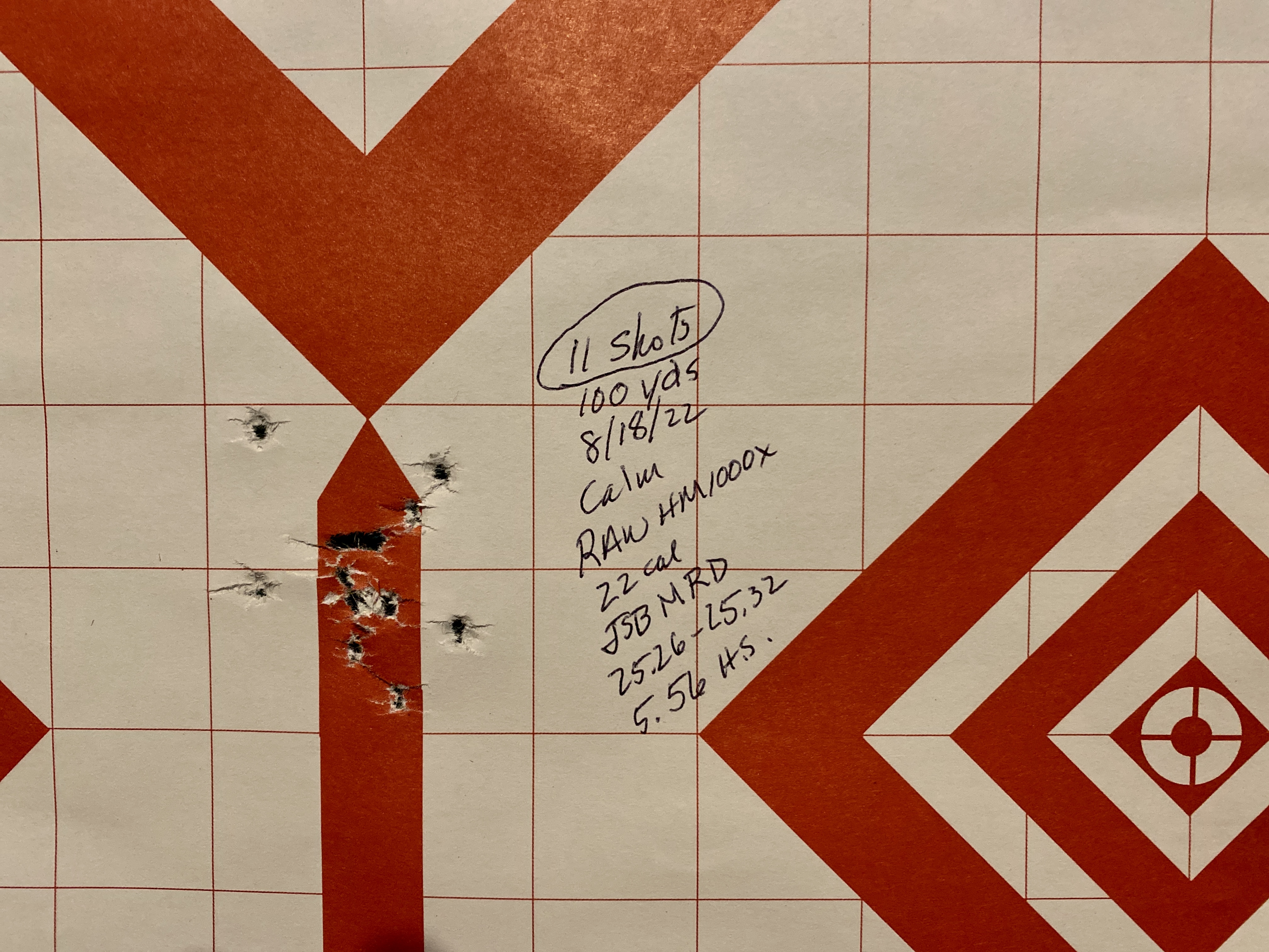

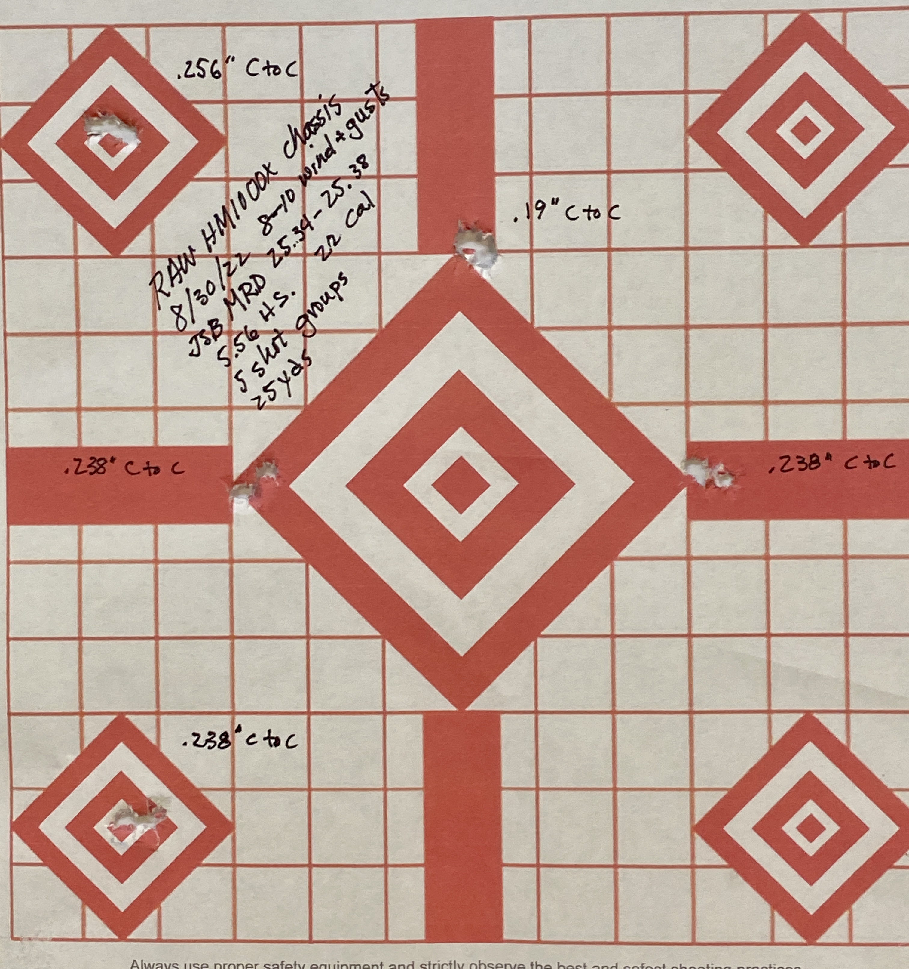

Just to jump in here again, I doubt there is anything going on with the barrel. I wouldn't go scrubbing the barrel if it were mine. I have proven to myself that the RAW needs a moderator if for no other reason than to strip the turbulent air off the pellet as it leaves barrel. That's what the original giant muffler on the older RAWs did. Having said all this, there may be another factor to consider — 22 cal is not at it's best at 100 yards. Start at 25-30 and see what it does with weight sorted and head sorted pellets. Then move to 50 and see what it does. Here are a couple targets to illustrate. First 25 yard with teeny groups then 50 with larger, but still sub moa groups. Lastly 100 yards. These were shot on different days, but all under ideal wind and weather conditions.
This is excellent advice. I think the OP's solution will be in pellet selection and tuning. And yes, shooting at 25-30 yards is an easy and good way to get feel for the performance. Shooting pellets at 100 yards is a challenge for sure, but if you have the pellet and tuning combination that shoots tiny one-hole groups at 25 yards, you can be almost certain that nothing is wrong with the barrel or rifle.
