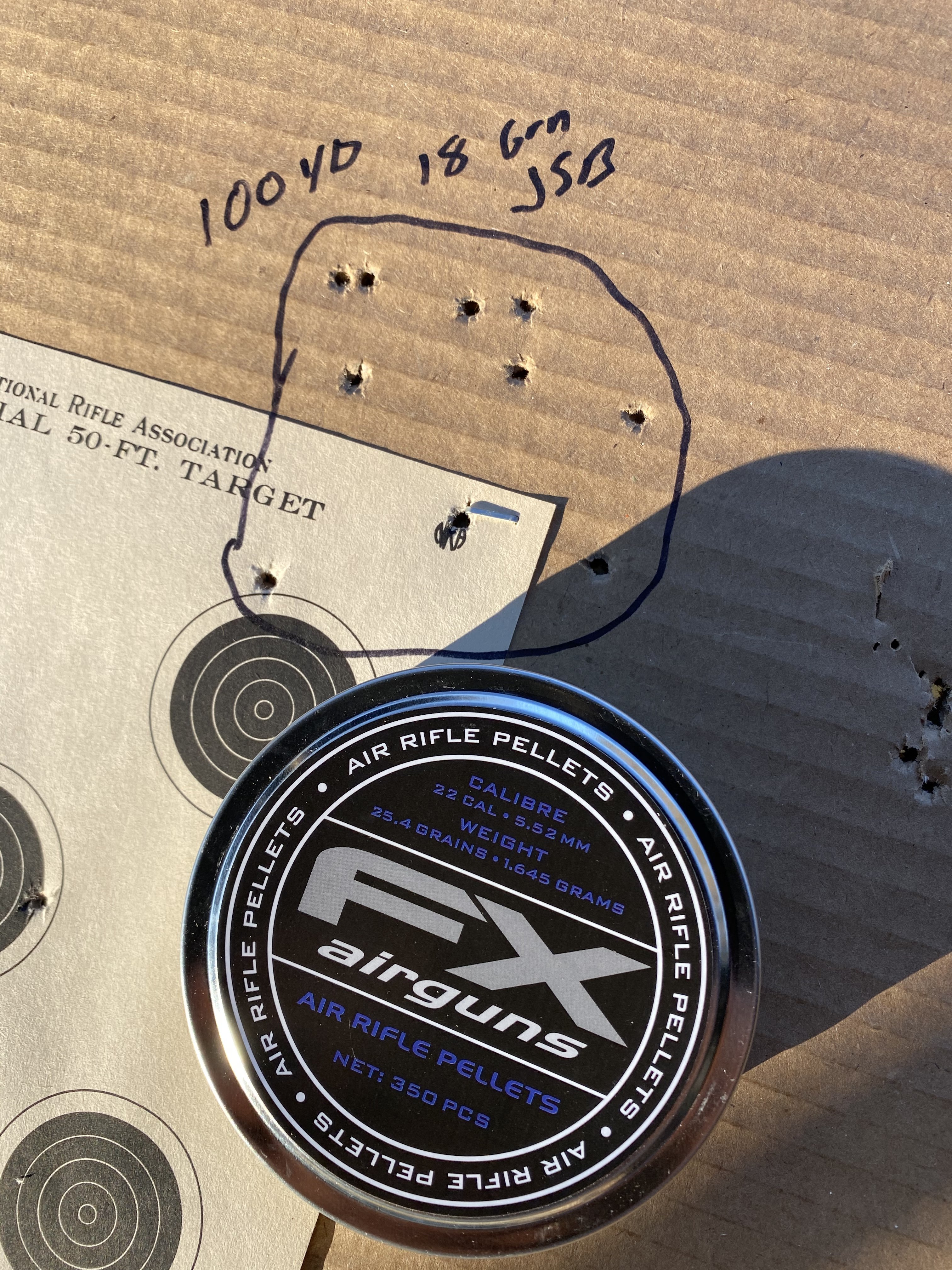

I did try some 18 grn jsb — they are running around 1060 fps as set up — actually was decent. Pic to follow.

Before you shoot the Redesigns by JSB or FX, make sure to sort them by head size and weight to see what your barrel prefers, or you will get fliers. Nice group with the 18gr @ 100. On the same tune, you might want to try some 20-23gr slugs, my barrel likes .2175 diameter, yours might be different, many options to try.

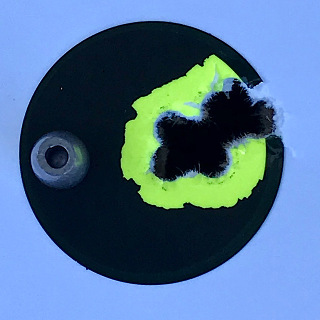

Here are 2 different groups touching each other, dialed a few left then a couple down, this is @ 30yds (these slugs POI is higher than pellets (@ same POI) even though they are traveling a tad slower, shows how a slugs BC is so much better than a pellets. Shoot them on the same tune as the JSB 18gr pellets, slugs @ 935-ish and pellets @ 950-ish. If any slugs in the tin go into the breech without much resistance, that slug will 98% of the time be a FLIER and will not group worth a darn, only snug fitting slugs (in a non choked barrel) group well. Shots were taken quickly just to see if they would group. Can clean up accuracy with more tuning with speed but I only shoot slugs for pesting and have taken ground squirrels out to close to 120yds with this tune and slugs/pellets.
