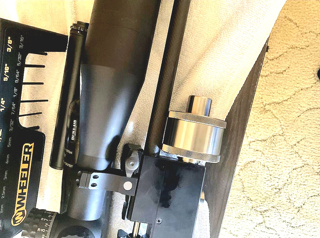

I took off the stock on the newest version of the HM1000X ..... it also doesn't have a bottom blanking plug?
This makes it more difficult to add additional plenum space to the 30cc OEM platform? Mubhaur's Mod is kaput ..........
I also used the bottom blanking pug to install a regulator testing gauge.
Well, one more new version and Martin's initial creation might be DOA :p.
Large inline plenums are possible with after market stock
Yeah Mubhaur,
I'm going to pass on all the in-line and other plenums for the RAW …. for now.
Unless shooting slugs is critical in .25 calibers or larger.

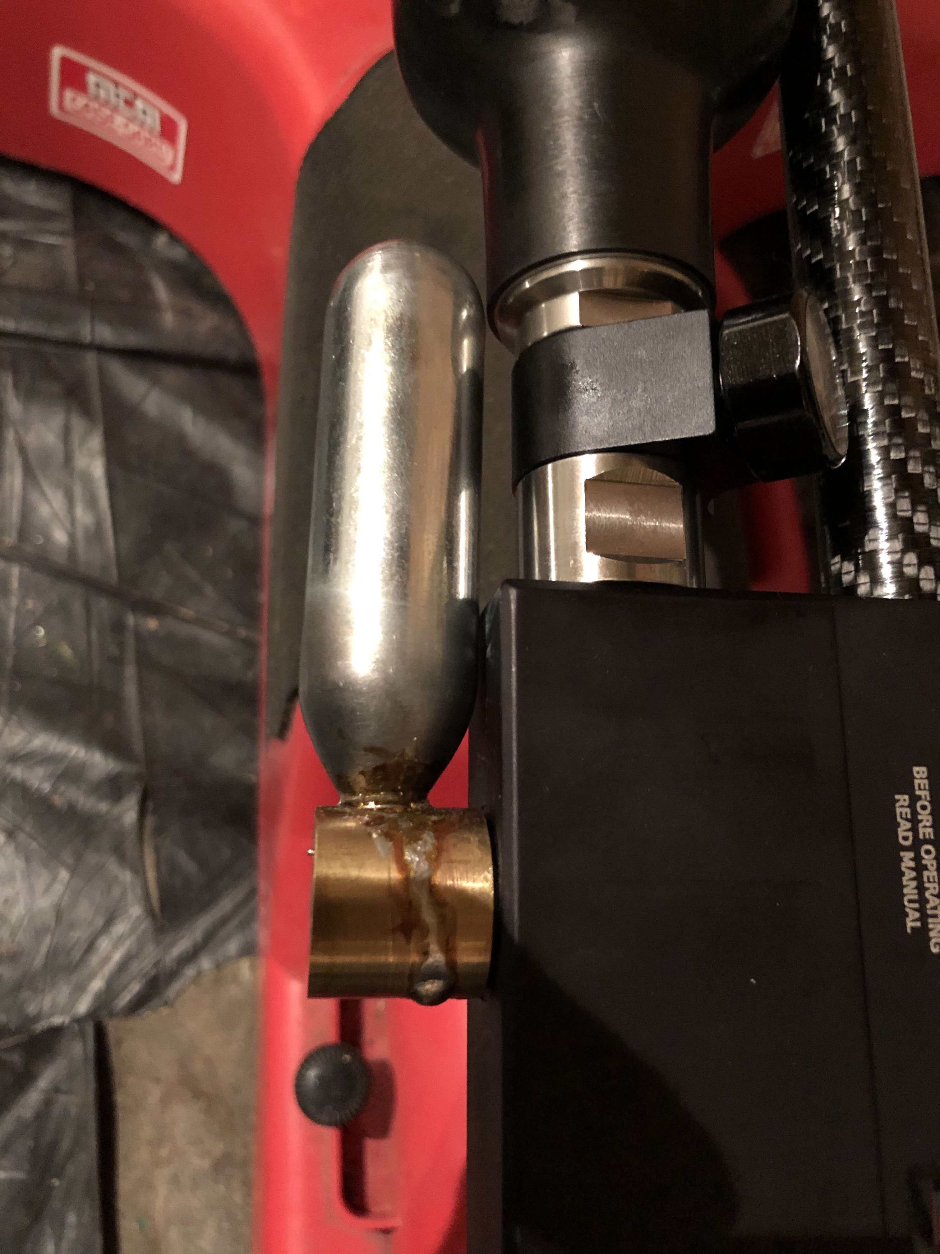

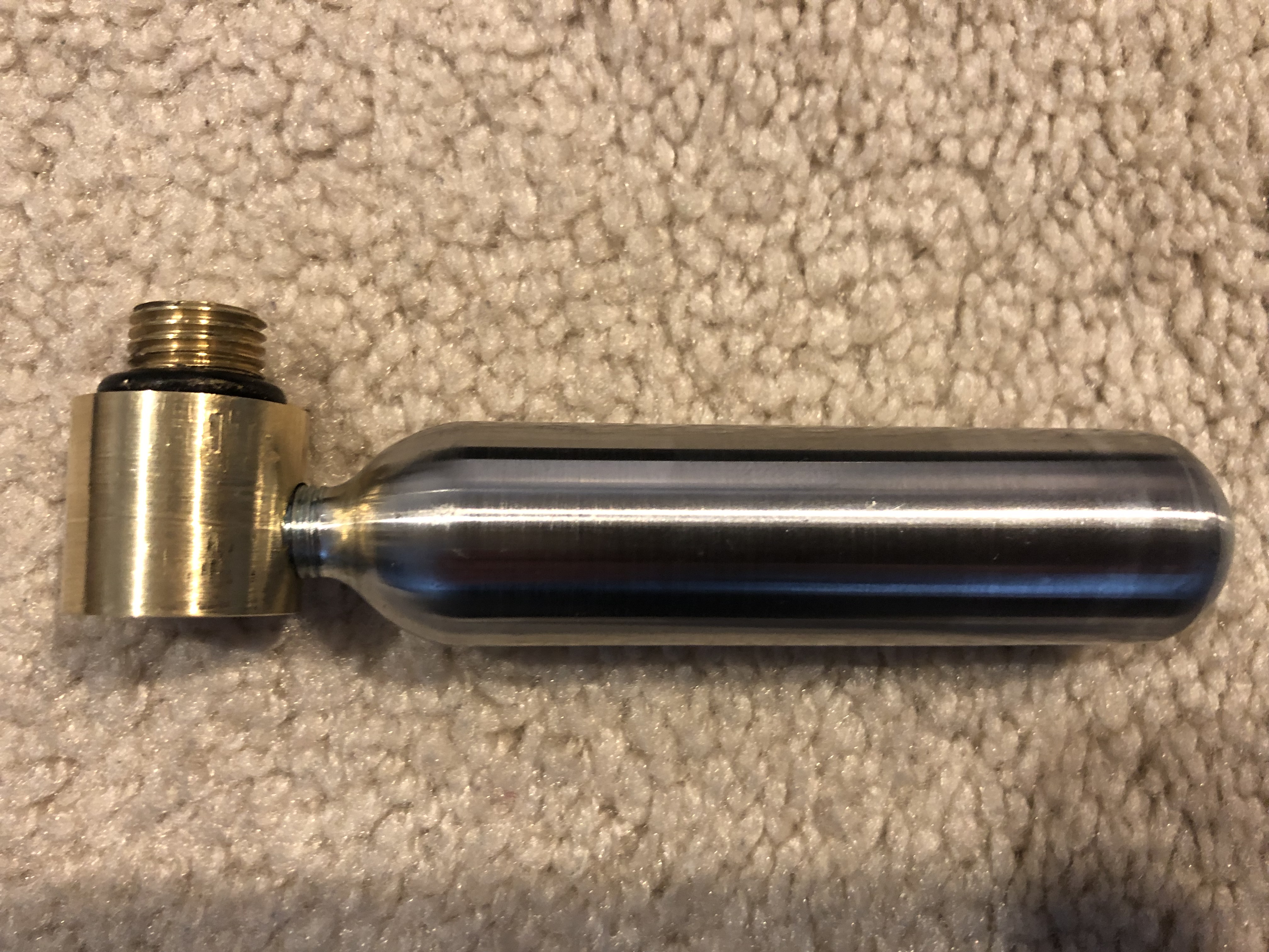

I've got my "home made plenum" for my .25 cal RAW witch gives me about 50+cc's of space.
I really haven't found the need for a larger plenum in .22 cal. or lower - yet :unsure:.
