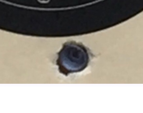

New RAW TM1000x - first range outing
Keith
If you look closely at the 40Y groups ( #4 and #5 ) in the picture, they did open up at the end. Also, I shot a bunch of 30y groups that I did not show, and they were just ok. Not great. I would get a flier about every 8-9 shots, but that also could have been wind.
Very early yet, so will continue to post groups or score cards.
If you can share anything you heard from other RAW TM1000x owners on the 16.2g not shooting great, would like to hear more and learn about their experiences.
In any case, I cleaned the barrel and will be ready for the next outing in a week or so. I will continue to post results as I figure this out.
