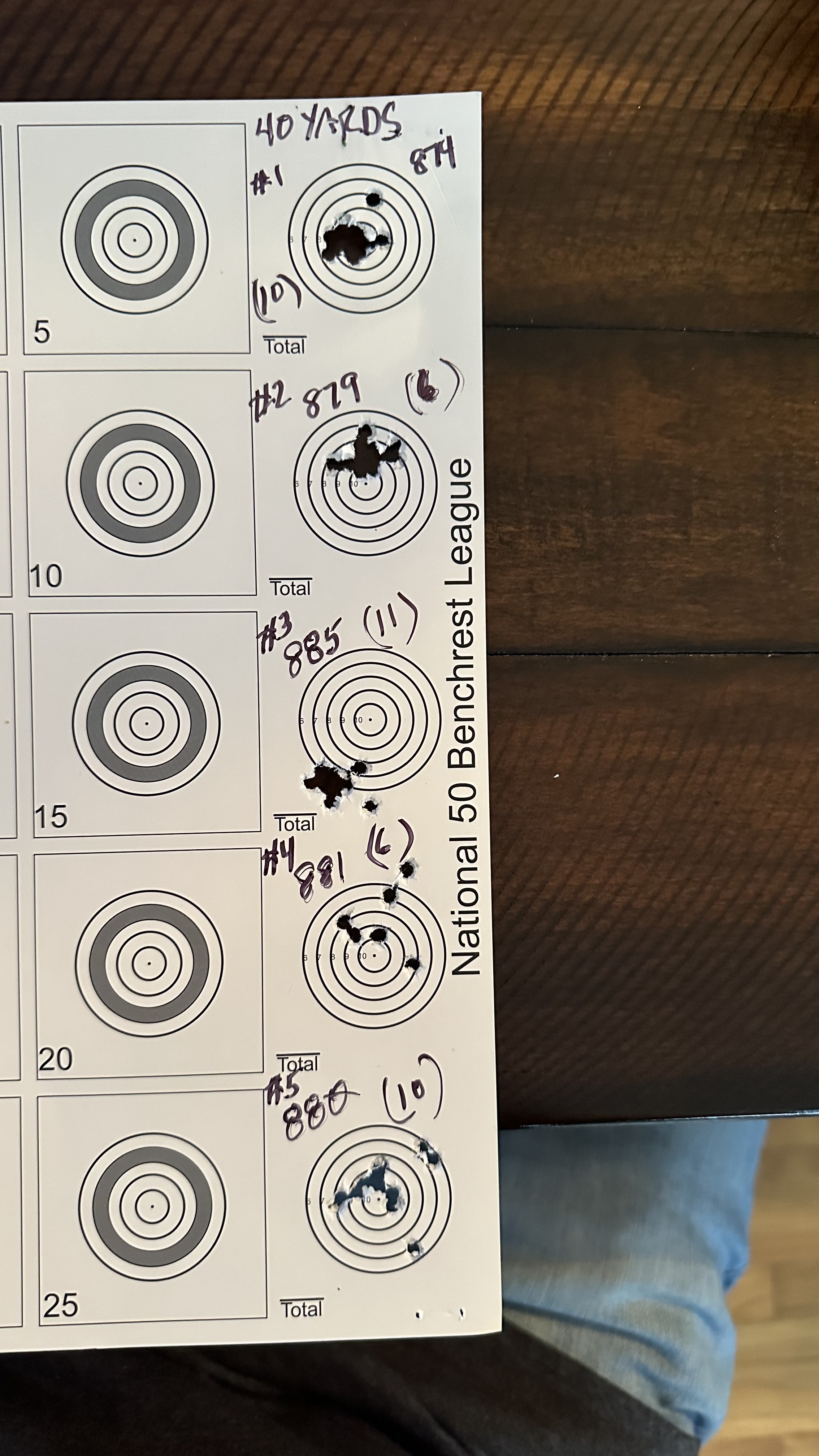

Since the RAW is currently shooting the 16.2g at 880 FPS, going to try loweringvelocity first with HST adjustment to see if I can get the 13.4 to group at 40y. I can lower the reg from the 145-150 BAR setting at a later point, but just want to try the 13.4g now.

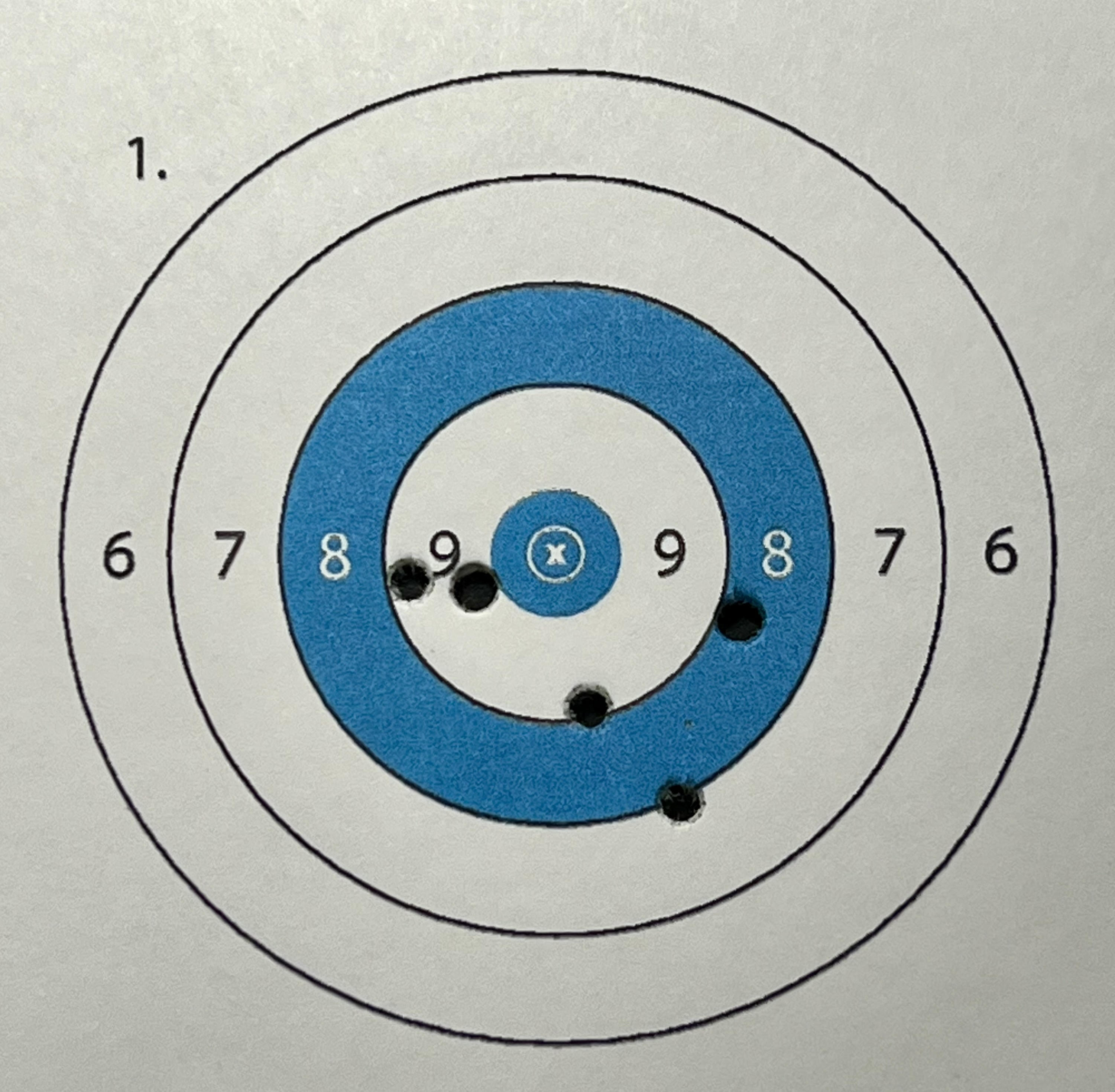

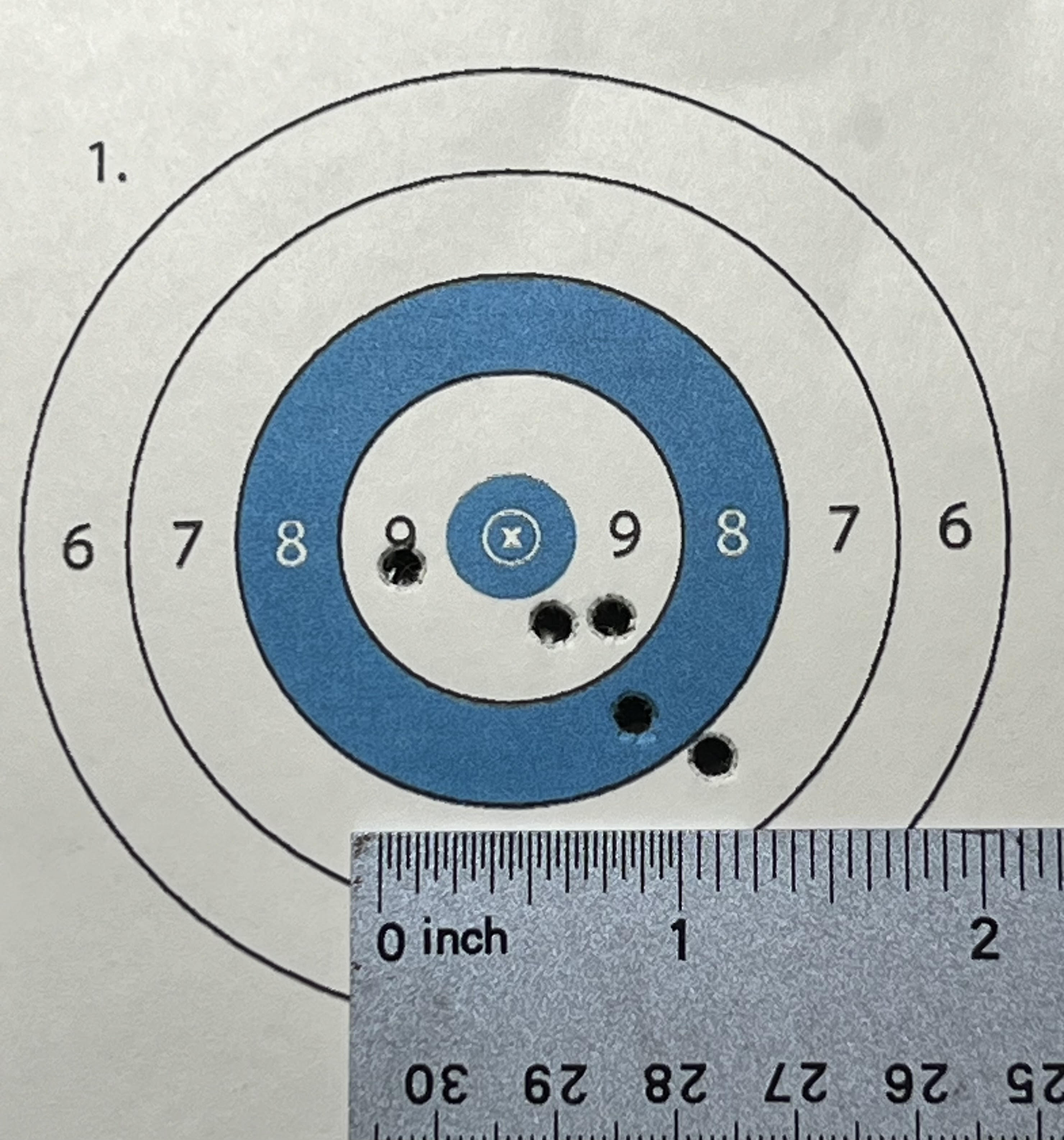

I sent the TM1000X .177 back to Martin to retune for the 13.4g JSB pellet. I gave the JSB 16.2g the good ole’ college try. No good for my extensive testing. Could not get acceptable RAW accuracy at 30 or 40y.

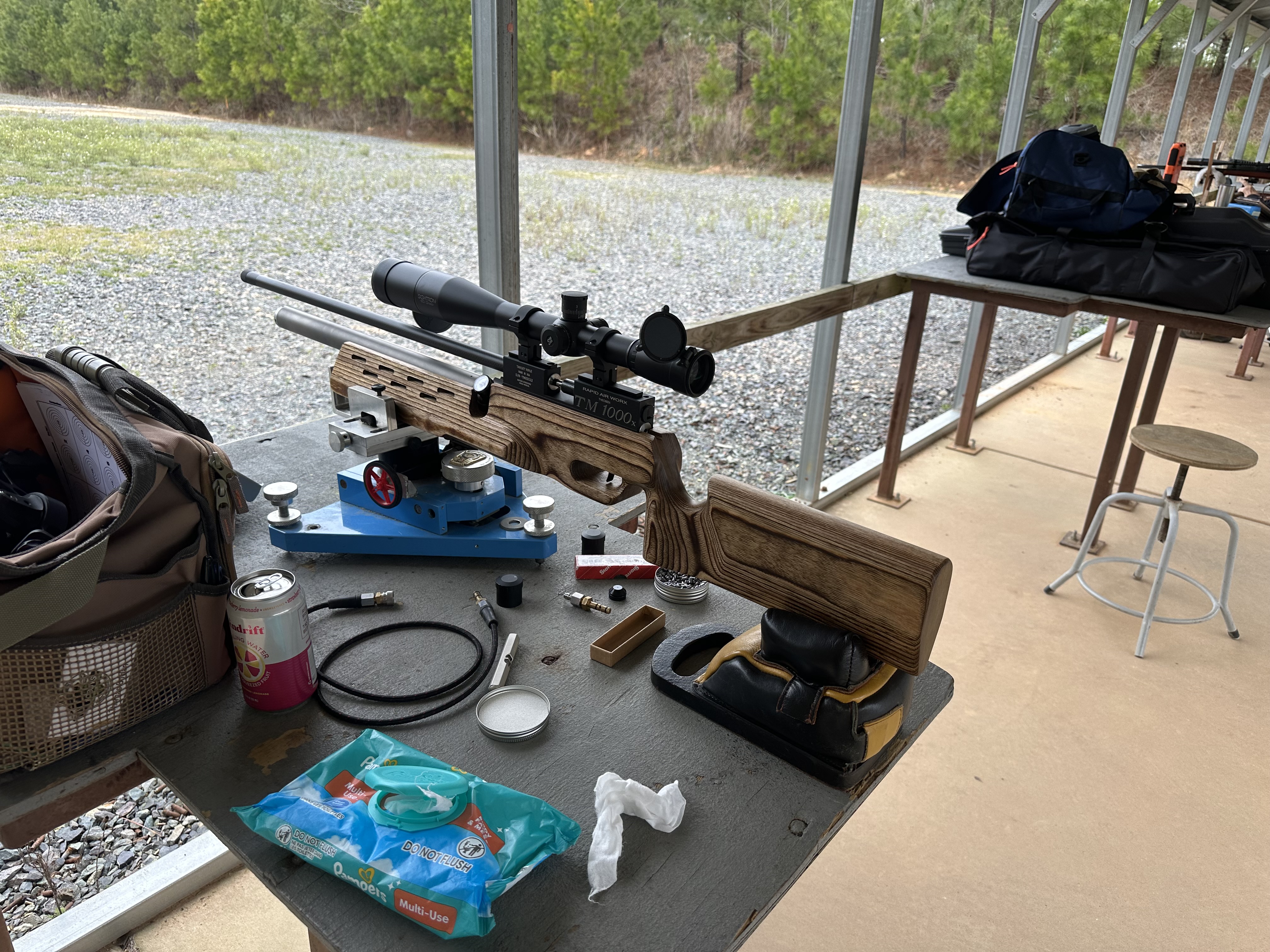

Some pics of my setup.

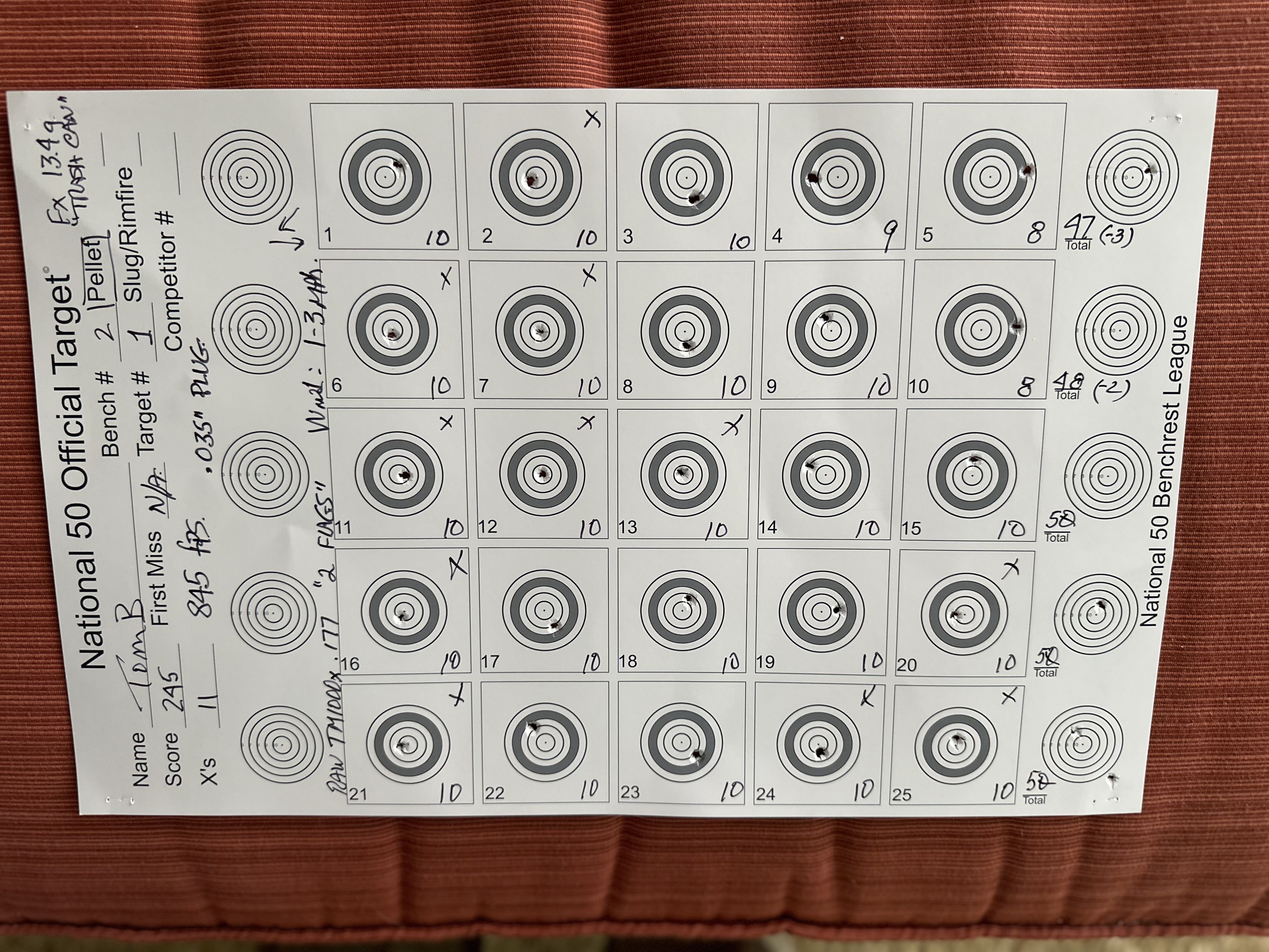

Tried the FX 13.4 'trash cans' at 50Y, light wind. First N50 card with this rifle. Would not even bother in any real wind.
Also got anew Impulse Air .22cal moderator.
Pellets flying at 850 FPS when I shot this card, but dialed it down to 810-815 FPS for 30 and 40Y challenge targets.

Thanks Thomas for the kind words.
The 13.4g is doing much better for me than the 16.2g, as others have experienced also. It will be interesting to see how it will do at 810-815 FPS for N50 cards. I think I got a lil’ lucky.
