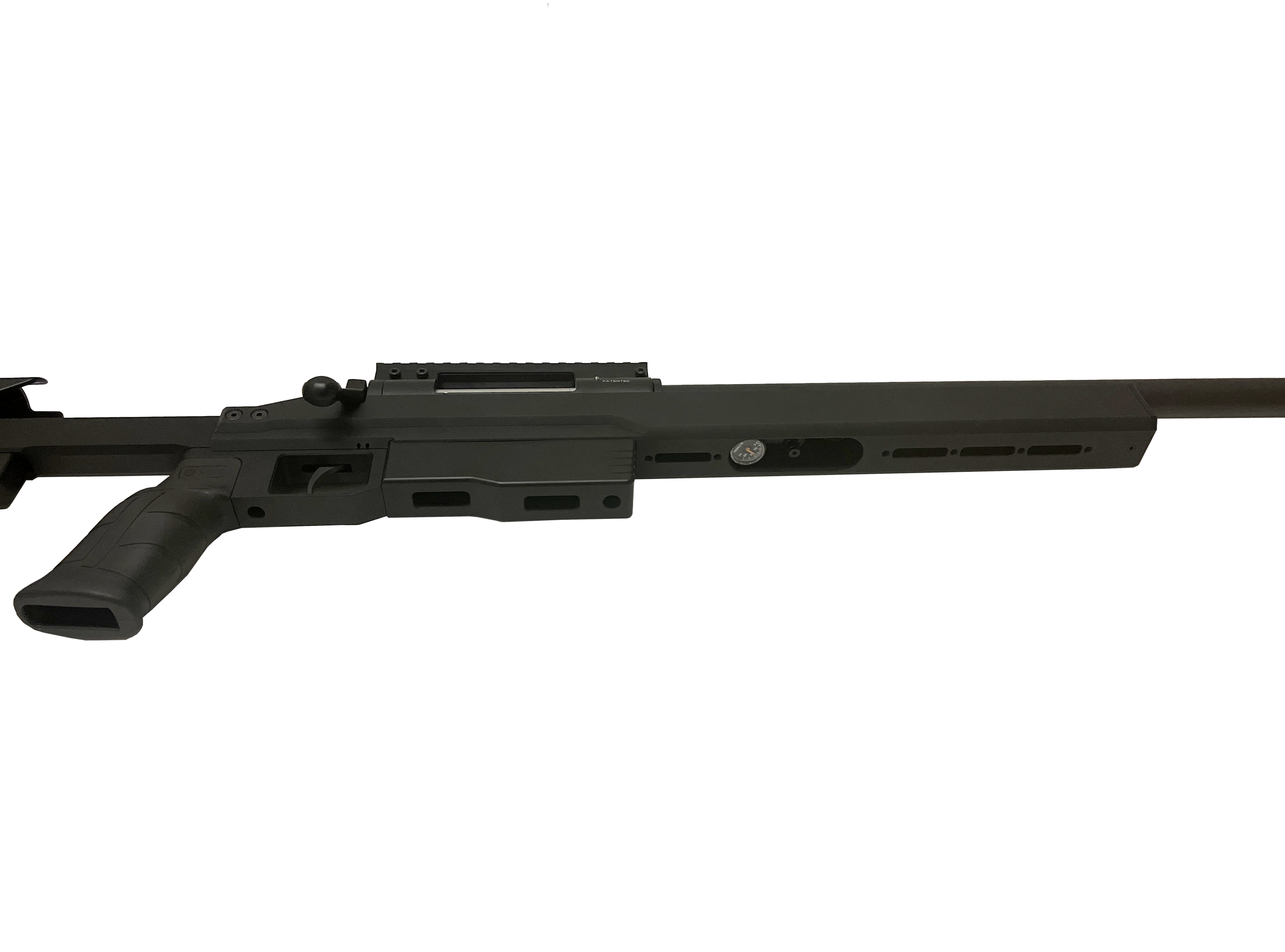

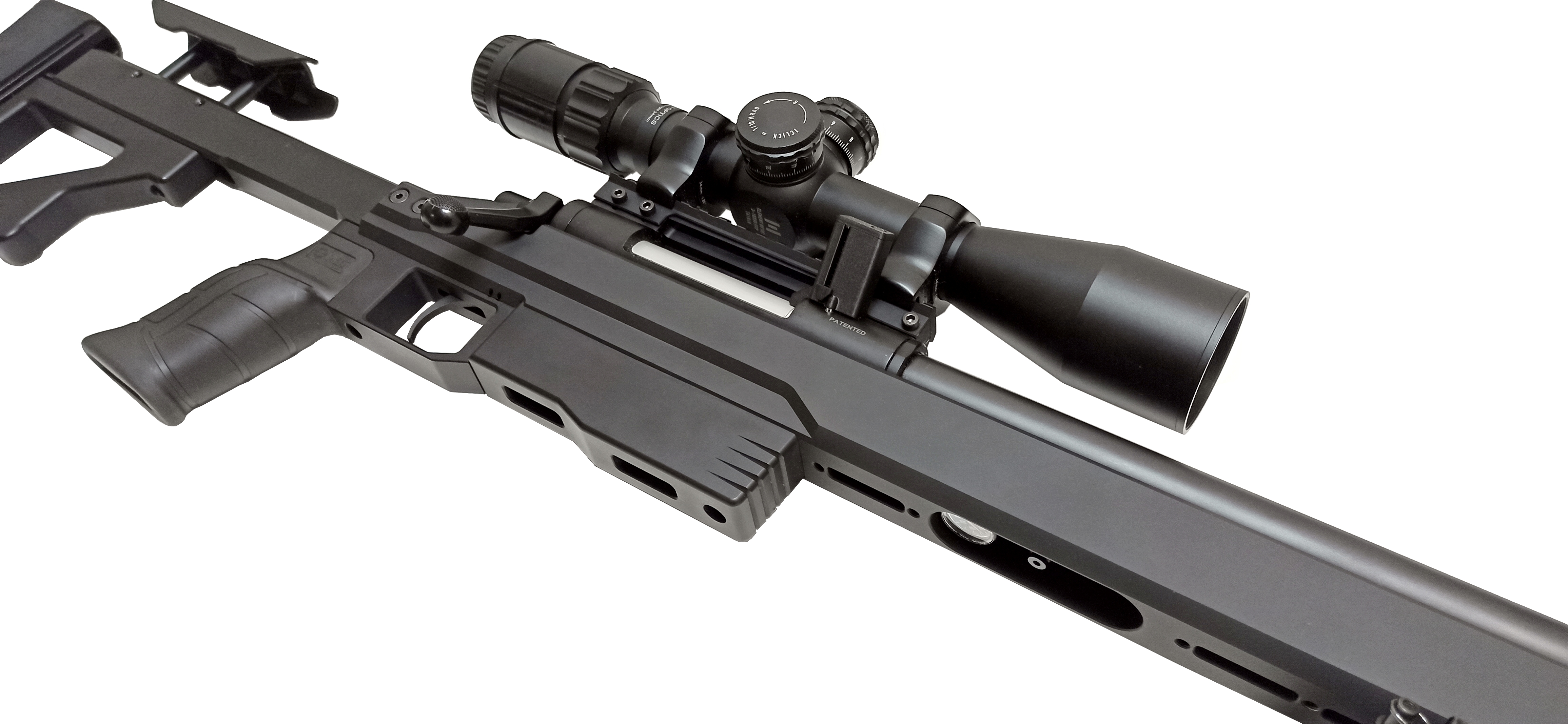

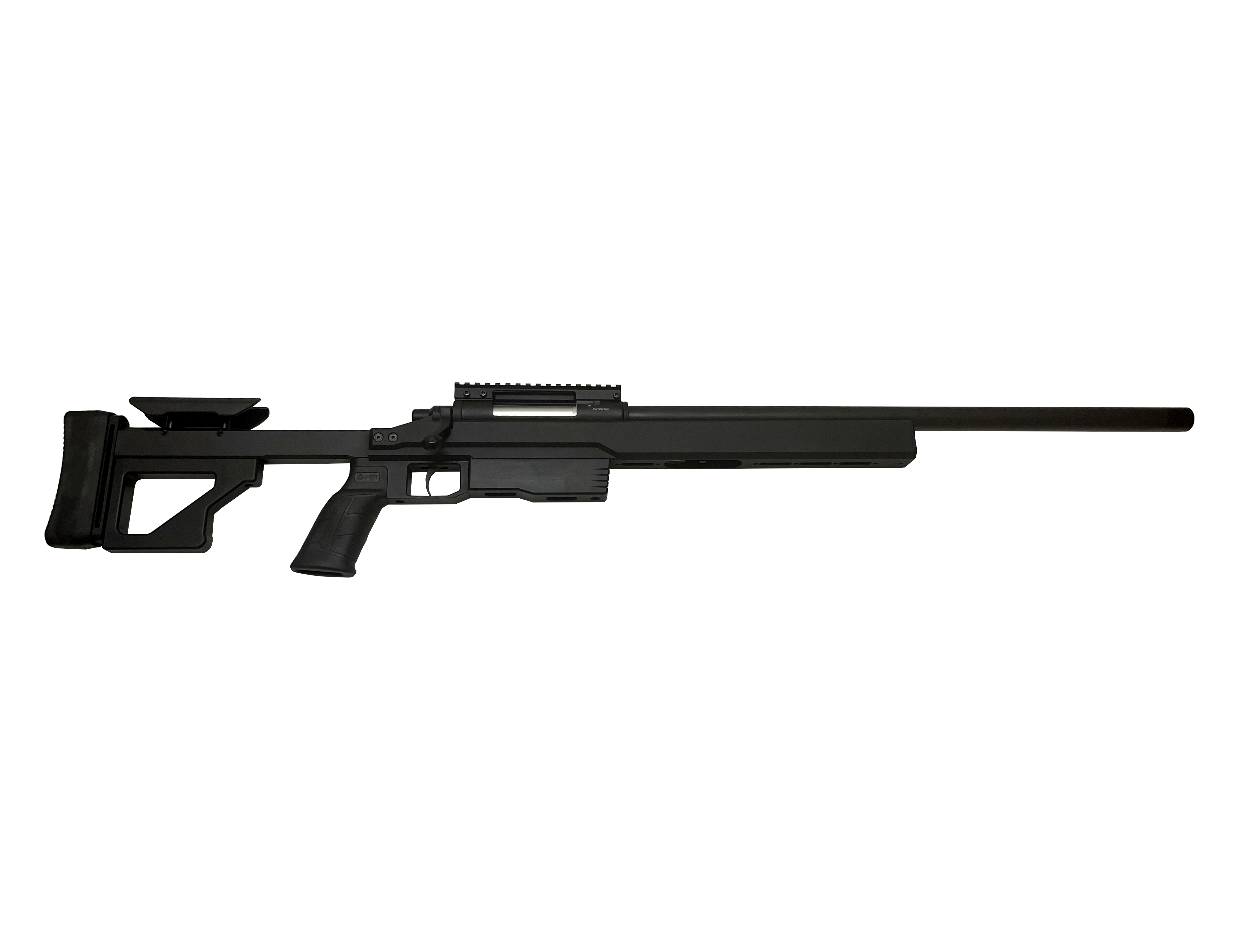

We would like to introduce a new model of our airgun Altaros M24 TCS
The Altaros M24 TCS is an upgraded version of the original Altaros M24 rifle where the plastic stock has been replaced with the new high-quality fully adjustable Altaros Tactical Chassis System.
This stock is made from high-grade aluminum, provides extreme rigidity and high shooting comfort which contributes to significantly better accuracy.
Altaros Tactical Chassis System can be easily installed as a replacement for the original plastic stock on your Altaros M24.

Great looking chassis.
Will the rifle work in any 700 style chassis?
Unfortunately no, if that were the case we wouldn't have developed a whole new aluminium stock. There are still many differences between M24 airgun and firearms, even though it may not look like it at first look.
