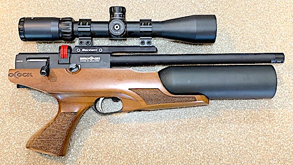

A quick examination of the potential victim confirmed it might be an excellent platform for butchery... Correction- conversion!
The work went well, the results are gratifying, and the pistol outshoots hell out of the rifle it used to be.:D
In rifle form she struggled to average 1" c-t-c five-shot groups at 50 yards, but the .177 Bantam pistol consistently averages .75" or less. In fact, she's already posted a couple 3/4" ten-shot groups at 50.(y)
Though I'd already monkeyed the trigger down to a nice 10 ounce let-off, I felt that was holding her back from being all the EFT pistol she could be. So diving back into the trigger design I've become quote familiar with, I clipped another coil off the tiny sear and trigger-return springs. BINGO! Now takes just 2 ounces to reach the second stage, that breaks like glass at 4 ounces (total)!🤯
The original 480 cc carbon bottle extends about 3/4" beyond the muzzle of the barely-legal 14-7/8" barrel, so I ordered a 300 cc alloy bottle just the right length. Even so, virtue of the magical Slingshot firing system she did this- 13.43 JSB Monster, 225 BAR fill, 135 shot powerband😲= Low- 783, Hi- 813, ES- 30, SD- 6, Avg- 796 FPS/18.9 FP.
About 500 shots later my moly-lube treatment is slickening quite nicely. She's come up to 815 FPS average, the SD down to 3-4. Still exploring the shot count at the higher power level, I expect it to come down to "only" 125 shots per charge.🤣

Oops, after more testing tonight I realize I lied in my original post. The 135 shot power-band came with the original 480 CC carbon bottle before the moly-lube treatment smoothed in. My bad!😔
In testing tonight with the 300 cc bottle and power now up to 810 FPS/19.6 FP she returned 85 shots from a 225 BAR fill. My apologies for the mix-up, but I'm still delighted with the shot-count and POWER.

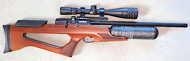

"I would question the 3" rule on depth of anything forward of trigger guard". Say WHAT?😲
Dang Scott, I totally spaced that out! But you're right, it ain't legal. Thanks for pointing that out, Bud. It would really suck to have that pointed out after I win the State Championships with it, and got disqualified... by ME!😰
Guess I was so preoccupied making the barrel 14.9998" and the power 19.99999997 foot pounds that I totally overlooked the fore-end rule😖. And I'm the Rules NAZI!
Looks like it's back to the ol' drawin'-board. Correction- the ol' band-saw, table sander, wood stain, and polyurethane. But the good news is it looks like there's enough meat there for the liposuction procedure.
But it'll leave a scar!🤕

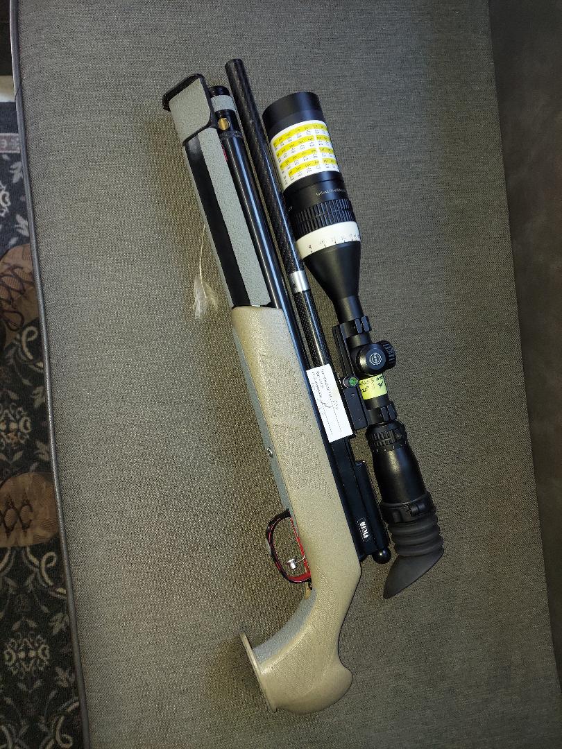

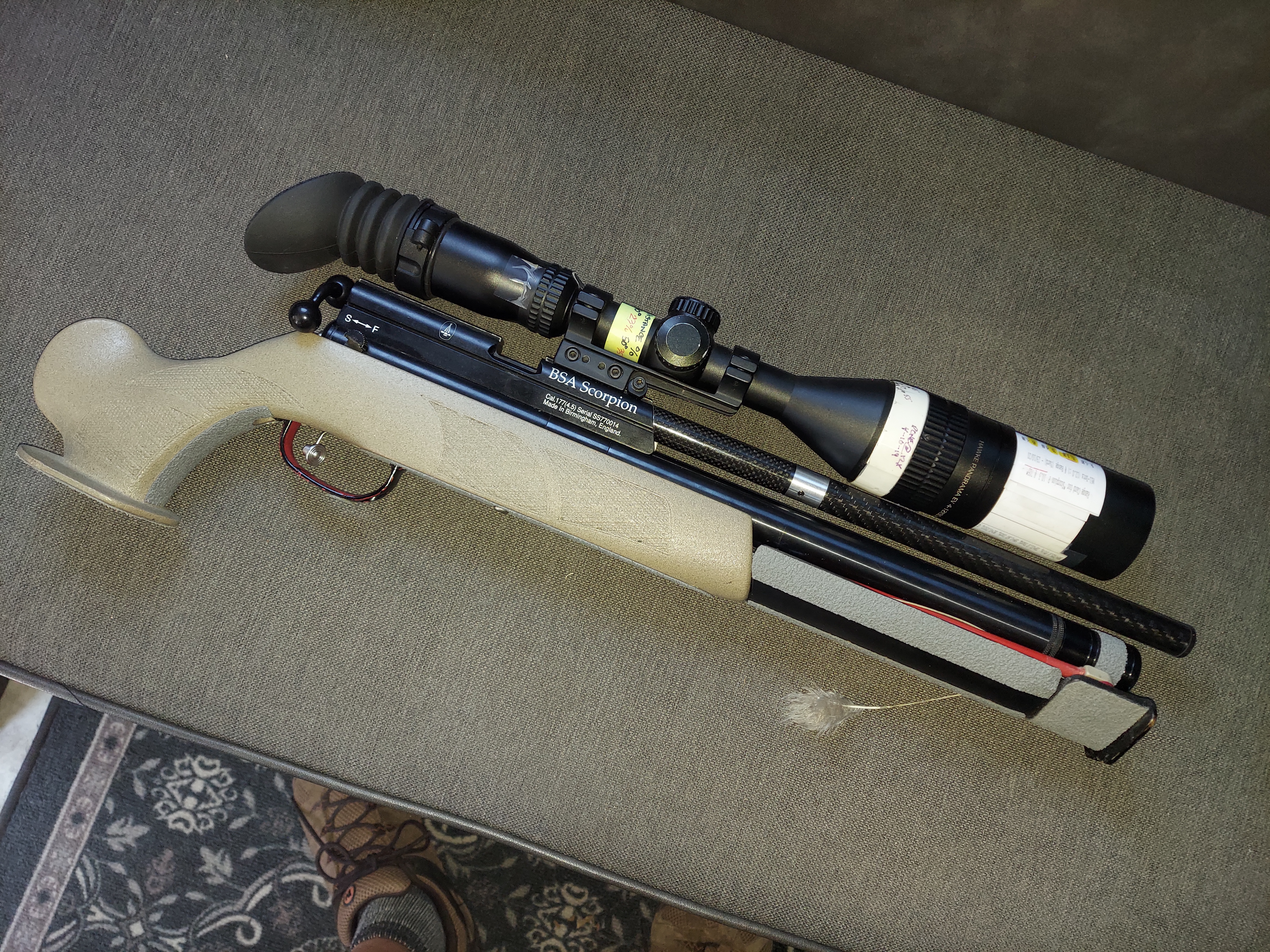

While on subject of chopping up perfectly good rifles to make one of a kind pistols
:unsure: Thought i would share my recent one spoken of above.
Original BSA single shot scorpion, Shorter gold star air tube, Huma regged, Light hammer & ssg etc ...
Wood stock chopped down, painted in Rustoleum textured beigh ... Shoots stellar.
Made up in 2018 & on its 5th season it has got me quite a few state championship wins so far ( Ca, Or, Nv )

Your Scorpistol is cool Scott🤙, and obviously gets the job done! Ain't it great when a plan comes together? Good show!
