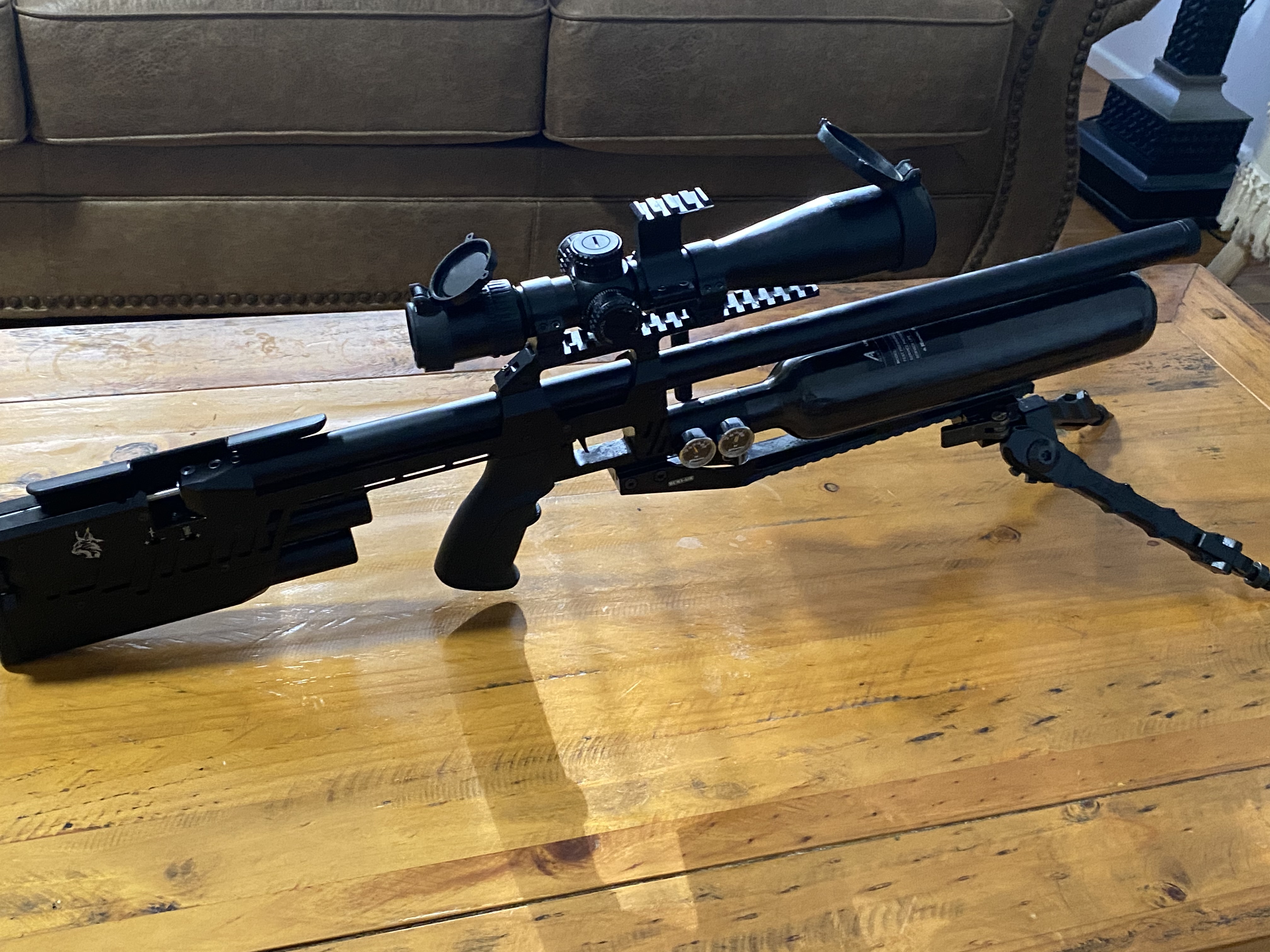

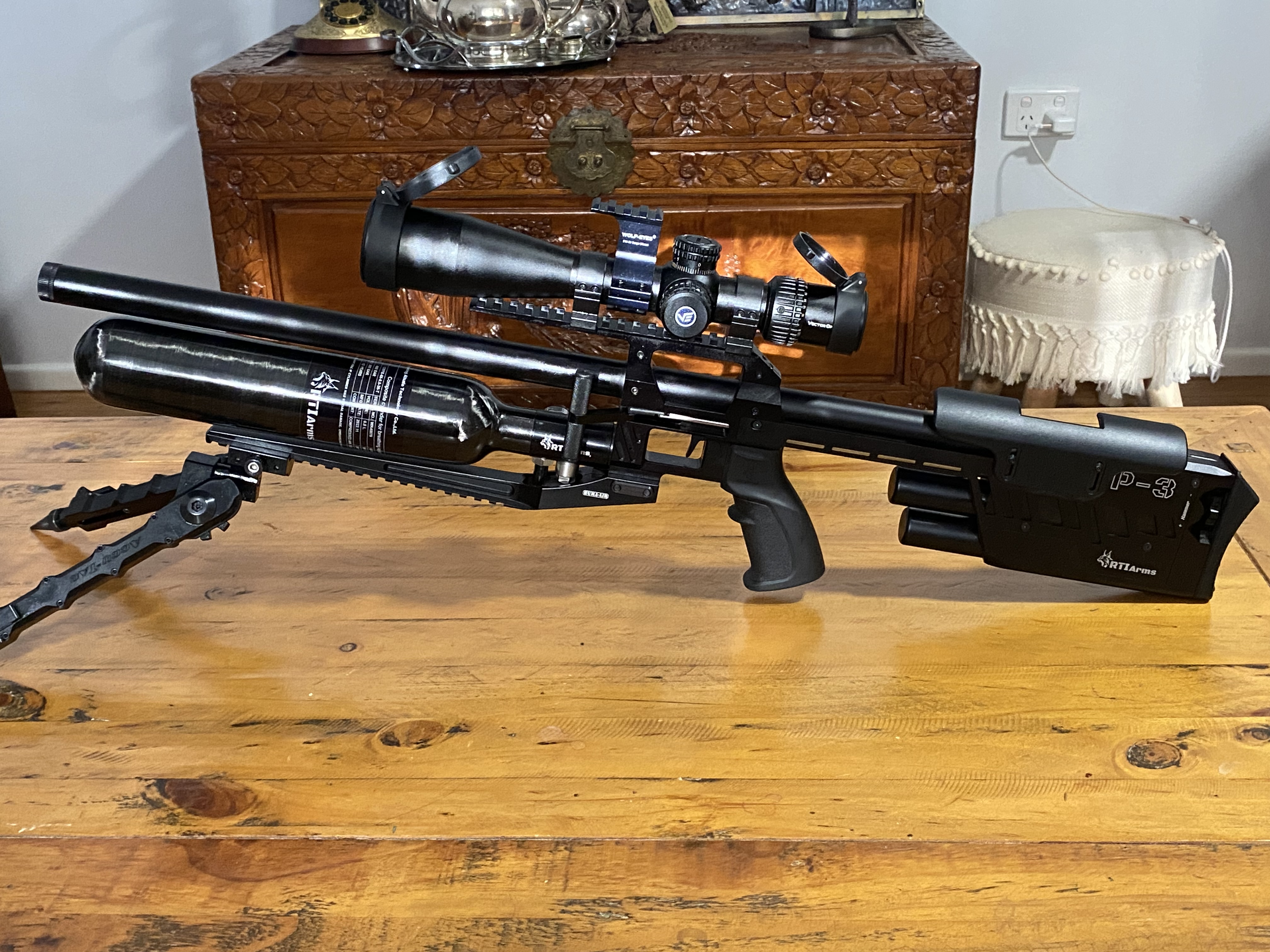

Hi just bought a new rifle .22 cal fitted a huma extended rail and 2 plenums can’t wait to shoot it Sunday. Does anyone have a good reg pressure for pellets and slugs?
Hi mate I’m planning on shooting around 40 to 50 metres because that’s all the range allows me to shoot. One thing I have noticed is how rigid the barrel is, there is no flex not like my fx impact m3. I’m definitely not a fan of the plastic dust cap I will end up changing that to an aftermarket dust cap soon. The overall appearance of the rifle is very nice it looks like it’s built like a tank seems like you could just throw it in the back of a Ute and it would still maintain POI. I love the simplicity of the rifle this is the way all rifles should be made in my opinion. I love the way you can degass the rifle just by turning a screw the external reg is a winner that’s for sure so easy to adjust. I have the .217 23 grain Zane slugs and the .217 fx 22 grain hybrids and the cometa 18.13 grain pellets which are the same as the Jsb except all the skirts are not bent. I will see if I can get my hands on the .216 Zane slugs. I’m taking it out on Sunday for its maiden shoot I’m hoping it likes the cometa 18.13 grains because I have a lot of tins, my fx impact m3 likes them anyway thanks for getting back to me have a great day.What distance are you planning on shooting?
