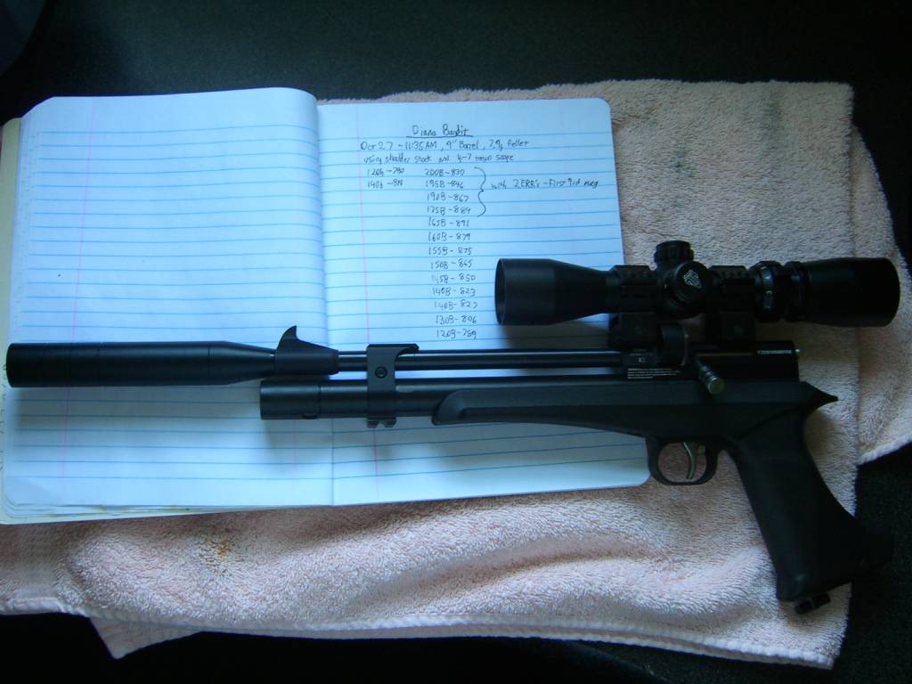

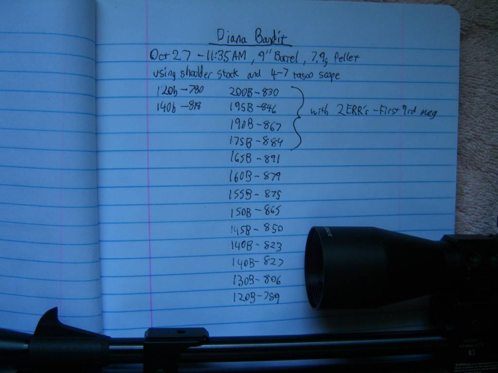

i did some chrony numbers (did those a few days back) and really been working out my 177 bandit lately and im pretty impressed with it .. decided to bite the expense bullet and scope it with an actual pistol scope to use it in a more permanet pistol role since my eyes dont work with open sights past about 20 yards .. so chose a budget utg 2-7 ..its fairly good id say with up to 4X best all around for unsupported field use and the higher power works fine for rested with slightly reduced eye relief distance .. the gun itself is mostly stock with only slight messaging of both ends of the barrel and alittle hammer ramp work to aid smooth cocking, and i put a chaser stock on it, like that better .. its dead accurate to 40 and to me personally that means 'the gun' can hit a 1 1/2" square of aluminum every time to that distance ..further and it gets dicey with wind and progressively more compensating needed .. by 80 its falling way off .. 55 is dooable and alittle challenging so i hung a can full of metal lids so it had alittle weight to it in a tree at 55, which took a prompt beating from the little guy .. so yeah i was so happy with the setup i ordered it a hard case today lol ..
