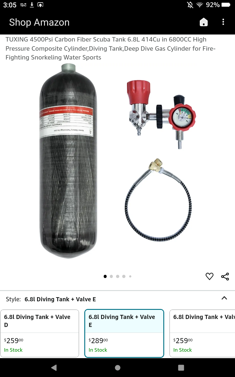

I've got a small compressor to fill my guns. Looking for something to take to range. Realize I would have to have this filled at a dive shop. Would this be a decent tank for my needs? Thanks!
So basically the new one on ebay has not had a hydro test?If you are looking to have any cylinder filled at any commercial place you will need to have a DOT certified tank that has a current and valid hydro test on it. You will need something like this.

If the tank is new then it has been tested when manufactured.What I ment to say is the one from amazon has not been hydro tested?

It's got 5 years from date of manufacture before HT is required.What I ment to say is the one from amazon has not been hydro tested?
The one you linked from amazon is not DOT certified and will not be able to be filled at any commercial site.What I ment to say is the one from amazon has not been hydro tested?
