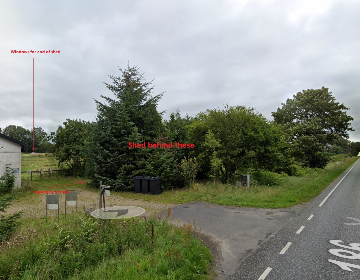

Behind the shed ( south ) and to the east of it, the growth of various things are very thick so i dont think someone will come thru there, they also fists have to go past the property " fence / line "
For sure we will have to be mindful of safety, also in spite of the many trespassers will be shot signs and the dog can reach this fence in x seconds how fast are you sign.
Safety and a good time in paramount.

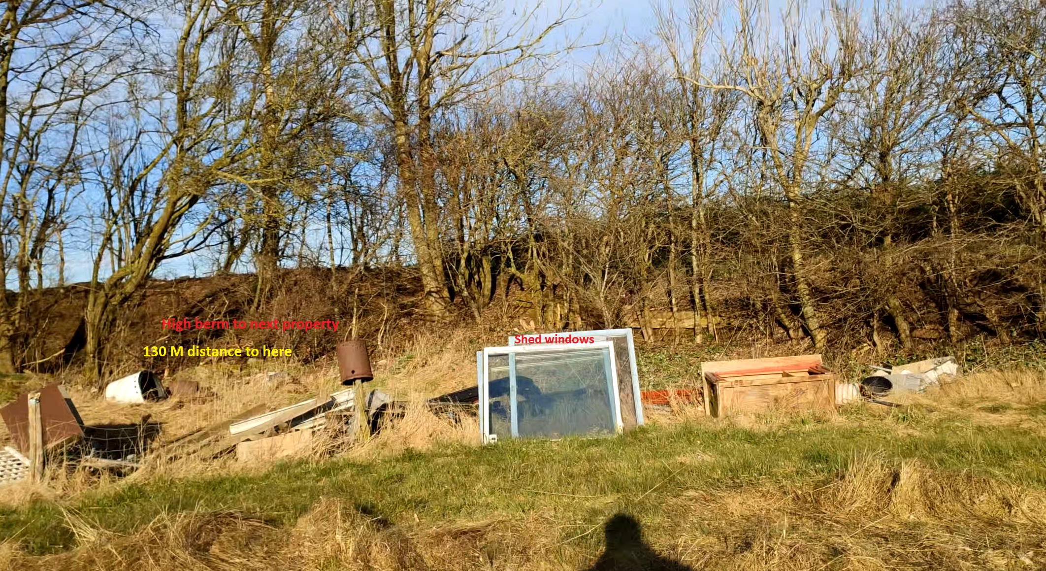

This is the far corner, at 130 M distance, its here i have shot to for the past years from the old shed.
7 - 8 feet high berm in the back up to the next field, and way back past it there are houses, just not really at this angle.
I feel safe / OK shooting to here, pellet traps will also come as i dislike burying lead in the berm.
Windows for end of shed can be seen, good size will let in lots of light, and of course dual layer as that's a thing in Denmark for decades.
Previous owners of farm ditched a lot of BS here.

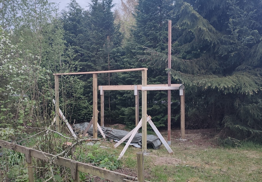

Remembered to snap a picture of the shed project last night before it became too dark.
Not much to see ATM but things will take more form soon, should get most of the framing done this Tuesday, and then its just a matter of slamming on a roof and walls.
We cut down the size a little so now the outside measurements are 4 X 2.5 M or 13 X 8.2 feet for those that still use their former rulers antiquated system of measure.

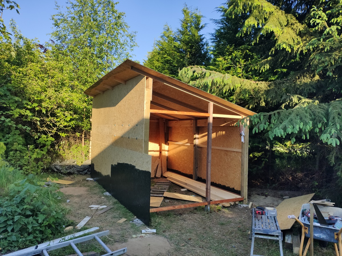

Okay back from a couple of days of dispensing lead with my Maverick, and then shed building too.
Mind you my friend is in a bad place ATM with his arthritis, so its pretty much me wrestling things alone, and i have also taken a hit, starting with a fall from a ladder, fortunately from a low height.
Still things move along nicely, though i have also gotten a curb ball from my little sister, so now aside for hanging her lights and what not in the windows, well i am also roped in as driver of the moving van, but i dont think i am supposed to help lift stuff, that would also be a disappointment CUZ there are good reasons i have been on early retirement for 9 years soon. this V8 is at best firing on 5 of the cylinders.

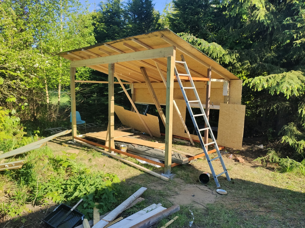

Snapped this pic before i left for home today.
My M8 will 2 coat some parts, and 1-2 coat other so come Tuesday i can hang more siding that was test fitted today ASO.
I did the roof 2 coats today,,,,, and i am the heavy one of us, my M8 are just 90 Kg,,,,, i am 120 KG
Also ready to bang the window in the far end wall, the frame on it is pretty rotten, so while it can go up, well i will have to do something about it next year.
What i dread the most is the couple of tonnes gravel we will need to get into the shed to put concrete pavement stones on top of, while all the gravel we need is on my friends property, well i still have to shovel it onto a trailer and transport it the 100 yards or so to the shed, then dump it there and level it later on.

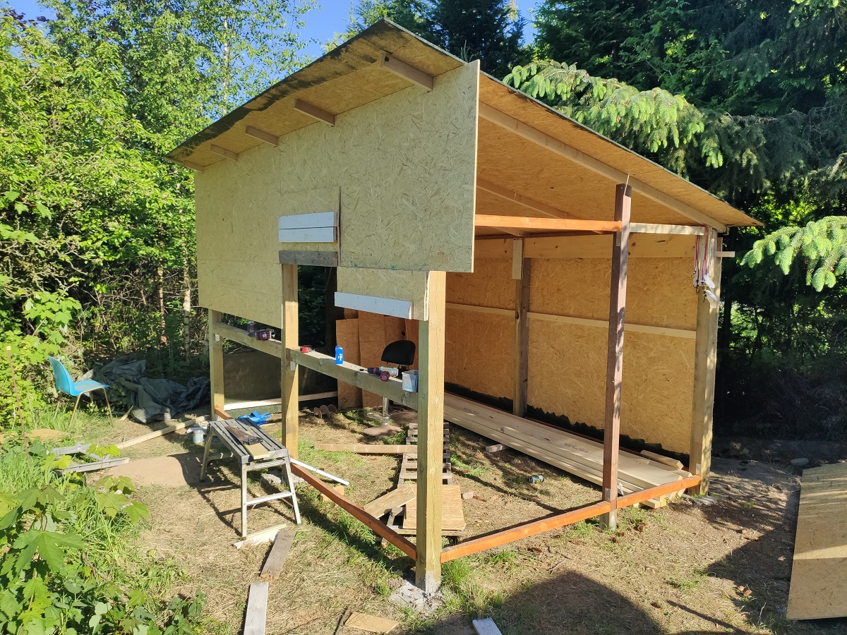

So the entry end ( to the right in pic ) well that will be done last so we can reverse the ATV and trailer in there and dump the gravel, CUZ i aint shoveling it 2 times, my back do NOT like that kind of work.

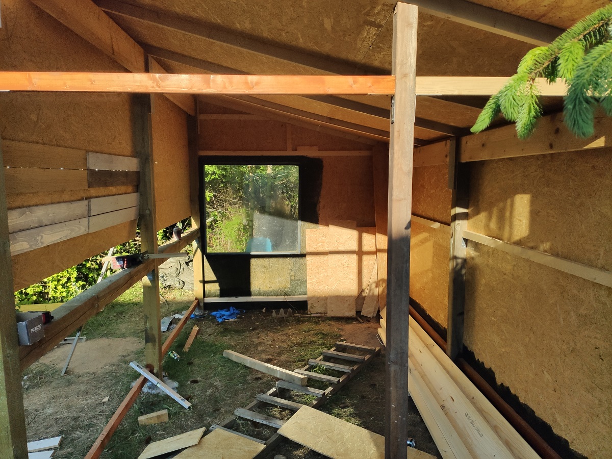

Okay the carpretender have been at work again, 3 sides are now almost done ( cant close the 4 side as we need access to dump gravel inside the shed to level out preparing for paving.
Got the shudders for lane #1 and lane #2 going, but no pulley mechanism installed yet, this is going to be very K.I.S.S of course.
Also did some old lumber recycling.
And the window in the far end is also installed in the partially rotten frame, will probably have to liberate the 2 layer glass next year.
Aint going nowhere though, not even when Danish winter storms come rolling in.
Lane #1 50 % open in PIC, this is fine for sitting at the bench that will be level with the heavy horisontal beam in the front.
Lane #2 100 % open, this way you should be able to stand in the shed and shoot rifle or pistol off hand if you like.
Mind you while there are sort of 4 lanes getting made this is too crowded, 3 shooters will be just fine though the middle one will have to deal with the upright post there, benches should become slide able L or R so should not be a problem.
I have sort of reserved the far end spot for myself as i am a rightie, so only need to slide a little left to be able to shoot to the far corner of the field ( 130 M distance )
Down there is probably where the stove will be put up.
The front face done, though surplus wood not yet trimmed in this pic, forgot to snap new ones before i left for home.
Pic of a very dirty dual pane window installed in the far end wall.
The Journey continue next Tuesday.
Putting on the waterproofing on the roof ( heavy duty armoured tarp )
Painting more of the walls outside.
Additional bracing to be put inside on the walls.
The shed will NOT be done June 1, but that is only due to the tonnes of sand that need to be moved into the shed and leveled off in there.
We are both decrepit old guys, my M8 especially with his arthrithis, so while we have a ATV and a trailer with a dump feature, well it is also entailing a lot of shoveling, and none of us feel like doing that a whole day, or several days in a row.
So we will shoot a little in the old shed, and then take a break and do a load of gravvel now and then.
July 4 it should be operational, and we could have our first July 4 shoot a palooza, the old boys might get a bit tipsy due to out of schedule alcohol consumption.
